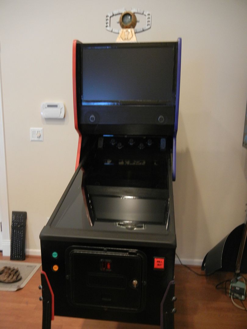

viriiguy Posted May 2, 2013 Author Posted May 2, 2013 Well, I decided to order Zebulon's big easy boards. As I understand, he is waiting on some parts, but hopes to have them soon. Once I get it, I get the cabinet finished. I have a new LEDWiz coming and am going to move a few items around inside the cabinet, since I will no longer have to have my multiple power supplies and such in there. I will be starting the tear down this week. I will take some before pics and then eventually some after pictures too Eventually I will have this all finished and working...... I have a local friend who I am helping to build his cabinet and a gentleman I work with is considering having me build one for him. He however, does not want force feedback atm.. Just to be able to play some tables on the cheap. Here are a few higher resolution pics of the cab thus far....
scottpe Posted May 2, 2013 Posted May 2, 2013 Glad to hear it will be coming back to life soon. Artwork looks good. Looks like you had plenty of space to make it bigger/taller if you wanted.
viriiguy Posted May 2, 2013 Author Posted May 2, 2013 Glad to hear it will be coming back to life soon.Artwork looks good. Looks like you had plenty of space to make it bigger/taller if you wanted. Thanks! And yea, the ceiling in our Greatroom is about 23 foot at the highest point
scottpe Posted May 3, 2013 Posted May 3, 2013 Thanks! And yea, the ceiling in our Greatroom is about 23 foot at the highest point Sorry, I wasn't clear with my statement. I meant it looks like you had plenty of room to make your artwork bigger and fill up more of the blank space if you wanted. Hindsight is always 20/20 though... Regardless, it looks great! Thumbs up on the high ceilings too!
viriiguy Posted May 3, 2013 Author Posted May 3, 2013 Ohhhhh.. I gotcha Yea, we could have made it a bit bigger, but this falls more in line with how the real P2K's artwork was done. And, nothing gets covered by the legs, head or buttons.

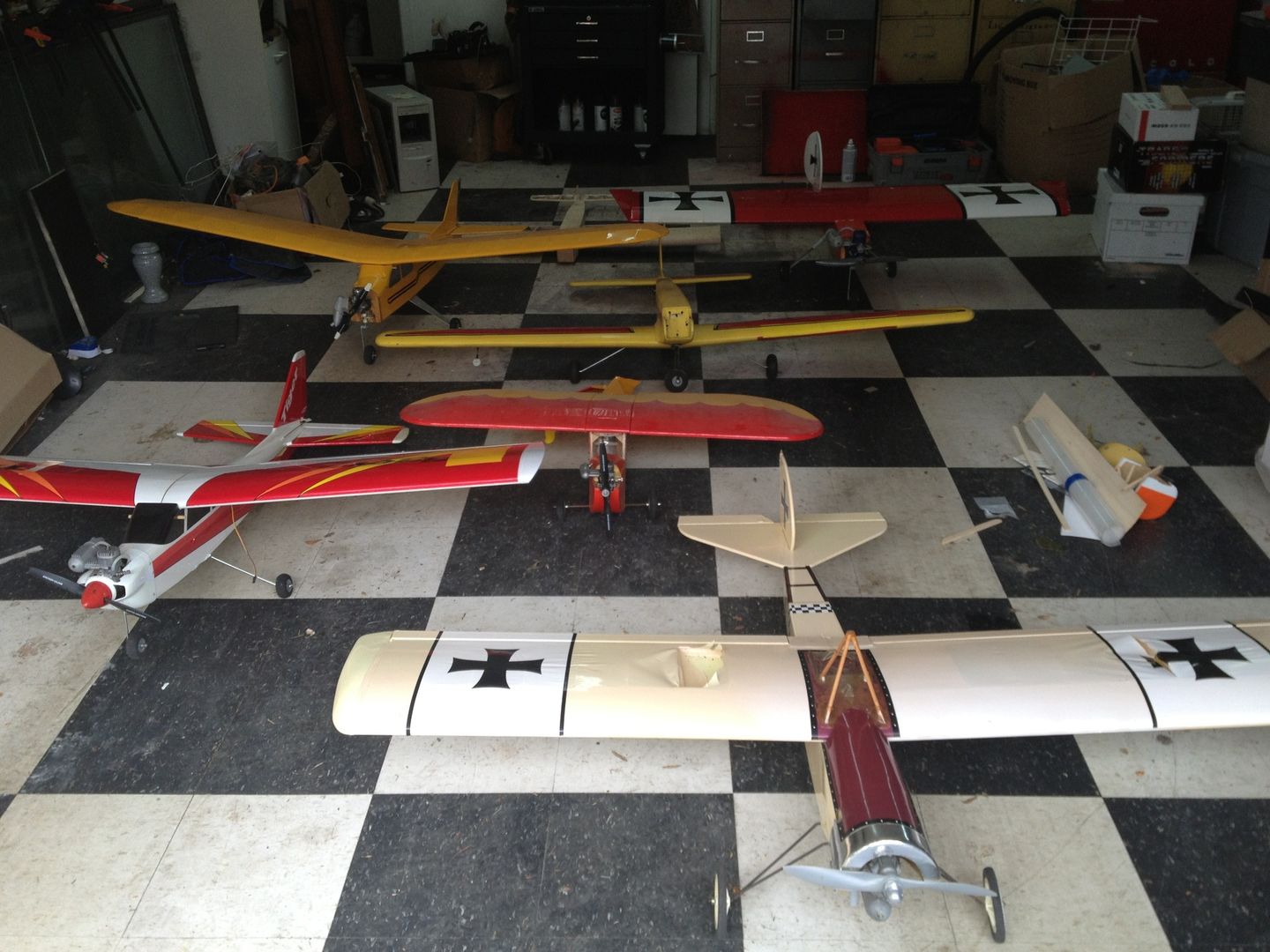

viriiguy Posted May 7, 2013 Author Posted May 7, 2013 Completely off topic, but because I don't have enough hobbies.... I picked these up today.. I traded an Asus Transformer TF101 Tablet for the whole lot...
scottpe Posted May 7, 2013 Posted May 7, 2013 Nice! That's one of my many hobbies as well. Did they come with the radio gear?
viriiguy Posted May 7, 2013 Author Posted May 7, 2013 Yea, three of the planes have all the servos and RX's etc etc in them. And I got a Futuba T6XA S controller with them. The Big Stick, the Red Baron looking plane will be flyable by this weekend. It just has a small hole to patch. The others will require more work. The Tiger Trainer, which I had hoped to repair first, is eat up with Black Mold. So I will probably gut the electronics and motor from it and put them in the Yellow and Red one. I was told it is the most fun one to fly.
