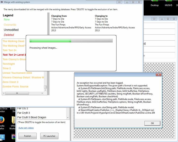

drifftr6x Posted March 10, 2015 Posted March 10, 2015 Im getting errors too. Im able to create a few wheel images before it errors out. Here's a screenshot . Awesome app before the errors. thanks

pietie Posted May 19, 2015 Author Posted May 19, 2015 This is the stupid error I get when clicking on complete after clicking on process. http://pastebin.com/RGV9H0qq 44526.attach Pretty much all I get saddly Can you both please send me your project xml files? My tools Steam wheel creator - Generate xml list from Steam profile with artwork and videos HyperSearch - Integrates search functionality with HyperSpin
pietie Posted May 19, 2015 Author Posted May 19, 2015 Im getting errors too. Im able to create a few wheel images before it errors out. Here's a screenshot46777.attach . Awesome app before the errors. thanks Hi Can you send me your log please? My tools Steam wheel creator - Generate xml list from Steam profile with artwork and videos HyperSearch - Integrates search functionality with HyperSpin

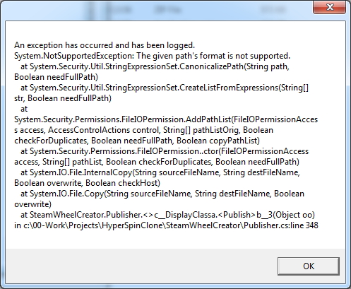

silverfox0786 Posted July 15, 2015 Posted July 15, 2015 can anyone help clear this error please ____________________2015-07-15 23:46:30¯¯¯¯¯¯¯¯¯¯¯¯¯¯¯¯¯¯¯¯System.NotSupportedException: The given path's format is not supported. at System.IO.FileStream.Init(String path, FileMode mode, FileAccess access, Int32 rights, Boolean useRights, FileShare share, Int32 bufferSize, FileOptions options, SECURITY_ATTRIBUTES secAttrs, String msgPath, Boolean bFromProxy, Boolean useLongPath, Boolean checkHost) at System.IO.FileStream..ctor(String path, FileMode mode, FileAccess access, FileShare share, Int32 bufferSize, FileOptions options, String msgPath, Boolean bFromProxy) at System.IO.FileStream..ctor(String path, FileMode mode) at SteamWheelCreator.Publisher.<>c__DisplayClassa.<Publish>b__3(Object oo) in c:\00-Work\Projects\HyperSpinClone\SteamWheelCreator\Publisher.cs:line 204
