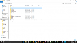

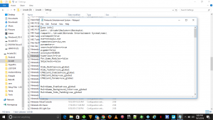

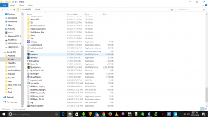

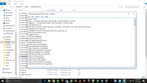

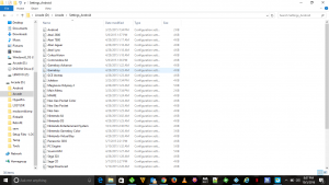

sandog Posted October 6, 2016 Posted October 6, 2016 I have a 5tb seagate that everything is loaded on. please look at my pics showing my setup
thatman84 Posted October 6, 2016 Posted October 6, 2016 I don't have a great deal of experience outside of my own setup. Is this one you have built yourself or accuired? I'm assuming you are plugging this drive directly into your shield? (Strange because I thought Hyperspin android would only find a Hyperspin folder but yours is called Arcade! Anyway you say it's working) I think your rompath should have / instread of \ Try changing one of your Settings_Android ini's to match Like this Arcade/Nintendo Entertainment System/roms Just focus on one system make sure your roms for Nes are not zipped. Should be .nes Also I have seen full rompaths used with external drives(I don't use one) Look in Es file explorer for the ID of your drive your rompath will be something like this if so Storage/hsbdboajbev8263617/Arcade/Nintendo Entertainment System/roms Please report back its good to know what does and doesn't work. Hyperspin 2.0 Latest Download Hyperspin 2.0 Documentation -------Pre Hyperspin 2.0 Below---------- HS Android Overview & Install HS Android Base Pack Download My Tutorials
sandog Posted October 6, 2016 Posted October 6, 2016 how does the path start off when using a ext hdd on the sheild? /storage/sdcard0/? /storage/usb/? or something
thatman84 Posted October 6, 2016 Posted October 6, 2016 If it can see your roms within your Hyperspin folder then should Have no start. Just the 1st folder that's in Hyperspin folder. (No dots, no slashes) In your case Nintendo Entertainment System/roms After that use Es file explorer to look in you shield folders for the Storage folder In there will be your storage folders. Or if you have retroarch installed I used it to browse to my roms and it displayed the full path to my roms as it went. I have a shield pro and roms are on the internal drive. My path is Storage/emulated/0/ROMs/Nintendo Entertainment System I have not tested any others but as I say yours may come up with a long ID number. Have a browse through the forum again there are plenty of real life examples in the threads. Probably this thread also Hyperspin 2.0 Latest Download Hyperspin 2.0 Documentation -------Pre Hyperspin 2.0 Below---------- HS Android Overview & Install HS Android Base Pack Download My Tutorials
