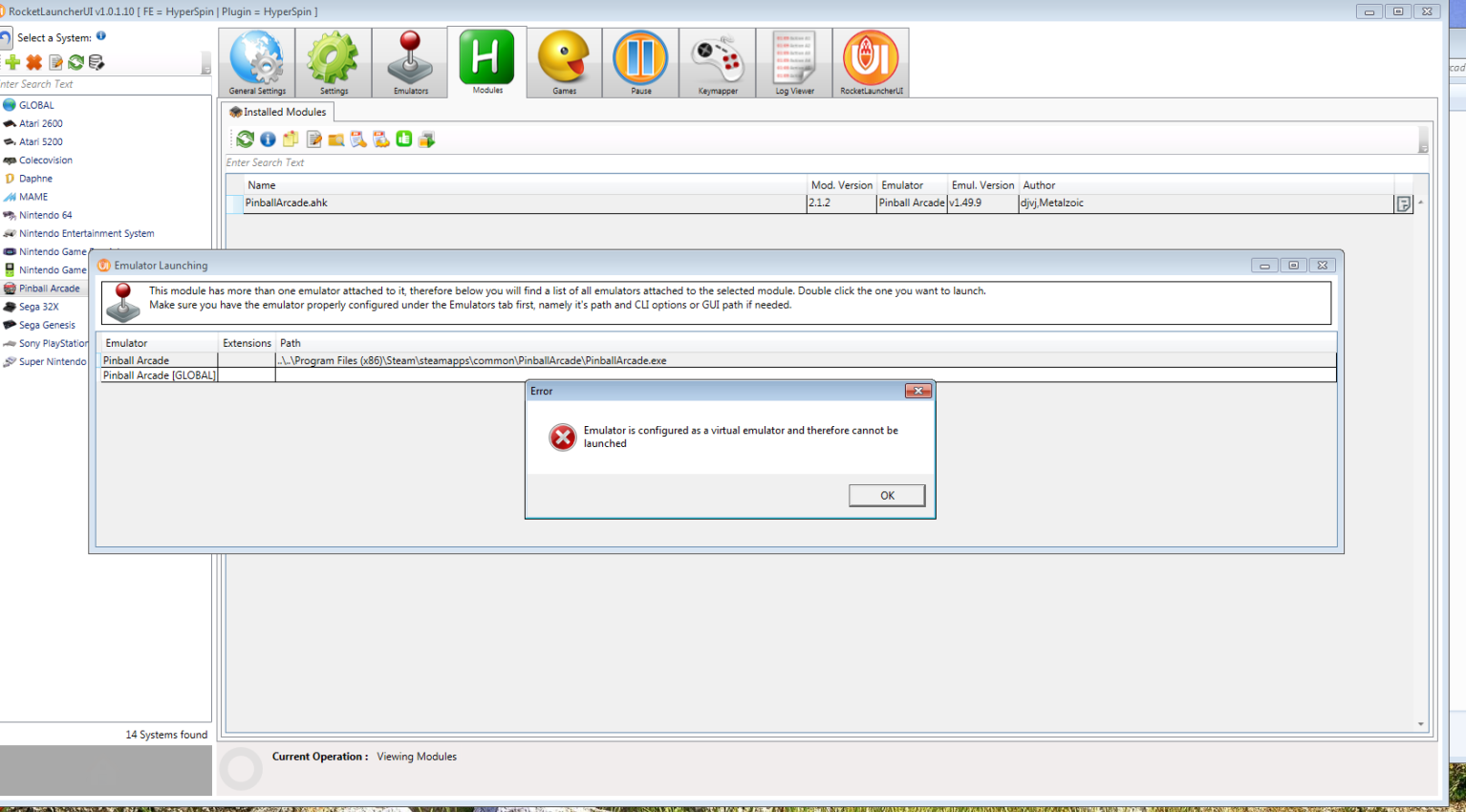

dugan26 Posted March 3, 2018 Posted March 3, 2018 HI - Thank you for the detailed tutorial. I ran through it. Everything seems to installed correctly. I have not errors or exclamation points anywhere but when i launch Pinball Arcade under the module tab I get this error: Emulator is configured as a virtual emulator and therefore it cannot be launched. The crazy part is i just had this working! Well, i had pinball machine load up through RL. Then when i started to get the Hyperspin part working i got a lot of different errors. So like a dope, i deleted to try again ... since then, im stuck here. Any help would be greatly appreciated. Im new to this pinball stuff BUT MAN is this insane!!!! this is ridiculous eye candy in the living room! Many thanks in advance - going to keep trying here ....
Metalzoic Posted March 18, 2018 Author Posted March 18, 2018 So you're running the Steam version and you're back on version 1.50.10? Not a newer one correct? And you followed Step #3 in the first post? What happens if you uncheck virtual emulator?
dugan26 Posted March 24, 2018 Posted March 24, 2018 Hey I got this to work with some help from the Rocket Launcher folks ... its actually quite simple ... i was over complicating things. If anyone is looking to getting Pinball FX3 with Steam support up and running - here is the thread. http://www.rlauncher.com/forum/showthread.php?5036-Pinball-fx3-module-request Is there anywhere i can get wheel art Pinball FX3 for the hyperspin wheel?
Metalzoic Posted March 24, 2018 Author Posted March 24, 2018 22 hours ago, dugan26 said: Hey I got this to work with some help from the Rocket Launcher folks ... its actually quite simple ... i was over complicating things. What was the issue?
