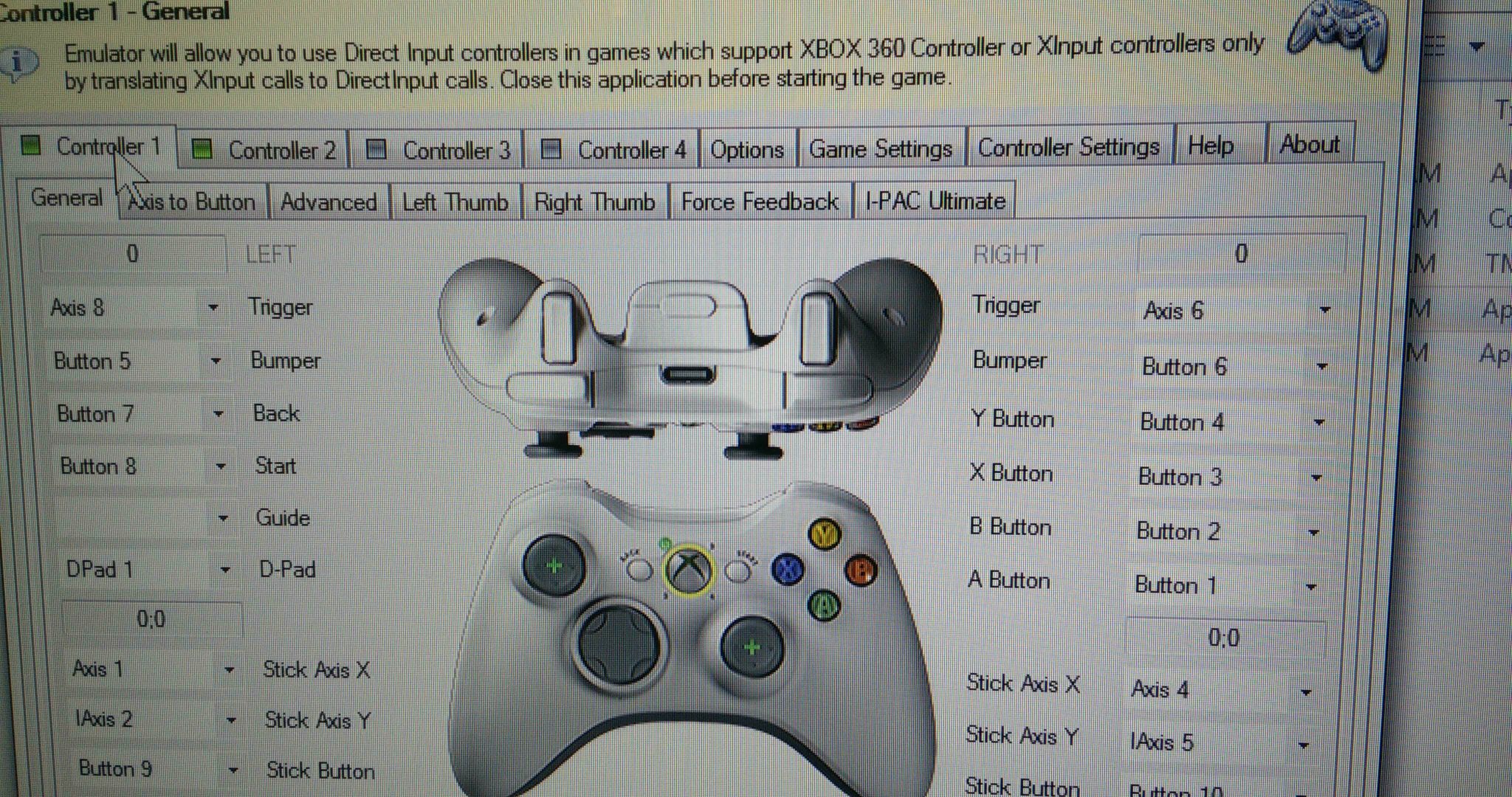

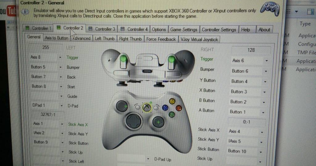

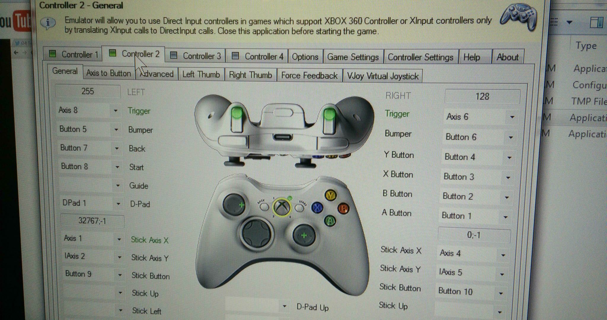

shitoken Posted March 8, 2017 Posted March 8, 2017 Hi friends, I am using vjoy and x360emu only last step with mapping I am having issue.When I try to set the keys in P1 by x360 please take alook at below 1st photo it shows ipac ultimate , not vjoy so I cannot map the keys here.But P2 as per below it shows vjoy stick and I can map the keys.Why P1 is showing ipac , I did tried to set incontrol setting of x360 to vjoy it goes back to ipac ultimate.Experience members please if can assist me.Tapatalk を使用して私の A0001 から送信
