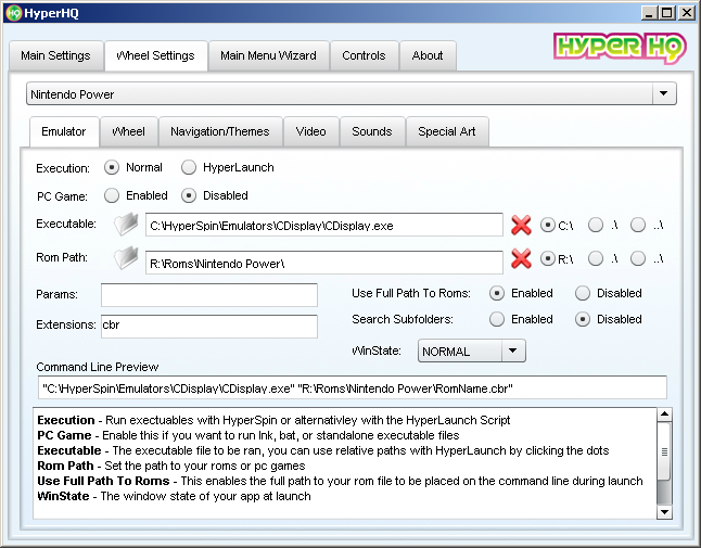

rfancella Posted September 9, 2014 Posted September 9, 2014 What module are you using for cdisplay?Zero jay, did u just add genres before the games or can you have the pre wheel, then games, the select genres? I currently have mine setup like this. In HyperHQ I have a Nintendo Power wheel. My HyperHQ screen: Execution is set to Normal. So, this means it doesn't even use HyperLaunch and therefore there is no need for a module. Hope this helps some. Thanks, Ron Code Monkey and all around Command Line geek!If you like what someone has said or done for you, be sure and 'Thank' them. And if they changed your life, send them a Beer!

ninja2bceen Posted September 12, 2014 Posted September 12, 2014 I've got car and cbz. Cbr works by itself but if I put comma in the extension so it looks like this "cbr,cbz" I get an error when cdisplay launches saying that there is no image file. So basically I can run all cbr if I don't have extension cbz in there but I have like 10 of them. When I include cbz as an extension none open. Do u know how to run both cbr and cbz? They run fine outside of huperspin and my hyper hq looks the same as urs Going to try this:http://www.ehow.com/how_7854661_make-cbr-file.html Advance the cause to 100%. http://hyperbase.hyperspin-fe.com/ Planet Geekdom, Subscribe for Tutorials! https://www.youtube.com/channel/UCdcby-s2GwriaOHGmVC2vGA?sub_confirmation=1&app=desktop
rfancella Posted September 12, 2014 Posted September 12, 2014 I've got car and cbz. Cbr works by itself but if I put comma in the extension so it looks like this "cbr,cbz" I get an error when cdisplay launches saying that there is no image file. So basically I can run all cbr if I don't have extension cbz in there but I have like 10 of them. When I include cbz as an extension none open. Do u know how to run both cbr and cbz? They run fine outside of huperspin and my hyper hq looks the same as ursGoing to try this:http://www.ehow.com/how_7854661_make-cbr-file.html Hi, The easiest thing would be to just rename all the cbz files to cbr. The difference between them is cbr files are compressed as rar and cbz files use zip. You can change the extension from cbz to rar and open the file up in WinRAR or 7z. It will show all the scanned images. Just rename the extensions to all be cbr and you should be good. Thanks, Ron Code Monkey and all around Command Line geek!If you like what someone has said or done for you, be sure and 'Thank' them. And if they changed your life, send them a Beer!
