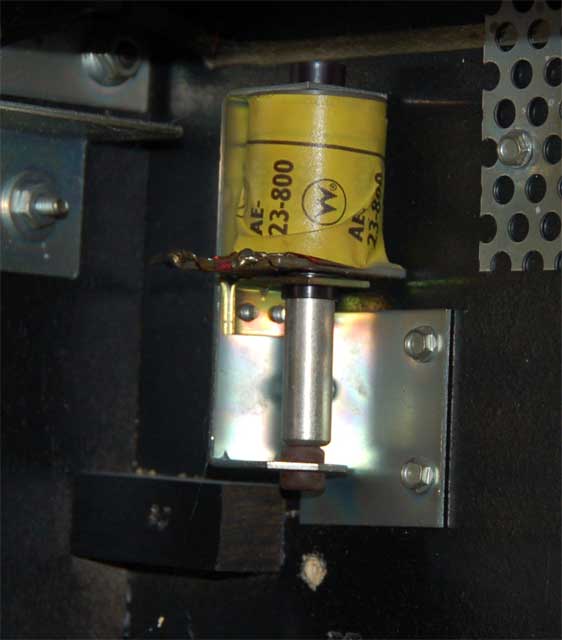

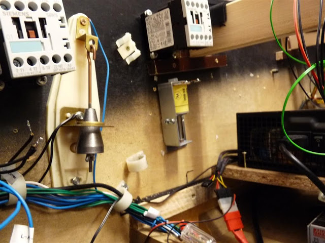

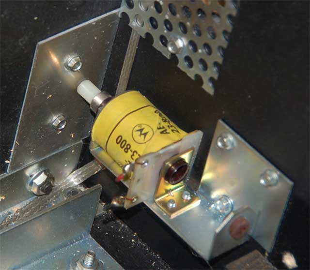

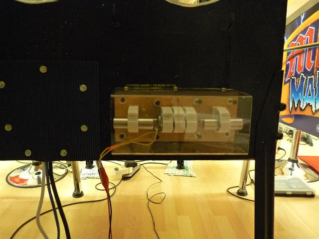

chriz99 Posted November 9, 2010 Author Posted November 9, 2010 replay knocker simply knocks to the wood. alternatively, we can try a metal bracket. it's underpowered with 12v at the moment... but it generates a loud and clear knock I will use a separate relay for the knocker, because the current is to high for the ledwiz. cheers chris [sIGPIC][/sIGPIC] * taito egret 29 candy cabs * indy & star wars pachinkos 17" bartop with ledwiz rgbleds * 10" bubble bobble & galaga bartop * arm champs 2 check out hi-res backglasses * best vpin performance * ledwiz config and software

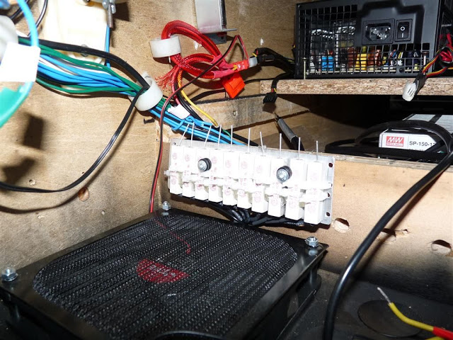

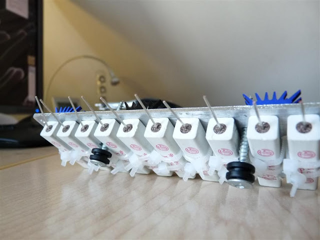

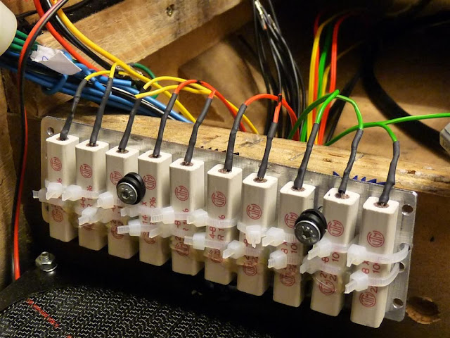

chriz99 Posted November 9, 2010 Author Posted November 9, 2010 made a resistor block for the cree leds. for better cooling cheers chris [sIGPIC][/sIGPIC] * taito egret 29 candy cabs * indy & star wars pachinkos 17" bartop with ledwiz rgbleds * 10" bubble bobble & galaga bartop * arm champs 2 check out hi-res backglasses * best vpin performance * ledwiz config and software
shilmover Posted November 9, 2010 Posted November 9, 2010 made a resistor block for the cree leds. for better cooling Holy crap! Why do you need them resistors?
pixelmagic Posted November 9, 2010 Posted November 9, 2010 wow ... so bassicly it's just falls to the bottom tick then goes back up?how do you power them? and if so can you order them somewhere in europe? very cool ! I think the replay knocker alway's knocks up to the wood, in my cabinet it sits on the left top of the backbox. Will try to make a picture of it. Normally they run on 50 Volts AC, so that could be a problem. Will try the one i have on a lower voltage, let you know the results [TABLE=width: 500] [TR] [TD][/TD] [TD=align: center]New project homepage: http://blog.pixelmagic.nl/[/TD] [TD][/TD] [/TR] [TR] [TD][/TD] [TD=align: center]LED-Wiz utility: http://pinball.pixelmagic.nl/ledwiz/[/TD] [TD][/TD] [/TR] [TR] [TD][/TD] [TD=align: center]Anyone want to buy my LEDwiz ?? [/TD] [TD][/TD] [/TR] [/TABLE]
chriz99 Posted November 9, 2010 Author Posted November 9, 2010 Holy crap! Why do you need them resistors? If you drive the cree's with 12v you need that big resistors. If you go with 5v, the resistors are only half the size. I think the replay knocker alway's knocks up to the wood, in my cabinet it sits on the left top of the backbox. Will try to make a picture of it.Normally they run on 50 Volts AC, so that could be a problem. Will try the one i have on a lower voltage, let you know the results thanks! there are 2 types of coils available... 24v and 50v... I think replay knocker are 24v (AE-23-800 coil)? cheers chris [sIGPIC][/sIGPIC] * taito egret 29 candy cabs * indy & star wars pachinkos 17" bartop with ledwiz rgbleds * 10" bubble bobble & galaga bartop * arm champs 2 check out hi-res backglasses * best vpin performance * ledwiz config and software
pixelmagic Posted November 9, 2010 Posted November 9, 2010 Made some picture's of the Demolition Man from Williams Knocker in the rest position Knocker in the 'knock' position I stand corrected, it knocks on metal @ Njay: from the pinball database parts list you can lookup the coil + kicker rod, it's a steel bar with plastic top. I have a complete playfield here with some large/small coils, if youre willing to 'knutsel' i can look for you what can be used ? [TABLE=width: 500] [TR] [TD][/TD] [TD=align: center]New project homepage: http://blog.pixelmagic.nl/[/TD] [TD][/TD] [/TR] [TR] [TD][/TD] [TD=align: center]LED-Wiz utility: http://pinball.pixelmagic.nl/ledwiz/[/TD] [TD][/TD] [/TR] [TR] [TD][/TD] [TD=align: center]Anyone want to buy my LEDwiz ?? [/TD] [TD][/TD] [/TR] [/TABLE]
chriz99 Posted November 9, 2010 Author Posted November 9, 2010 thx for the pics. what voltage did you use? ------------ flasher are working... what a soldering action cheers chris [sIGPIC][/sIGPIC] * taito egret 29 candy cabs * indy & star wars pachinkos 17" bartop with ledwiz rgbleds * 10" bubble bobble & galaga bartop * arm champs 2 check out hi-res backglasses * best vpin performance * ledwiz config and software
pixelmagic Posted November 9, 2010 Posted November 9, 2010 thx for the pics. what voltage did you use?------------ flasher are working... what a soldering action None yet, started the project last saturday urhm... hope the resistors don't get hot, they will melt your tyrips ! [TABLE=width: 500] [TR] [TD][/TD] [TD=align: center]New project homepage: http://blog.pixelmagic.nl/[/TD] [TD][/TD] [/TR] [TR] [TD][/TD] [TD=align: center]LED-Wiz utility: http://pinball.pixelmagic.nl/ledwiz/[/TD] [TD][/TD] [/TR] [TR] [TD][/TD] [TD=align: center]Anyone want to buy my LEDwiz ?? [/TD] [TD][/TD] [/TR] [/TABLE]

shilmover Posted November 9, 2010 Posted November 9, 2010 thx for the pics. what voltage did you use?------------ flasher are working... what a soldering action Thanks. What values are the resistors. The LEDs I bought are on their way from China, so I want to get ready. I will probably use +5v
chriz99 Posted November 9, 2010 Author Posted November 9, 2010 Thanks.What values are the resistors. The LEDs I bought are on their way from China, so I want to get ready. I will probably use +5v check out http://led.linear1.org/1led.wiz cheers chris [sIGPIC][/sIGPIC] * taito egret 29 candy cabs * indy & star wars pachinkos 17" bartop with ledwiz rgbleds * 10" bubble bobble & galaga bartop * arm champs 2 check out hi-res backglasses * best vpin performance * ledwiz config and software
chriz99 Posted November 9, 2010 Author Posted November 9, 2010 Nice! btw... if the led calculator recommends a 1W resistor, go with a 2-5w resistor (they produce less heat) cheers chris [sIGPIC][/sIGPIC] * taito egret 29 candy cabs * indy & star wars pachinkos 17" bartop with ledwiz rgbleds * 10" bubble bobble & galaga bartop * arm champs 2 check out hi-res backglasses * best vpin performance * ledwiz config and software

njay Posted November 10, 2010 Posted November 10, 2010 Made some picture's of the Demolition Man from WilliamsKnocker in the rest position Knocker in the 'knock' position I stand corrected, it knocks on metal @ Njay: from the pinball database parts list you can lookup the coil + kicker rod, it's a steel bar with plastic top. I have a complete playfield here with some large/small coils, if youre willing to 'knutsel' i can look for you what can be used ? Thanks for the offer my friend, i have looked up the replay knockers on the internet and a complete assembly is not that expensive. I am just wondering how to drive it? maybe a extra psu that drives at 24v? There is a lot to add on my cab but i need to make choices since my mini has oly limited space. @Chris, nice work with the leds i could see that i would be over my top to install them... my RGB leds from GGG shiped yesterday will let you know the results.. thanks again for all your help My Mini Pin Build: http://www.hyperspin-fe.com/forum/showthread.php?t=5622 My Arcade Bartop Build: http://www.hyperspin-fe.com/forum/showthread.php?t=14570

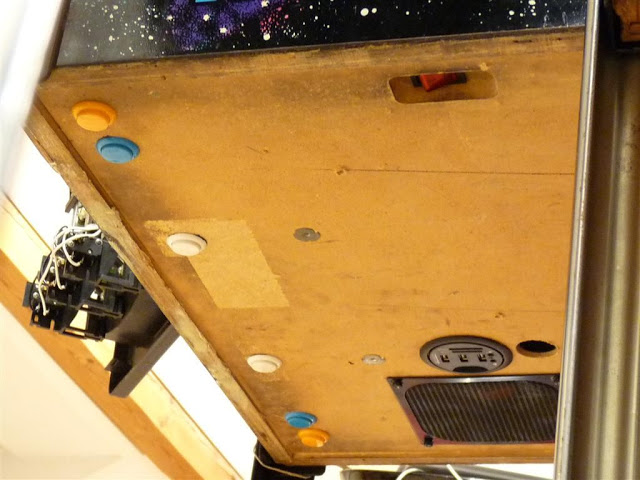

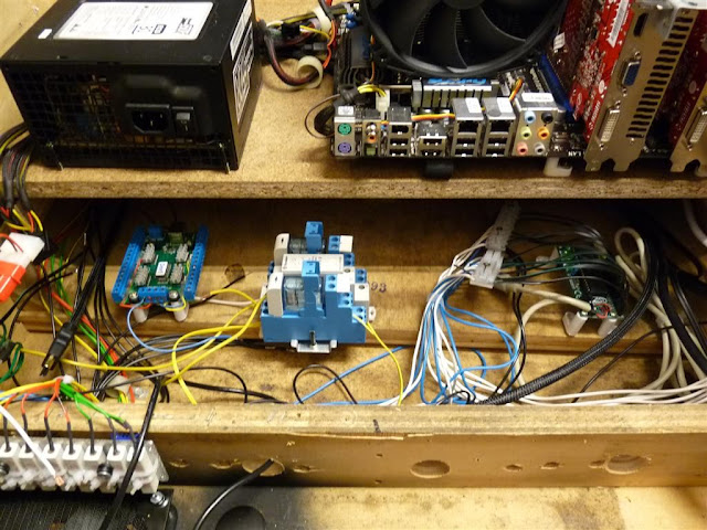

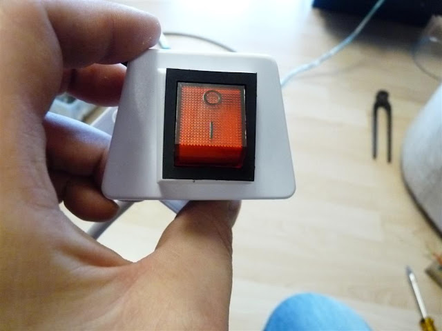

chriz99 Posted November 10, 2010 Author Posted November 10, 2010 some updates today... installed an illuminated power switch at the bottom, like the real deal. imo it's more arcade attached the shaker at the back. it's the same effect, no matter where it is mounted. 12v was too much action, I think I will drive it at 5v... you will get a smooth noticable vibration. If you want more power, add more voltage. new place for ledwiz, relays and ipac pc-board lays on foam (bottom + sideways), it's better for shaking cheers chris [sIGPIC][/sIGPIC] * taito egret 29 candy cabs * indy & star wars pachinkos 17" bartop with ledwiz rgbleds * 10" bubble bobble & galaga bartop * arm champs 2 check out hi-res backglasses * best vpin performance * ledwiz config and software
pixelmagic Posted November 10, 2010 Posted November 10, 2010 Nice work, getting a more detailed idea on how my cab should become For what purpose are the yellow/blue/white buttons if i may ask ? (do i need to order more buttons ) [TABLE=width: 500] [TR] [TD][/TD] [TD=align: center]New project homepage: http://blog.pixelmagic.nl/[/TD] [TD][/TD] [/TR] [TR] [TD][/TD] [TD=align: center]LED-Wiz utility: http://pinball.pixelmagic.nl/ledwiz/[/TD] [TD][/TD] [/TR] [TR] [TD][/TD] [TD=align: center]Anyone want to buy my LEDwiz ?? [/TD] [TD][/TD] [/TR] [/TABLE]
