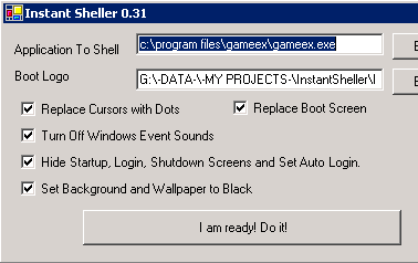

Guest gstav Posted January 1, 2011 Posted January 1, 2011 Same problem for me with the disapearing DMD when I tried to optimize to startup with instantsheller. the HIDE checkbox also kills the function of active desktop, and is the same as manually kill explorer.exe Didn´t find any way around this either... Great if you could keep the active desktop DMD. Hope somebody knows!
