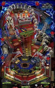

Hey... Manofwar or Highrise or UVP team... i hope you can animate the RPG in the Backglass!!!
Here how looks the SS of JP Salas... (tomorrow in Vpforums!!!)
There are a Great bacglass to do with animation too!!!
Here the T3 of Groni with the RPG Fixed...
I hope like and works fine.. please TESTIT!
