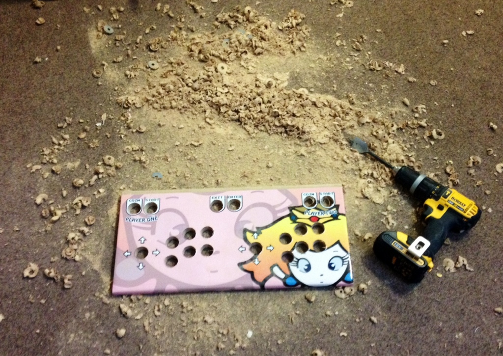

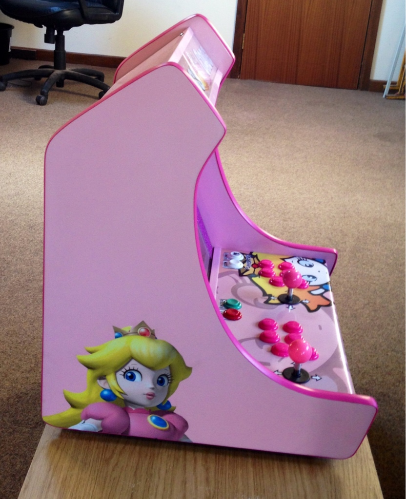

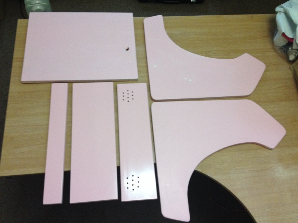

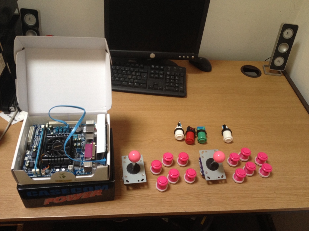

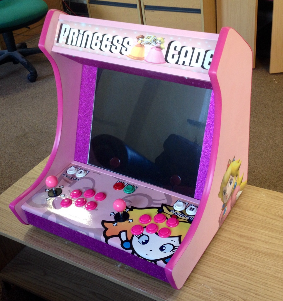

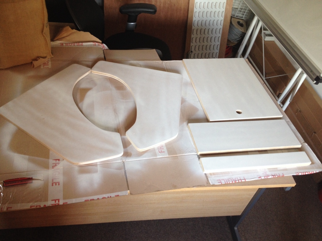

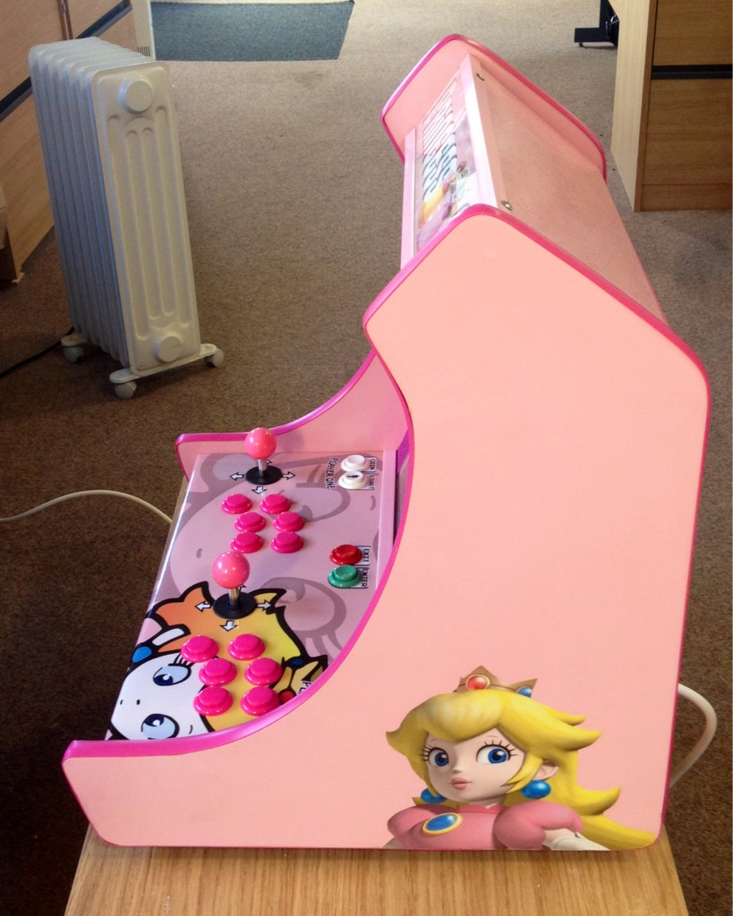

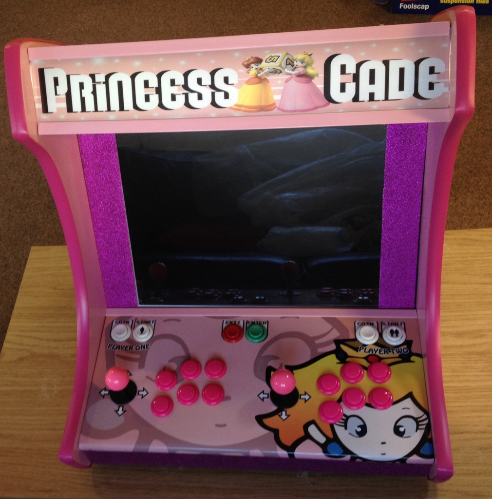

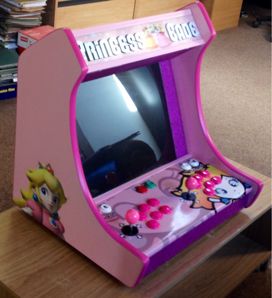

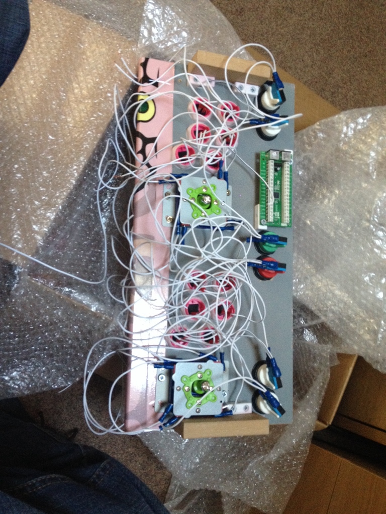

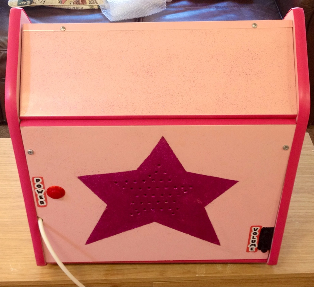

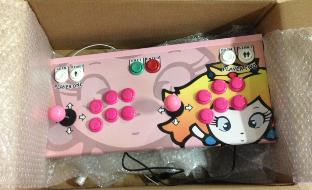

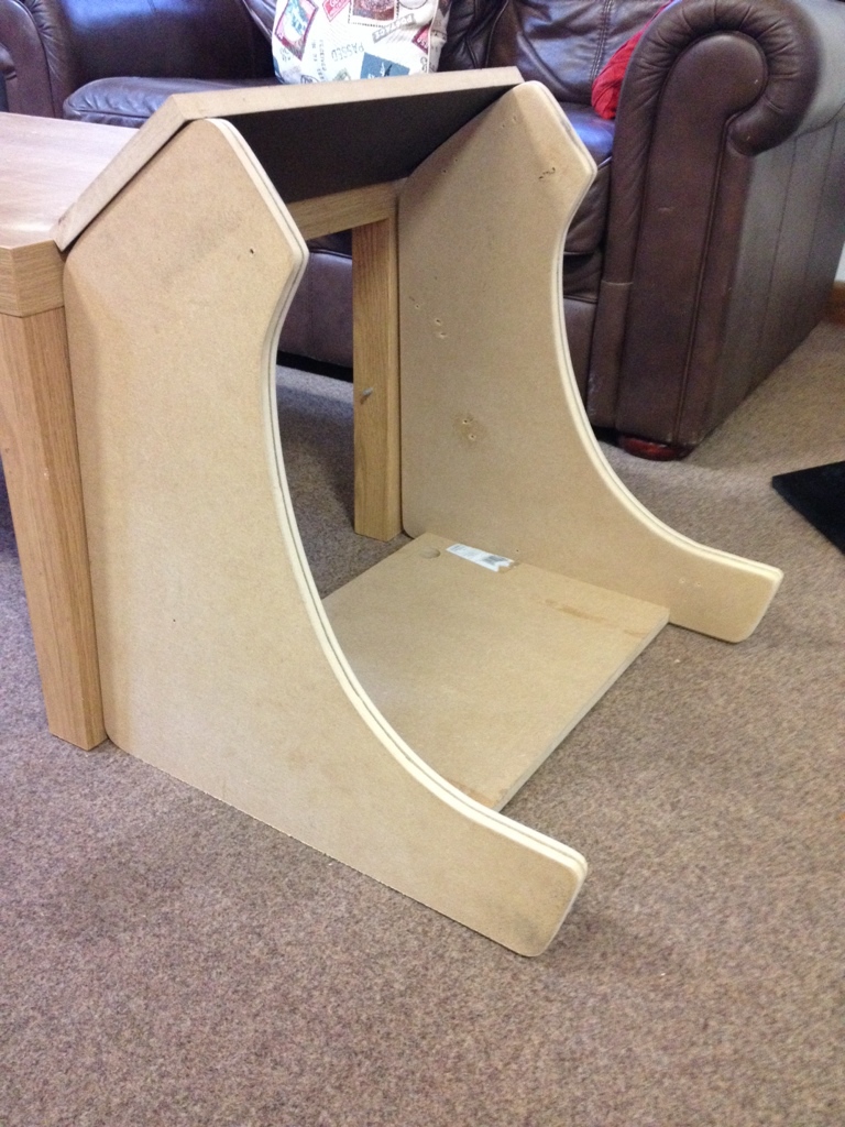

monkeychunkuk Posted March 14, 2014 Posted March 14, 2014 So at last I get to release the build Pictures of my latest project the Princess Cade Built for a female friend with one request ! make it pink The PC parts and buttons Wood cut Spraying the wood Bring on the pink What's inside Drilling and wiring the control panel Control panel complete Jp testing the buttons The artwork Jp working on the artwork The finish machine Off to its new home
steshell Posted March 14, 2014 Posted March 14, 2014 Look great, I'm sure she was happy with it. Just a couple of questions, what are the specs of the motherboard & cpu and looking at the "What's inside" picture what is the yellow coloured board at the top right and the grey/black thing between the power supply and the motherboard? Steve
showstopper Posted March 14, 2014 Posted March 14, 2014 Was just about to say that you had the colours the wrong way round for Enter and Exit, then you changed it in the later pics! How to update HyperLaunch
HazzardActual Posted March 14, 2014 Posted March 14, 2014 lookin really slick! Im planning to do something very similar for my daughter. Like a one player machine, maybe just the old nintendo and sega stuff. Ive got an old laptop that needs to be parted out and this would be a perfect project for it
Polemicist Posted March 14, 2014 Posted March 14, 2014 Got anything pinker??? Damn dude there will be one very happy girl getting that.
darkskwirl Posted March 14, 2014 Posted March 14, 2014 Any chance you can post the specs for this? This is awesome... my wife and daughter would have a new outlook on gaming if I created this for them! This should be a must for any husband/father out there!!!

monkeychunkuk Posted March 14, 2014 Author Posted March 14, 2014 steshell said: Look great, I'm sure she was happy with it.Just a couple of questions, what are the specs of the motherboard & cpu and looking at the "What's inside" picture what is the yellow coloured board at the top right and the grey/black thing between the power supply and the motherboard? Steve Thanks for the feedback. the circuit board with yellow bits is the power supply for the strip of LED i use for the marquee,its a 8 Whatt light stripped down i know i could just pick 24v off the power supply but i just don't think its built for that and could cause noise on the speakers The other one between the motherboard is the power supply for the speakers,its basically a set up pc speakers stripped down What under the hood im using a Gigabyte GA-E350N-WIN8 HDMI 8-channel HD audio Mini-ITX Motherboard with 4 gig of ram its now out of stock but i think this is the same thing http://www.ebuyer.com/582992-biostar-a68i-350-deluxe-r2-0-socket-bga-ft1-hdmi-6-channel-hd-audio-mini-a68i-350-deluxe-r2-0 or this http://www.ebuyer.com/454344-msi-lga1023-intel-nm70-2-ddr3-gbe-lan-hdmi-mini-itx-motherboard-c847ms-e33 Then im using 500 gig hard drive (kinda overkill) but it gives you room for expansion the power supply is just a bog standard power supply,of course im using ipac 32 and a 4/3 monitor darkskwirl said: Any chance you can post the specs for this? This is awesome... my wife and daughter would have a new outlook on gaming if I created this for them!This should be a must for any husband/father out there!!! i have the artwork if you would like it ill post my shopping list later if i can find it

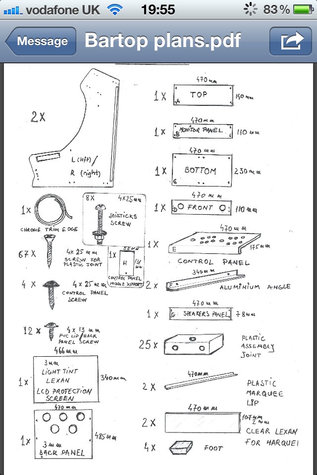

BlueScreenTT Posted March 14, 2014 Posted March 14, 2014 Where did you get the plans from did you just wing it
monkeychunkuk Posted March 14, 2014 Author Posted March 14, 2014 This the sixth I've built I've got a template but the original is from these plans
mikekim Posted March 15, 2014 Posted March 15, 2014 here is a link to the original Bartop Plans nice work Steve..
