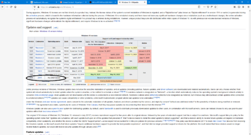

Creezz67 Posted May 23, 2020 Posted May 23, 2020 10 minutes ago, gigapig said: Your name says it all If you mean with this Windows update? I would hope not as the devs were able to fix the last issue Windows brought. I have not had the update yet on my W10 machine and my arcade machine is W7, thankfully. I will ask the devs and see if they have run into any issues. I think too many people have now said the same thing, so I would have thought this needs urgent attention. It is a major update release on Windows Updates due to be released to everyone as of yesterday (22/05/2020) See attached

Creezz67 Posted May 23, 2020 Posted May 23, 2020 16 minutes ago, gigapig said: just checked my PC and only received a Windows Defender up date. It will probably be a staggered update worldwide, due to the amount of people. It imminent, so problems will be coming very soon for everyone. Hopefully not a major issue for devs to update exe, but i remember a few years ago the same thing happened after a major update and Hyperspin was unusable for weeks until they fixed it. Another person has this issue here - as well as dontbugme.
