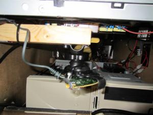

pinballlooking Posted June 29, 2012 Posted June 29, 2012 When I did my MS sidewinder I just when to Wal-Mart. Custom Accessories OTX Portable Device Holder with Flex-Neck http://www.walmart.com/catalog/product.do?product_id=16386503&findingMethod=rr it worked really well. Then I setup a friends and I used a bike one. This did not work at all like mine it was very bad. So I went back to Wal-Mart and bought the same one I have as with mine I took off silver bar. I just driller a couple holes in the mounting pad put the screws right through it. This worked great again. I used gstav config file. The first image did not work well at all. I think it is because the Wal-Mart one has a long mounting arm this amplifies the motion when you nudge. My Pinball Cabinet:http://www.hyperspin-fe.com/forum/showthread.php?t=15290

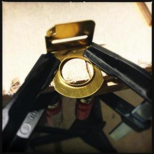

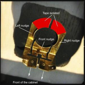

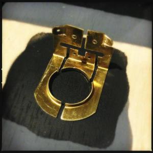

antropus Posted January 23, 2013 Posted January 23, 2013 I just got the tilt bob assembly I ordered the other day and decided to try something different. My approach was to use the original tilt bob assembly, only splitting the metal ring into 3 different points of contact for left, right and front nudge, instead of using multiple tilt bobs: The images show the before, after and my plan on how to install it and isolate the red area to avoid double tilt (front>right or front>left as the pendulum swings back and forth). The reason I tried this is to keep the inside of the machine as clean as possible while using real parts to do the job. It's ready to be mounted and tested, so I hope it works! -Kris My build: http://www.hyperspin-fe.com/forum/showthread.php?22893-Rango-s-Dirtball-%28or-DirtPinball%29-46-32-DMD-Wide-Body My work: http://www.antropus.com/artblog My FB Page: https://www.facebook.com/#!/pages/Antropus/223451400174
