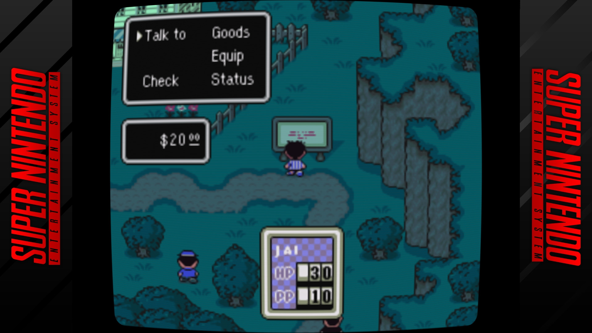

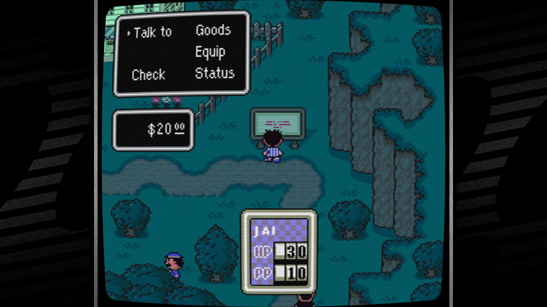

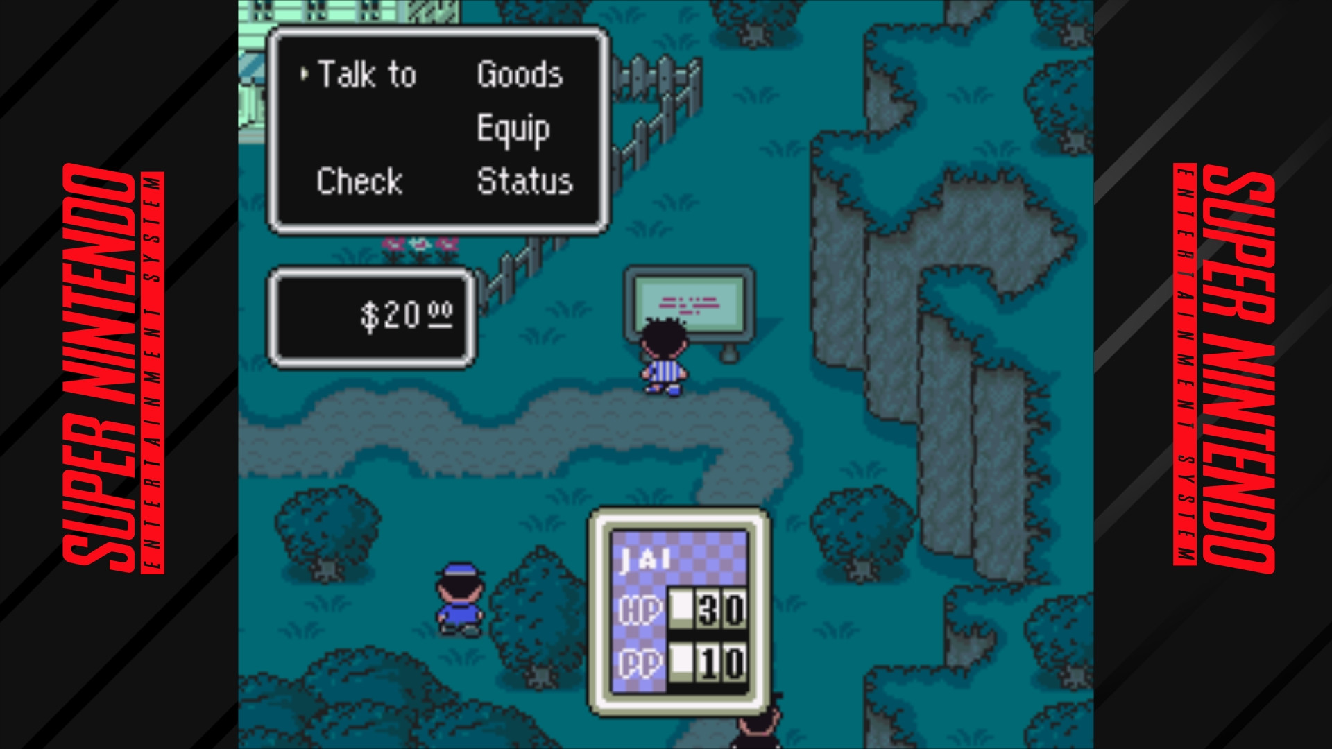

suspendedhatch Posted February 3, 2015 Posted February 3, 2015 Would anyone care to post before/after shader screen shots? Is it just to make your HDTV look like an old CRT? I've been using RetroArch for a while but never explored this aspect of it and haven't been able to find comparison pics. I've tried video settings in emulators that make pixel outlines looked curved. Is that what shaders are? That's cool but I can't stand what it does to text in RPG's so I usually revert back to the default.

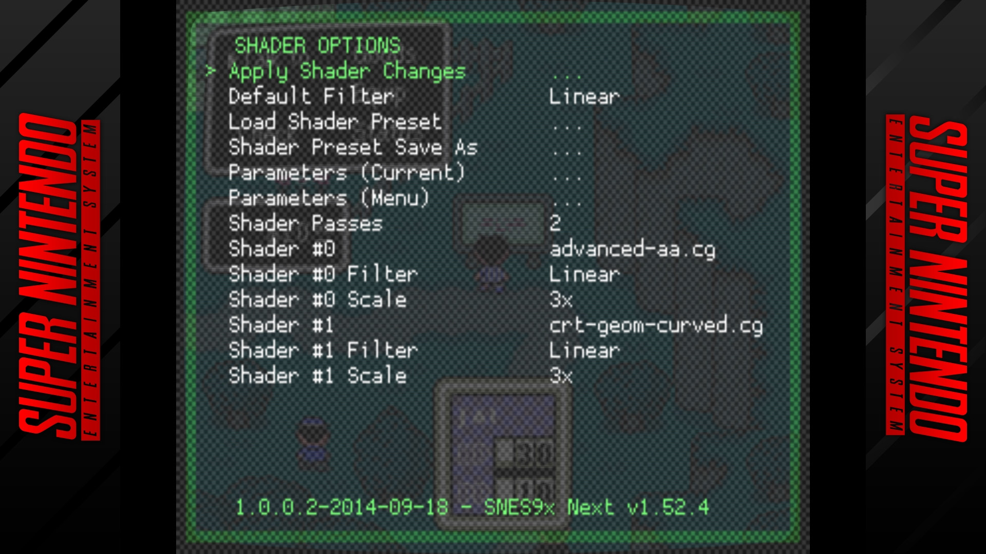

gigapig Posted February 3, 2015 Posted February 3, 2015 suspendedhatch said: Would anyone care to post before/after shader screen shots? You may have seen mine before, but here I have done EarthBound on SNES. No shaders, looks a bit fuzzy wuzzy. On, AA and geom-curved
gigapig Posted February 3, 2015 Posted February 3, 2015 Just noticed something. Having the shader passes in a certain order makes a difference to the look. Here are the same shaders with AA as the first pass.
KlopjerO Posted February 3, 2015 Posted February 3, 2015 gigapig said: Just noticed something. Having the shader passes in a certain order makes a difference to the look.Here are the same shaders with AA as the first pass. I'm not sure I like this look...the curvature looks exagerated.. | My themes / downloads | Get the MS-DOS Wheel sound pack | Get your MS-DOS game themes here | Get the MS-DOS wheel set here | My YouTube channel | WarcrafT - Lord of the clans |ZeroJay's Ultimate DooM archive
sucramjd Posted February 3, 2015 Posted February 3, 2015 I think it looks great wheres the crt-geom-curved.cg? i cant seem to find it in my shaders. [sIGPIC][/sIGPIC]
potts43 Posted February 3, 2015 Posted February 3, 2015 sucramjd said: I think it looks great wheres the crt-geom-curved.cg? i cant seem to find it in my shaders. https://github.com/libretro
Awakened Posted February 3, 2015 Posted February 3, 2015 sucramjd said: I think it looks great wheres the crt-geom-curved.cg? i cant seem to find it in my shaders. It's just called crt-geom.cg now. You can turn on curvature in the shader's parameters.

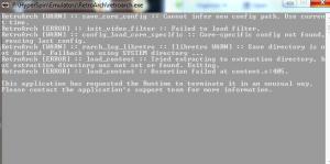

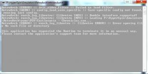

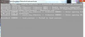

strawdog Posted February 5, 2015 Posted February 5, 2015 I am trying to get Mednafen PSX to work, I am using RetroArch v1.0.0.2-64 bit version. i have all bios files needed present in my system folder. When i select a .cue file to load RetroArch crashes, the dos window flashes ups some info but it disappears too fast for me to read, is there a way to make the dos window stay open or is that info stored in a file somewhere? once i can read that i may be able to fix it myself. if not, i can at least post the info here ! thanks
sucramjd Posted February 5, 2015 Posted February 5, 2015 strawdog said: I am trying to get Mednafen PSX to work, I am using RetroArch v1.0.0.2-64 bit version. i have all bios files needed present in my system folder. When i select a .cue file to load RetroArch crashes, the dos window flashes ups some info but it disappears too fast for me to read, is there a way to make the dos window stay open or is that info stored in a file somewhere? once i can read that i may be able to fix it myself.if not, i can at least post the info here ! thanks I have the same issue, but when i launch them though hyperlaunch they load fine strange eh. [sIGPIC][/sIGPIC]
strawdog Posted February 7, 2015 Posted February 7, 2015 sucramjd said: I have the same issue, but when i launch them though hyperlaunch they load fine strange eh. nope, no joy for me! can anyone tell me which version of RetroArch is most stable for win 7 64 bit? i've tried nightly builds (wont load due to a dll missing) i have tried stable builds (latest) - RA closes as soon as i select the .cue or .zip file ( the DOS window closes too fast for me to read the errors -i am specifically trying to get PSX games running through this, any help would be greatly received, i have spent 2 night and a bout 4 pints of coffee on this sucker ! thanks THIS IS THE '.retroarch-game-history.txt' file.... P:\HyperSpin\Emulators\RetroArch\roms\PSX\Castlevania - Chronicles.cue P:\HyperSpin\Emulators\RetroArch\cores/mednafen_psx_libretro.dll Mednafen PSX
Awakened Posted February 7, 2015 Posted February 7, 2015 strawdog said: can anyone tell me which version of RetroArch is most stable for win 7 64 bit? i've tried nightly builds (wont load due to a dll missing) i have tried stable builds (latest) - RA closes as soon as i select the .cue or .zip file ( the DOS window closes too fast for me to read the errors You can get the .dll's needed for the nightlies from the redist.7z on the buildbot. Can you load the .cue files in other emulators? Sometimes you need to open the .cue in a text editor and make sure the filenames in it match the (.bin, .iso, ect.) files you have.
strawdog Posted February 7, 2015 Posted February 7, 2015 Awakened said: You can get the .dll's needed for the nightlies from the redist.7z on the buildbot. Can you load the .cue files in other emulators? Sometimes you need to open the .cue in a text editor and make sure the filenames in it match the (.bin, .iso, ect.) files you have. thanks, rebuilt it with the latest nightly with the redist files, i have tested RA with snes core, works perfectly, so i think my problem is missing the bios file 'scph5501.bin' -FIXED- renamed scph1001.bin to scph5501.bin
