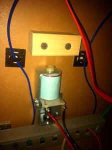

bill55 Posted May 21, 2012 Author Posted May 21, 2012 Wasn't all fun and games unfortunately. I did actually do some work too. Finally got the knocker installed. Was wondering why I even bothered getting one, but when it goes off during a game it really does sound awesome. Totally stands out. I did try to mount it horizontally at first until i realized that wouldn'twork. Didn't realize I needed gravity to pull the pin back down. Duh. I mounted it near the front on the right side of the cab. Just under my right slingshot and flipper contactors. I used a small piece of 1" x 1" wood I had left over from my playfield TV supports. Just used a couple screws and pre-drilled the holes so the block didn't split. Works perfectly and sounds good. Here's a quick vid. My Pinball Build: Indiana Jones and the Pinball Crusade
mameman Posted May 21, 2012 Posted May 21, 2012 think you really need it in the head to get the right sound, sometimes they even have a steel plate they hit against. PM me for any custom CNC needs. Find me on Facebook.. Xtreme Pinball or www.xtremepinball.com Ipad pinball cabinet iFlipper Here: See the Doctor Who build Here.... / See the Tron build Here.... / See the BattleStar Galactica build Here.... See the Big Bang Bar build Here.... / See the Twilight Zone build Here.... CNC Work Here.....
bill55 Posted May 21, 2012 Author Posted May 21, 2012 Yeh. That's normally where they are. I had people recommend putting them in the cab closer to the front since we are underpowering them. It sounds good so I may just leave it. We'll see if I get bored one day and decide to give it a shot. :-) My Pinball Build: Indiana Jones and the Pinball Crusade
pinballlooking Posted May 21, 2012 Posted May 21, 2012 TAF has it mounted there but you really need it to hit against a steel plate to get the right sound. Sent from my GT-P1010 using Tapatalk 2 My Pinball Cabinet:http://www.hyperspin-fe.com/forum/showthread.php?t=15290
