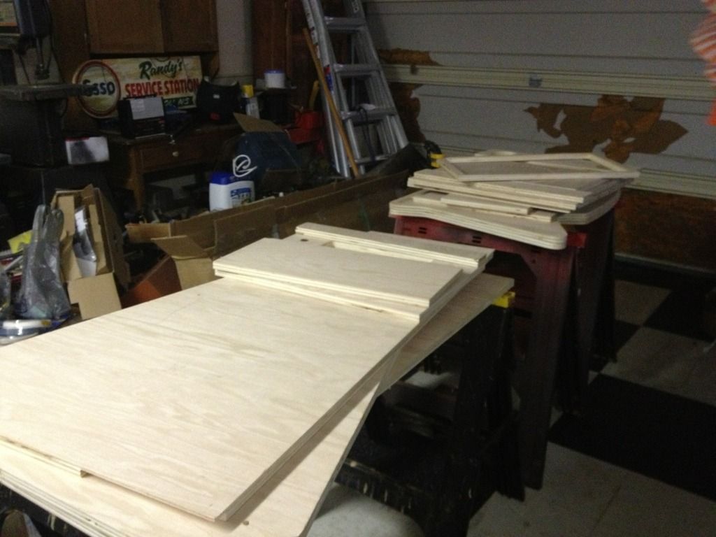

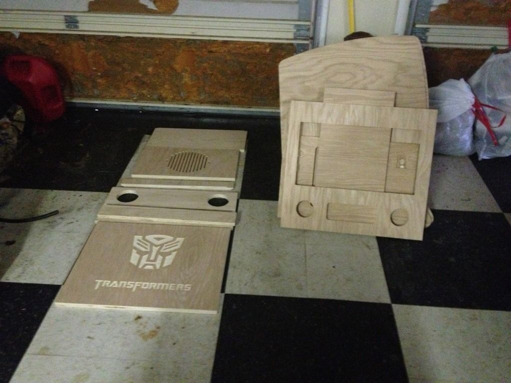

viriiguy Posted January 31, 2013 Author Posted January 31, 2013 Ohhhh... lookie what I got!!!!!! Mameman is simply AWESOME!!! This work is top notch! Just as soon as I do a little work, am going to get started on it! Ignore my nasty floors and the beat up door The previous owner had a dog locked in the garage and I have not replaced the doors yet. And the floors... Well It's a garage
mameman Posted January 31, 2013 Posted January 31, 2013 Man did that get to you quick! PM me for any custom CNC needs. Find me on Facebook.. Xtreme Pinball or www.xtremepinball.com Ipad pinball cabinet iFlipper Here: See the Doctor Who build Here.... / See the Tron build Here.... / See the BattleStar Galactica build Here.... See the Big Bang Bar build Here.... / See the Twilight Zone build Here.... CNC Work Here.....
DeeGor Posted January 31, 2013 Posted January 31, 2013 Nice. I've been recommending Mameman's services in a few other forums. Always top notch and a much better alternative to the other pre-built cabs out there.

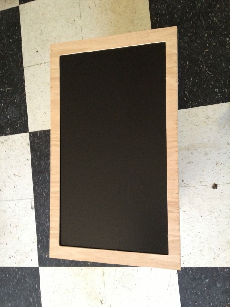

viriiguy Posted January 31, 2013 Author Posted January 31, 2013 Currently assembling the Body of the Cab. So I tested my screen fits. Mameman does PERFECT work!!!! Unfortunately I do not give perfect measurements Whoopise!!! But it is no big deal. This is the DMD, which you cannot see on the P2K Cab. So I will center the LCD and fill the gaps with cardstock or something black. Once the glue sets a little on the front, I will release the clamps, then glue and nail the rear and sides into place. I am not quite sure how I am going to drill out the leg holes.. But I am thinking I will mount the leg hardware that goes into the cab and drill from the inside out.

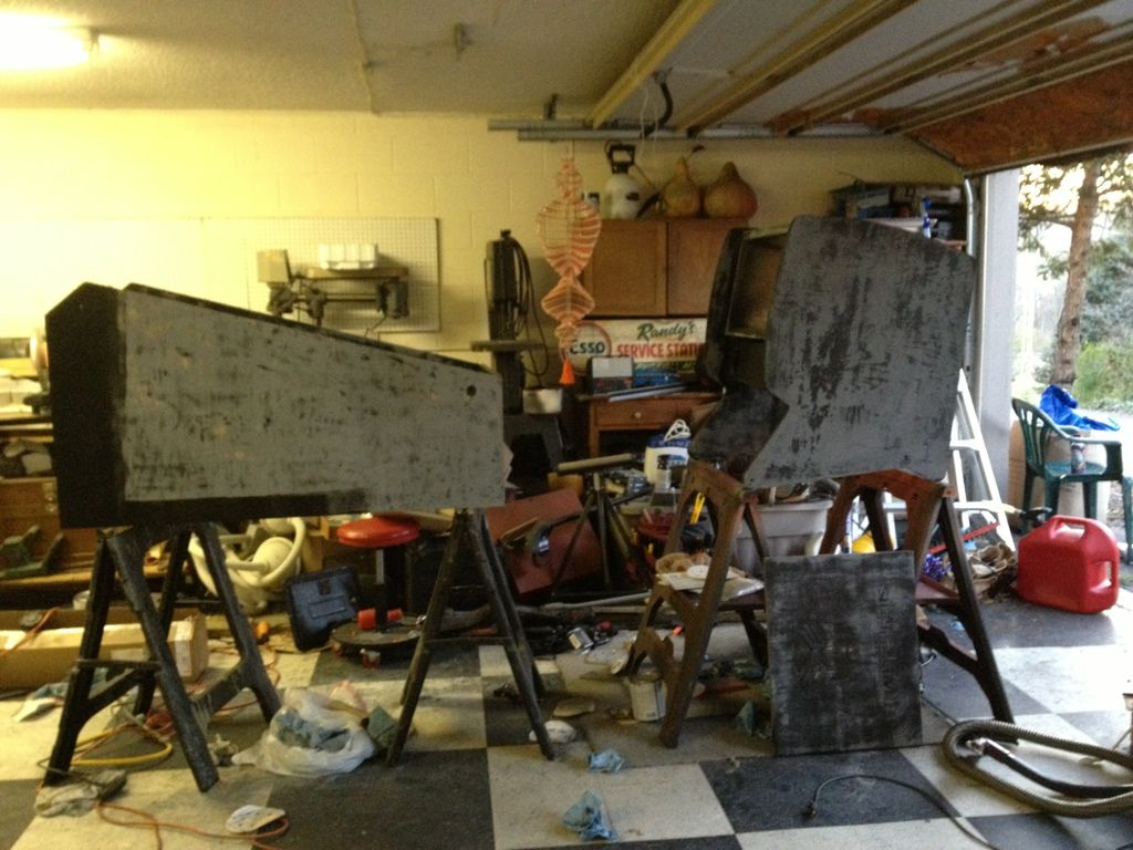

viriiguy Posted February 1, 2013 Author Posted February 1, 2013 A learning experience, this definitely is. Spray paint for a cabinet, not a good idea. This plywood can REALLY soak up the paint! So tomorrow, I will take Mameman's advice and buy some paint and a roller. I have spent the entire day painting and sanding and painting. And still it just sucks up the paint. So, instead of spending another $50 on Spray paint... I'll just buy a good can of black paint. But, here is where it is at the moment... Well actually this picture was taken 2 coats ago, but it still looks much the same.
mameman Posted February 1, 2013 Posted February 1, 2013 Yup a good primer to seal the wood then your black. Sand between coats to remove any unwanted artifacts in the finish. Since you are going to adding decals over the top be sure to let each layer then the final coat to dry properly so the decals can get a good adhesion. Winter and a garage are never a great time for paint PM me for any custom CNC needs. Find me on Facebook.. Xtreme Pinball or www.xtremepinball.com Ipad pinball cabinet iFlipper Here: See the Doctor Who build Here.... / See the Tron build Here.... / See the BattleStar Galactica build Here.... See the Big Bang Bar build Here.... / See the Twilight Zone build Here.... CNC Work Here.....

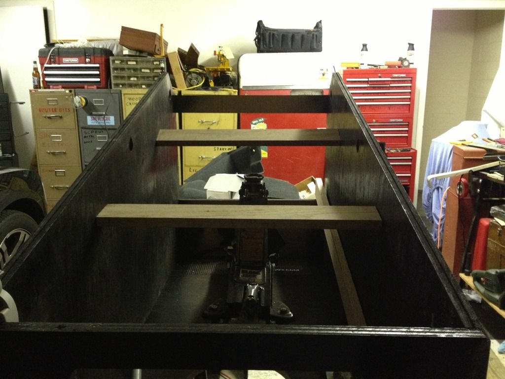

viriiguy Posted February 3, 2013 Author Posted February 3, 2013 It was pretty cold today, so I did not get much done, besides spending money. I nailed some monitor supports in place and put some filler on the front edges and over the nail holes from the supports. I also bought some tinted Kilz primer and some Velspar Gloss Black paint. Tomorrow I will sand and probably put a coat of primer on. Here are the monitor supports. They are nothing fancy and do not look level in the picture, but they are. The back one is angled to match the monitor case, this will hold it in place. The back of the monitor is a funky shape, so it was had to find places for supports. I will add some L Brackets under the oak boards to better anchor them to the cab. And, Javier sent me another update! These are the Autobots for the left side of the cab!

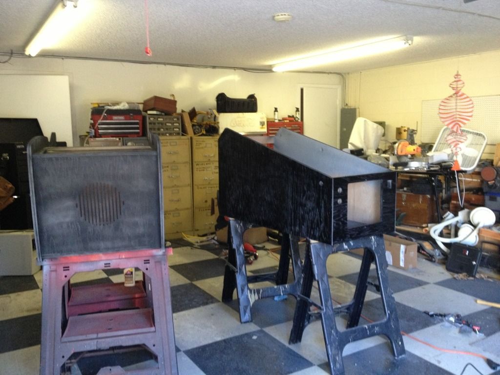

viriiguy Posted February 3, 2013 Author Posted February 3, 2013 Thanks man! Now hopefully I can get my paint job smooth enough that the artwork looks smooth and perfect on the cab!! I have been working on it all day today. I put on two thick coats of Kilz and I am now in the process of wet sanding it with 220. I have MOST of the wood grain covered up.. But there are still some small lines visable. Feels pretty smooth to the touch now though. I will probably go ahead and put a coat of the Gloss Black on after I finish sanding the head. Then try to get the last of the lines out of the black before a final coat. However, I know that the vinyl usually used for printing arcade graphics is a little forgiving, so long as the surface is flat and mostly smooth. I assume Lucian's stuff is too.

viriiguy Posted February 3, 2013 Author Posted February 3, 2013 Thanks and good to hear! I halfway considered using epoxy as the primer, that would give a mirror like finish, but the costs involved are a bit high.

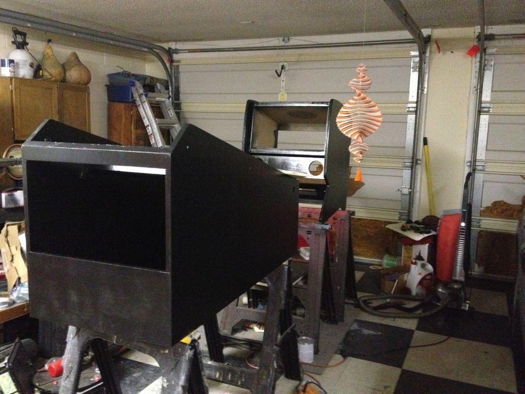

viriiguy Posted February 5, 2013 Author Posted February 5, 2013 I can't really get a good picture atm, because the car is in the garage.. But I got the first coat of high gloss black on the cabinet. I have a fair amount of sanding to do, before the next coat. But it is getting there!
viriiguy Posted February 6, 2013 Author Posted February 6, 2013 Well, the cab has a few more coats of black on it now, It still needs a little bit of work, but I am almost there. I have a couple of spots on the body that need some work, but the rest is just about where I need it to be. I got my coin door today, but I won't be using it. It is in a lot worse shape than the auction showed. So instead I will strip it for parts. Always good to have extra coin mechs. So I will be using my Import door for now. It is in great shape, just won't accept any currency that I have. I also got my T-Molding in, 10 foot of Red and 10 foot of Purple My Boss 4 channel 400W amp came in. I wanted to work on trying to figure out how to hook it up, but my 12W PS is not in yet. Oh yea and my new Stern lock bar and receiver came in today also! This weekend is a long weekend for me, Yay President's Day!!! So I am hoping to start getting it assembled. I have no idea when I will have the 12V Power supply. So that is going to hold me back on a few details. The delivery estimate on it is anytime between Feb 8th and March 15th. I also ordered a couple of sheets of glass today from a local place. 1 for Optimus-Pin and one for our Addams Family. This is what the cab looked like yesterday afternoon after HEAVY sanding... Currently it is black again. *Edit* Well dang it, I was SURE I had leg brackets, but can't find them.. So I ordered a new set. Mameman, or any of the other P2k guys.. Can you give me measurements for the the hole, front and back for the leg bolts? I am trying to figure out where they need to be drilled, but info on these guys is sparse. Thanks!
