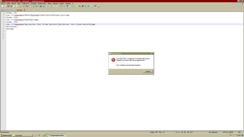

as he could do the following to your script
first run c://media/intro.mp4 i associated with vlc.
then
c://hyperspin.exe launch, tur another volume adjuster, hypersearch, etc ...
Your question is not related to this thread's topic. Try starting a new thread in the help section.
