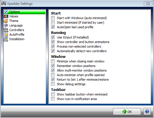

newoski Posted March 24, 2015 Posted March 24, 2015 Hi Guys, I'm having a problem using the script. I have HyperSpin shelled with the script set to launch via HyperHQ. When HyperSpin launches, xpadder is loading in front and then minimizing. I've included a video below (you'll see xpadder swoop in on the right), as well as my script and my xpadder settings: Video: http://youtu.be/utVxz4hz53I Script: http://pastebin.com/Ua2CGheH xpadder Settings: So close to gaming nirvana... Hoping someone can help!
