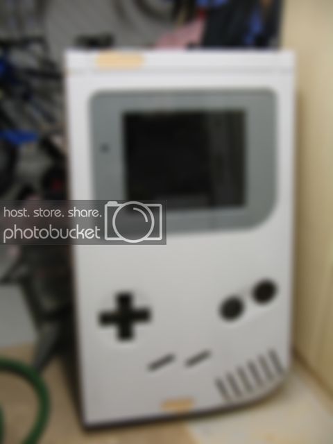

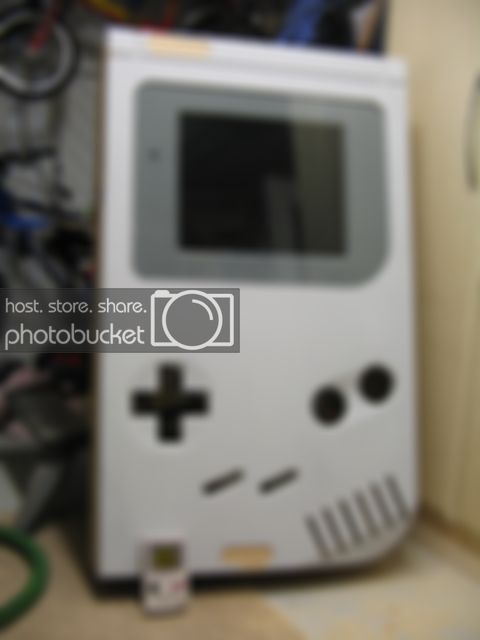

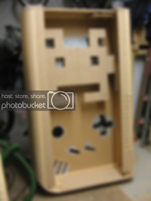

jahilton2002 Posted December 15, 2013 Author Posted December 15, 2013 More detailing added, also fitted the screen. also some news in reference outputting the Gameboys screen to vga/DVI to follow

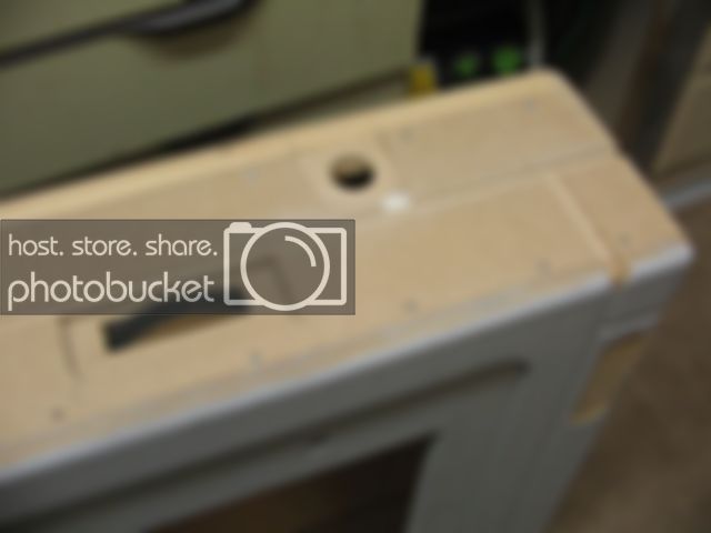

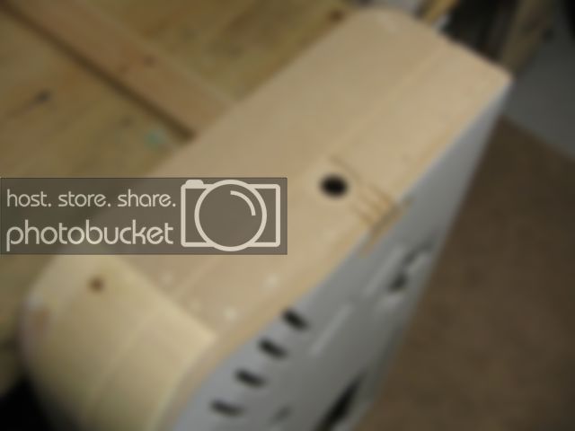

jahilton2002 Posted December 19, 2013 Author Posted December 19, 2013 Added headphones and power sockets:

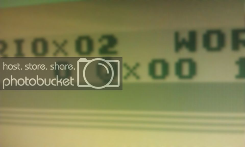

jahilton2002 Posted March 4, 2014 Author Posted March 4, 2014 The Gameboy Hacks have started As mentioned before. Mike over at www.fpgaarcade.com is helping us make our Gameboy project a reality. He sent use a picture today that got our attention! here’s what he had to say; I’ve attached the victim to a Replay board and captured the video signal. The picture below is a bit fuzzy, but I had to add small resistors to protect the FPGA from the 5V signals. The next step is probably to remove the gameboy crystal and send a clock over from the Replay PLL. This will allow me to lock the VGA and the gameboy video together to avoid any tearing.
