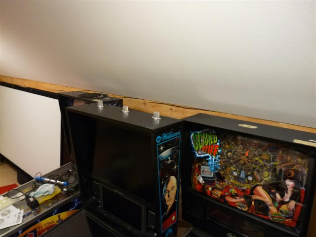

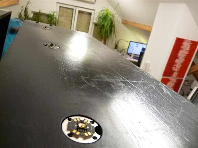

chriz99 Posted November 6, 2010 Author Posted November 6, 2010 drilled some holes in the backbox cheers chris [sIGPIC][/sIGPIC] * taito egret 29 candy cabs * indy & star wars pachinkos 17" bartop with ledwiz rgbleds * 10" bubble bobble & galaga bartop * arm champs 2 check out hi-res backglasses * best vpin performance * ledwiz config and software

shilmover Posted November 6, 2010 Posted November 6, 2010 drilled some holes in the backbox Drool!!! nice work chris.. your really a pro with tools etc.man i want that software so bad i can taste it I second that! Want software...

chriz99 Posted November 6, 2010 Author Posted November 6, 2010 you can also use the "star heatsink" (posted in this thread)... 5-7cm diameter, 1cm height. if you prefer "invisible" mounting, you have to go with the small tower heatink. don't forget that the cree high power rgbw led generates up to 7watt. if there's no cooling it will fry in minutes. cheers chris [sIGPIC][/sIGPIC] * taito egret 29 candy cabs * indy & star wars pachinkos 17" bartop with ledwiz rgbleds * 10" bubble bobble & galaga bartop * arm champs 2 check out hi-res backglasses * best vpin performance * ledwiz config and software

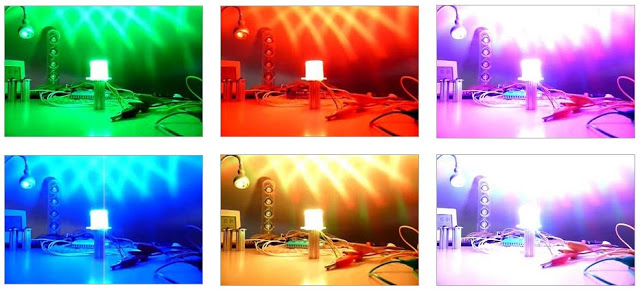

chriz99 Posted November 7, 2010 Author Posted November 7, 2010 short vid of the cree flasher in action (at 50% load/350mA) <object width="425" height="344"><param name="movie" value="http://www.youtube.com/watch?v=K-zkutPMQI4&hl=de_DE&fs=1&rel=0"></param><param name="allowFullScreen" value="true"></param><param name="allowscriptaccess" value="always"></param><embed src="http://www.youtube.com/watch?v=K-zkutPMQI4&hl=de_DE&fs=1&rel=0" type="application/x-shockwave-flash" allowscriptaccess="always" allowfullscreen="true" width="425" height="344"></embed></object> cheers chris [sIGPIC][/sIGPIC] * taito egret 29 candy cabs * indy & star wars pachinkos 17" bartop with ledwiz rgbleds * 10" bubble bobble & galaga bartop * arm champs 2 check out hi-res backglasses * best vpin performance * ledwiz config and software
njay Posted November 7, 2010 Posted November 7, 2010 holy crap .. that would blind your ass real nice if you look into it which game was it? think my rgb leds are going to be fine at close range thanks for the vid chris... I am holding a pinball party 20st nov. do you think the software will be out by then? My Mini Pin Build: http://www.hyperspin-fe.com/forum/showthread.php?t=5622 My Arcade Bartop Build: http://www.hyperspin-fe.com/forum/showthread.php?t=14570
chriz99 Posted November 7, 2010 Author Posted November 7, 2010 they are insanely bright even at 50% load. It was just a first test without ledwiz-control. I can't say when it's going to be released, I am just a beta-tester. It's Manofwar's code and he will release it when it's done. cheers chris [sIGPIC][/sIGPIC] * taito egret 29 candy cabs * indy & star wars pachinkos 17" bartop with ledwiz rgbleds * 10" bubble bobble & galaga bartop * arm champs 2 check out hi-res backglasses * best vpin performance * ledwiz config and software

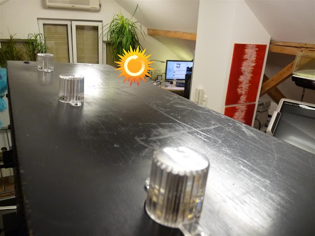

Guest gstav Posted November 8, 2010 Posted November 8, 2010 Hi Chriz! What type of flasher caps are you using? Is it the small Mini Mars Dome or the bigger Clear Flasher Dome? How may RGB led lights are you planning to be used with a full setup? PS: Looks completely awesome!!
chriz99 Posted November 8, 2010 Author Posted November 8, 2010 Hi Chriz!What type of flasher caps are you using? Is it the small Mini Mars Dome or the bigger Clear Flasher Dome? How may RGB led lights are you planning to be used with a full setup? PS: Looks completely awesome!! hmm, I don't know here are the measurements of my flasher dome: 32mm height, 32mm diameter cheers chris [sIGPIC][/sIGPIC] * taito egret 29 candy cabs * indy & star wars pachinkos 17" bartop with ledwiz rgbleds * 10" bubble bobble & galaga bartop * arm champs 2 check out hi-res backglasses * best vpin performance * ledwiz config and software
Guest gstav Posted November 8, 2010 Posted November 8, 2010 Thanx... but how many do you think is needed for the maximum RGB setup? (have you thought of installing strobe flashers too?)
