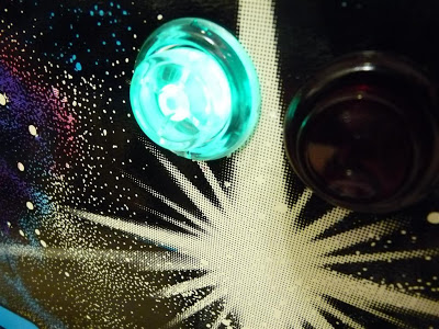

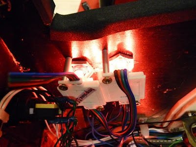

chriz99 Posted November 8, 2010 Author Posted November 8, 2010 I think 3 flasher are perfect. with 3 flasher you can emulate each color and each viewing angle (left flasher/middle flasher/right flasher) plus rotation effects (beacon topper, blinky left/right flasher). the cree leds are brighter than my strobe flasher, so I will go with the cree's for everything. cheers chris [sIGPIC][/sIGPIC] * taito egret 29 candy cabs * indy & star wars pachinkos 17" bartop with ledwiz rgbleds * 10" bubble bobble & galaga bartop * arm champs 2 check out hi-res backglasses * best vpin performance * ledwiz config and software
njay Posted November 8, 2010 Posted November 8, 2010 Hmm really three? it will be crouded on my little backbox then... Luckily i ordered 4 rgb leds from randy... only need one extra clear toplight Is the software configurable that you will be able to tell it to use 2 instead? My Mini Pin Build: http://www.hyperspin-fe.com/forum/showthread.php?t=5622 My Arcade Bartop Build: http://www.hyperspin-fe.com/forum/showthread.php?t=14570
Guest gstav Posted November 8, 2010 Posted November 8, 2010 the cree leds are brighter than my strobe flasher, so I will go with the cree's for everything. Man! How bright are these suckers?! I thought of mounting mine under the glass on the panel wall which hiding the rest of the DMD-monitor pointing the domes towards the player. But maybe that would be like staring into the sun? Bad if you go blind after playing pinball. (mama says that you go blind playing with your wee-wee)

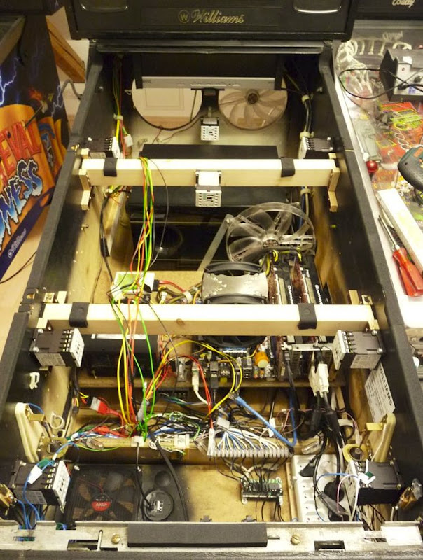

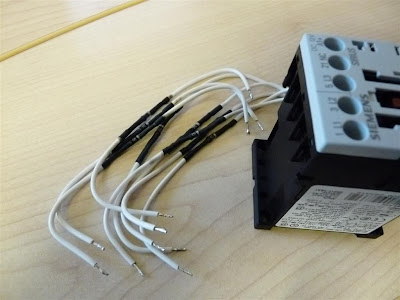

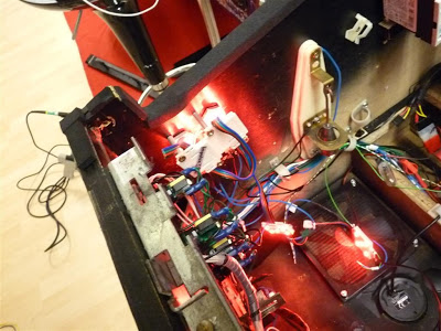

chriz99 Posted November 8, 2010 Author Posted November 8, 2010 Is the software configurable that you will be able to tell it to use 2 instead? yes, no prob Bad if you go blind after playing pinball. (mama says that you go blind playing with your wee-wee) maybe, try it and report. I love your mama statement Chris - I've been following this thread for a while and I must say that the end product is simply awesome - you've convinced me to try building my own.My first purchase will be the various required monitors - however, the model you used is no longer available. I checked Sharp's current lineup and it looks like the LC-46LE620UT has similar dimensions, but is a bit thinner and lighter. Do you see any potential issues with using this model instead? thanks for your kind words! I think the new 46" sharp is also suitable. ------------------------------ here are some wiring pics... man man man some diodes for the siemens cree wiring party cheers chris [sIGPIC][/sIGPIC] * taito egret 29 candy cabs * indy & star wars pachinkos 17" bartop with ledwiz rgbleds * 10" bubble bobble & galaga bartop * arm champs 2 check out hi-res backglasses * best vpin performance * ledwiz config and software
gbeef Posted November 8, 2010 Posted November 8, 2010 very nice.. progress. why is there diodes for the Siemens? My Cabs My Pin Cab Attack of the PINZ cab My Racing Cab OutRun Racing
chriz99 Posted November 8, 2010 Author Posted November 8, 2010 diode is to prevent back-emf, costs only 10cents. I think there are already diodes in the ledwiz driver chips... but better safe than sorry cheers chris [sIGPIC][/sIGPIC] * taito egret 29 candy cabs * indy & star wars pachinkos 17" bartop with ledwiz rgbleds * 10" bubble bobble & galaga bartop * arm champs 2 check out hi-res backglasses * best vpin performance * ledwiz config and software
shilmover Posted November 8, 2010 Posted November 8, 2010 Chris, I am assuming those solenoids are for feedback against the cab? I have mine working with a custom circuit, but would love to hook up the Replay/Free game solenoid. I believe I read somewhere that it works with this solution too?
chriz99 Posted November 8, 2010 Author Posted November 8, 2010 Chris,I am assuming those solenoids are for feedback against the cab? I have mine working with a custom circuit, but would love to hook up the Replay/Free game solenoid. I believe I read somewhere that it works with this solution too? yes, the siemens contactors are for force feedback. I will install an original pinball replay knocker. I think we have to use an extra relay, because the replay knocker wants 24-50v and a lot of ampere (you can't wire the replay knocker directly to the ledwiz). More coming soon! cheers chris [sIGPIC][/sIGPIC] * taito egret 29 candy cabs * indy & star wars pachinkos 17" bartop with ledwiz rgbleds * 10" bubble bobble & galaga bartop * arm champs 2 check out hi-res backglasses * best vpin performance * ledwiz config and software

chriz99 Posted November 8, 2010 Author Posted November 8, 2010 lol, at first I wanted to install 7 siemens... but then I found 1 more siemens (reserve) and thought "put it in there" 2 for flippers 2 for slingshots and special events (autoplunger) back relays for bumpers and special events (you can choose left 3 bumpers, right 3 bumpers and so on, mm trolls, mm castle, afm ufo). so every relay "clacks" at the right position (to hear and feel it right) I know it's crazy, but I am a perfectionist cheers chris [sIGPIC][/sIGPIC] * taito egret 29 candy cabs * indy & star wars pachinkos 17" bartop with ledwiz rgbleds * 10" bubble bobble & galaga bartop * arm champs 2 check out hi-res backglasses * best vpin performance * ledwiz config and software

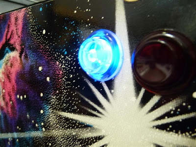

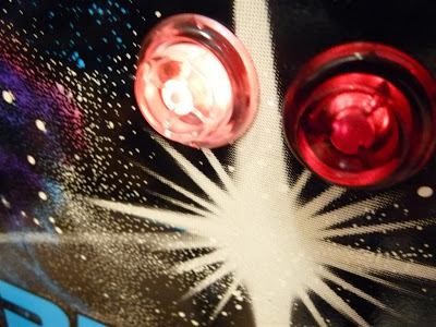

chriz99 Posted November 8, 2010 Author Posted November 8, 2010 installed the rgb-button lights (need a second transparent button)... cheers chris [sIGPIC][/sIGPIC] * taito egret 29 candy cabs * indy & star wars pachinkos 17" bartop with ledwiz rgbleds * 10" bubble bobble & galaga bartop * arm champs 2 check out hi-res backglasses * best vpin performance * ledwiz config and software

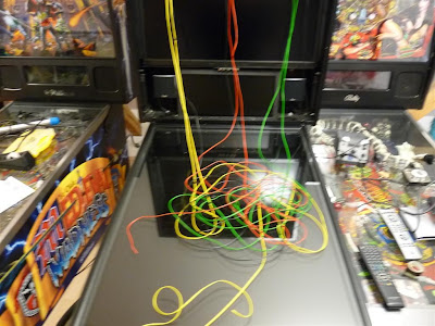

gbeef Posted November 8, 2010 Posted November 8, 2010 thats ALOT OF WIRES My Cabs My Pin Cab Attack of the PINZ cab My Racing Cab OutRun Racing
chriz99 Posted November 8, 2010 Author Posted November 8, 2010 thats ALOT OF WIRES too much wires, too little space. I have to rethink my cable managment tomorrow cheers chris [sIGPIC][/sIGPIC] * taito egret 29 candy cabs * indy & star wars pachinkos 17" bartop with ledwiz rgbleds * 10" bubble bobble & galaga bartop * arm champs 2 check out hi-res backglasses * best vpin performance * ledwiz config and software

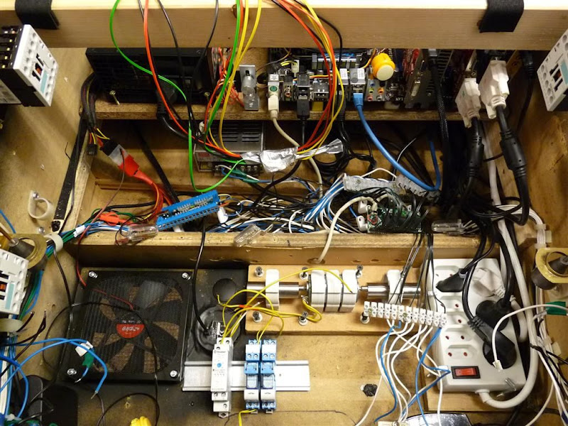

njay Posted November 8, 2010 Posted November 8, 2010 Lol yeah wiring is the coolest part about our hobby no Looking at the above pic the shaker is not that big actually should fit my cab .. but need to switch to ssd first then My Mini Pin Build: http://www.hyperspin-fe.com/forum/showthread.php?t=5622 My Arcade Bartop Build: http://www.hyperspin-fe.com/forum/showthread.php?t=14570
njay Posted November 8, 2010 Posted November 8, 2010 Hmm watching that pic chris i think when the shaker activates your mercury switches will go nuts My Mini Pin Build: http://www.hyperspin-fe.com/forum/showthread.php?t=5622 My Arcade Bartop Build: http://www.hyperspin-fe.com/forum/showthread.php?t=14570
