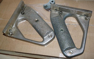

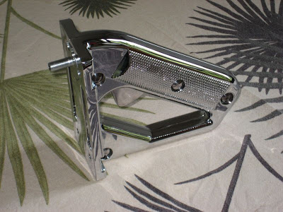

chriz99 Posted December 9, 2009 Author Posted December 9, 2009 I am not really happy with the nanotech motion/plunger stuff, so I bought this second hand terminator/star trek gun assembly for replacement. I hope it will look like... after chromizing. I think its a great (and working) enhancement for such gun-games like T2, STTNG (moveable canons), LW3 (gun videomodes) or simply for Indy, cactus canyon, guns n roses..... ive got also some solenoids/knockers (force feedback) and 3 tilt-assemblys for nudging. I am curious how it works. more to come soon. cheers chris [sIGPIC][/sIGPIC] * taito egret 29 candy cabs * indy & star wars pachinkos 17" bartop with ledwiz rgbleds * 10" bubble bobble & galaga bartop * arm champs 2 check out hi-res backglasses * best vpin performance * ledwiz config and software

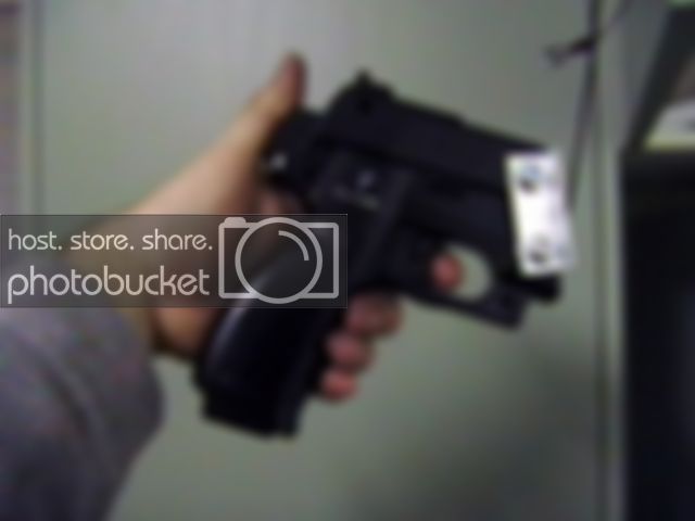

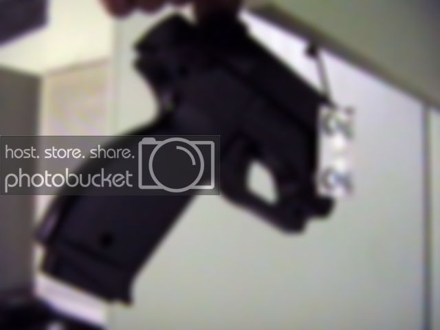

oooPLAYER1ooo Posted December 10, 2009 Posted December 10, 2009 hahaha i did this 8 months ago it is the best thing to do was very important in my lethal weapon 3 testing i made my own using a psone lightgun already had the microswitch just had to wire up the ipac to it Nice Guys Finish Last, Player Finishes On Her Face....................
