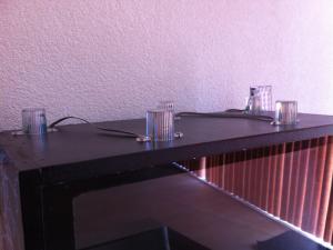

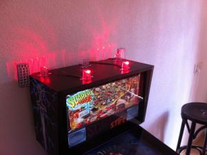

njay Posted August 10, 2011 Author Posted August 10, 2011 What do you guys think about the new strobo placement? Ah Yes a lot neater: New strobo controller placement: My Mini Pin Build: http://www.hyperspin-fe.com/forum/showthread.php?t=5622 My Arcade Bartop Build: http://www.hyperspin-fe.com/forum/showthread.php?t=14570
Numiah Posted August 10, 2011 Posted August 10, 2011 Looks a lot better I use the same strobes. One thing I noticed is that they need to be pointed at the player to experience the full effect. That's why I putted them underneath and at an angle. By the way, i removed the 'black box' that came with it and have the ROM control the strobing. **Each pinball machine is a tiny universe... that we control** My Build Overview My Computer Specifications

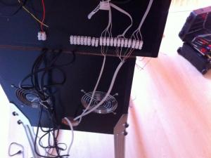

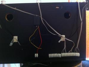

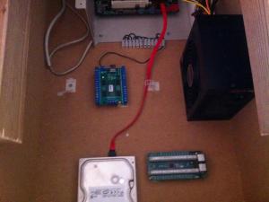

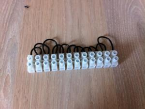

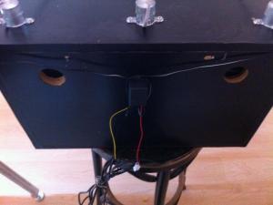

njay Posted August 10, 2011 Author Posted August 10, 2011 Here are some shots of the backbox and cable ties ! My Goal is to have an easier to deteach backbox: I now only have to screw lose the cables that run trought the terminal strip to the flashers and strobes, before i had the wires run all the way inside the cabinet. Cable ties: My Mini Pin Build: http://www.hyperspin-fe.com/forum/showthread.php?t=5622 My Arcade Bartop Build: http://www.hyperspin-fe.com/forum/showthread.php?t=14570

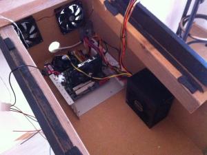

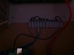

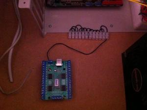

njay Posted August 11, 2011 Author Posted August 11, 2011 More Wiring today : It may not look pretty but you will never see the backside of it and the functionality is good, i can now easely disconnect the backbox from the main cabinet and the inerts of the cabinet is cleaner. PS. the black wires for the speakers and monitor are normally inside the cabinet ! Terminal strip with piggy banking: And more: My Mini Pin Build: http://www.hyperspin-fe.com/forum/showthread.php?t=5622 My Arcade Bartop Build: http://www.hyperspin-fe.com/forum/showthread.php?t=14570

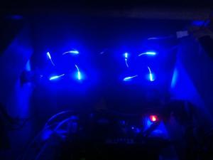

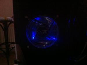

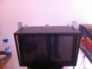

njay Posted August 11, 2011 Author Posted August 11, 2011 New Blue LED Fans: My Mini Pin Build: http://www.hyperspin-fe.com/forum/showthread.php?t=5622 My Arcade Bartop Build: http://www.hyperspin-fe.com/forum/showthread.php?t=14570

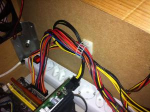

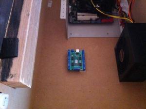

njay Posted August 11, 2011 Author Posted August 11, 2011 I think it's still a lot cleaner then before but damn i have so little space My Mini Pin Build: http://www.hyperspin-fe.com/forum/showthread.php?t=5622 My Arcade Bartop Build: http://www.hyperspin-fe.com/forum/showthread.php?t=14570

njay Posted August 12, 2011 Author Posted August 12, 2011 Really guys ? i feel such an amateur I know the wiring on the backbox is ugly but its practical when i build my fullsize cabinet .. chris and your wiring will be my guide ! My Mini Pin Build: http://www.hyperspin-fe.com/forum/showthread.php?t=5622 My Arcade Bartop Build: http://www.hyperspin-fe.com/forum/showthread.php?t=14570
Darkfall Posted August 12, 2011 Posted August 12, 2011 Just a quick hint on the LEDWiz wiring on the common side - rather than have the terminal strip, you can run one wire to your first button, then chain to the second button, third button, etc. There is no need to run the common all the way back to the terminal strip for each button - it's a lot of extra wire and time, which makes for more mess *grin*. You can do the same for the IPAC. For power on non-LEDWiz controlled LEDs, you can do the chaining for both positive and negative wires. ...Paul Check out Wildfire Pinball's build details here: Project Wildfire
njay Posted August 13, 2011 Author Posted August 13, 2011 Yeah i did do the same for the ipac , but not for the led-wiz ... reason ? i don't know but many thanks for your tip darkfall My Mini Pin Build: http://www.hyperspin-fe.com/forum/showthread.php?t=5622 My Arcade Bartop Build: http://www.hyperspin-fe.com/forum/showthread.php?t=14570
Darkfall Posted August 13, 2011 Posted August 13, 2011 Yeah i did do the same for the ipac , but not for the led-wiz ... reason ? i don't know but many thanks for your tip darkfall No problem, njay. Build is looking good! ...Paul Check out Wildfire Pinball's build details here: Project Wildfire

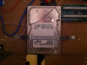

njay Posted August 14, 2011 Author Posted August 14, 2011 Added some metal strapping to secure the HD to the cabinet: My Mini Pin Build: http://www.hyperspin-fe.com/forum/showthread.php?t=5622 My Arcade Bartop Build: http://www.hyperspin-fe.com/forum/showthread.php?t=14570

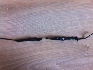

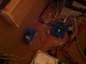

njay Posted February 28, 2012 Author Posted February 28, 2012 Hey Guys, I just bought 3 siemens contactors from usa ebay for 30 so it's 70 with shipping still only 51 euros so cheap !! I got only question how i do make the wire that contains the diode? Also i see wiring diagrams of everyone using the voltage bank on the wiz, could i just run the 24+ to a terminal strip instead? My Mini Pin Build: http://www.hyperspin-fe.com/forum/showthread.php?t=5622 My Arcade Bartop Build: http://www.hyperspin-fe.com/forum/showthread.php?t=14570
njay Posted February 29, 2012 Author Posted February 29, 2012 Also a question can i combine both slingshots to one output? say sling left and right to ledwiz port 21? My Mini Pin Build: http://www.hyperspin-fe.com/forum/showthread.php?t=5622 My Arcade Bartop Build: http://www.hyperspin-fe.com/forum/showthread.php?t=14570
njay Posted March 5, 2012 Author Posted March 5, 2012 Alrighty Crude Diode wire made with my limited soldering skills and the use of some electrical tape My Mini Pin Build: http://www.hyperspin-fe.com/forum/showthread.php?t=5622 My Arcade Bartop Build: http://www.hyperspin-fe.com/forum/showthread.php?t=14570
