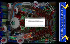

tetrafred Posted June 5, 2012 Share Posted June 5, 2012 (edited) do you have ahk basic or ahk_l on your cab?try to add: COM_CoInitialize() in com.ahk after com_init() I have the same TTdax problem but i don't know how write the line. Is it like this?: (i haven't the ahk basic or ahk_l on my hyperpin directory) COM_Init()COM_CoInitialize() { Return DllCall("ole32\OleInitialize", "Uint", 0) } All my try doesn't work. Thanks Edited June 5, 2012 by tetrafred Link to comment Share on other sites More sharing options...
tetrafred Posted June 22, 2012 Share Posted June 22, 2012 My problem with the rules: Someone to help me please? Thanks Link to comment Share on other sites More sharing options...
