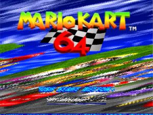

Styphelus Posted April 1, 2015 Posted April 1, 2015 I have a new problem that I think is Module related. Finally updated the modules in my setup and now when I start N64 with a Nintendo 64.cfg file in the config folder of Retroarch, my graphics get all messed up. If I setup my settings through hyperlaunch, than it seems fine. For some reason that i can't explain, having a preset config file messes everything up. Even starting up retroarch, loading a N64 game and saving a brand new config file will result in a mess when lunched through hyperlaunch. Also, Game Boy Advance has stopped working completely. Attempting to launch any game will result in Retroarch just crashing. Any ideas? Updating Retroarch to the latest nightlies did not help either.
