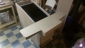

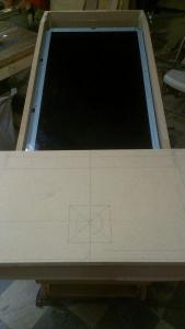

nitussi Posted December 13, 2012 Posted December 13, 2012 I like building vertical cabinets. I like building horizontal cabs.. I also want to attempt a pinball too. This one is big, about 50" from from the wall. It's kinda of a vertical and a horizontal ..well, you will have to just see it because it's kinda weird... Here is the CP I may use. It's a two player and my plan is to have USB ports on it for game pads if more players want to play ..not finished yet. Vertical Cab Mini Vertical Bartop Dual Impact W.I.P. Mini MvC cab Versus Bartop WIP

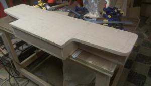

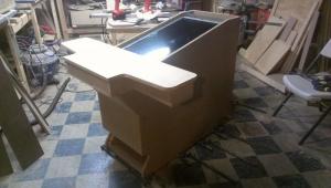

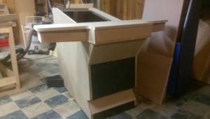

nitussi Posted December 13, 2012 Author Posted December 13, 2012 more... The sides. Yep it's weird ..hope it turns out right! Hera I cut a groove for the 1/4" tempered glass Vertical Cab Mini Vertical Bartop Dual Impact W.I.P. Mini MvC cab Versus Bartop WIP
ericleroi Posted December 13, 2012 Posted December 13, 2012 Sounds interesting/intriguing. Good luck with the build. The links don't work for me unfortunately - maybe it's just me though.

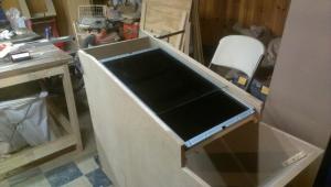

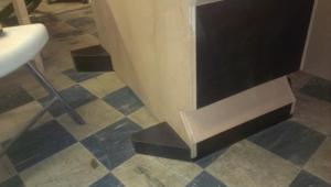

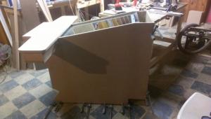

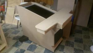

nitussi Posted December 13, 2012 Author Posted December 13, 2012 Coming together. Ok, 32" monitor and glass fits. Vertical Cab Mini Vertical Bartop Dual Impact W.I.P. Mini MvC cab Versus Bartop WIP

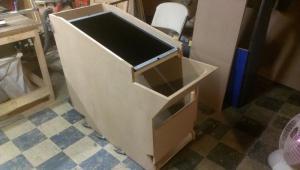

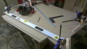

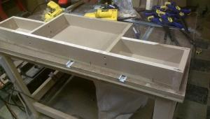

nitussi Posted December 13, 2012 Author Posted December 13, 2012 Dry fitting the CP that I might use. Oh, and there is also 42" monitor that goes with this; horizontally. Vertical Cab Mini Vertical Bartop Dual Impact W.I.P. Mini MvC cab Versus Bartop WIP

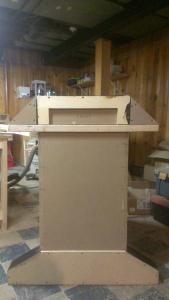

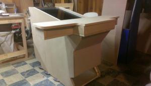

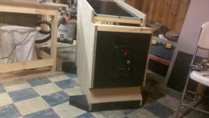

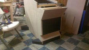

nitussi Posted December 15, 2012 Author Posted December 15, 2012 An update Rear stabilizer. Waiting on coin door and 42" to come in the mail. Cool! Do you have a art theme in mind? Unfortunately not yet. I'm very open to ideas though! I think I'm more concerned with the software, how I am going to get vertical/pinball games to display on the vertical 32" and horizontal games to display on the 42"? I would also like the other monitor to display something that pertains to whats being played on the other. For example, if I am playing Street Fighter on the horizontal it would be nice if the the vertical is displaying the game name or maybe info on the game; cabinets pictures, marquees, side artwork... Again open to any ideas! Vertical Cab Mini Vertical Bartop Dual Impact W.I.P. Mini MvC cab Versus Bartop WIP
mameshane Posted December 15, 2012 Posted December 15, 2012 this is a really cool idea, im looking forward to see where it goes. could you maybe set it up with 2 logins at windows, on for monitor a and the other for monitor b (pinball etc) then login a runs hyperspin set to the 42inch screen, and login b runs hyperpin for the pinball games? My Cab.. 1-UP ARCADE new hyperspin irc details.. come hang out!

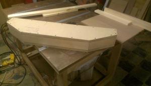

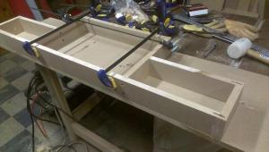

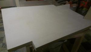

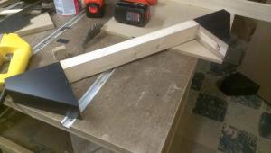

nitussi Posted December 17, 2012 Author Posted December 17, 2012 ok fellas, the "goose" has a 32" screen not a 46" like most digital pinball. It is only 19" wide and a decent two player bartop should be wider than that. had little time today, so I put together and laminated the front stabilizer. Vertical Cab Mini Vertical Bartop Dual Impact W.I.P. Mini MvC cab Versus Bartop WIP

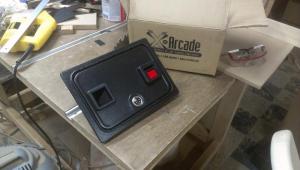

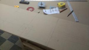

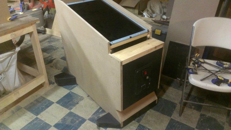

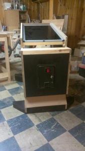

nitussi Posted December 19, 2012 Author Posted December 19, 2012 I had a spare hour or two, so I did a few more touches. Had to make a few changes to my original design and cut the front off.. Laying on it's back it's 42" tall. So far it's 42" deep, 19 1/2" wide, and 34" wide at the rear stabilizer. So it's really not big at all. Gave one of these x-arcade coin coin door a try. It includes a fully functional coin mech. Not bad for $30, plus they shipped it ground 8:30 PM yesterday and I got it 8:30 AM this morning. Still do not have the new 42" TV(shipping), so later on I will throw a 37" TV I have that's not being used on top of it to get a feel of how big the wooden frame gonna be around the top. Probably gonna test run Hyperspin and mame on it too. Oh yeah, and build that new CP. Vertical Cab Mini Vertical Bartop Dual Impact W.I.P. Mini MvC cab Versus Bartop WIP
nitussi Posted December 19, 2012 Author Posted December 19, 2012 How does the formica meet up with the t-molding? Laminate really just take the place of painting a side but it does take up about 1/16th of an inch or about 1.5mm--so if I do one side of a piece of wood I usually don't worry about the 1/16". But if I do both sides of a piece, then I buy the t-molding 1/8 of an inch larger or about 3 mm larger. Laminate is cut slightly larger than piece of wood it is going to cover. Once attached and the glue dried you take a router flush bit or laminate trim bit that rides on a bearing and flush the formica to the same size and shape of the wood. Vertical Cab Mini Vertical Bartop Dual Impact W.I.P. Mini MvC cab Versus Bartop WIP
