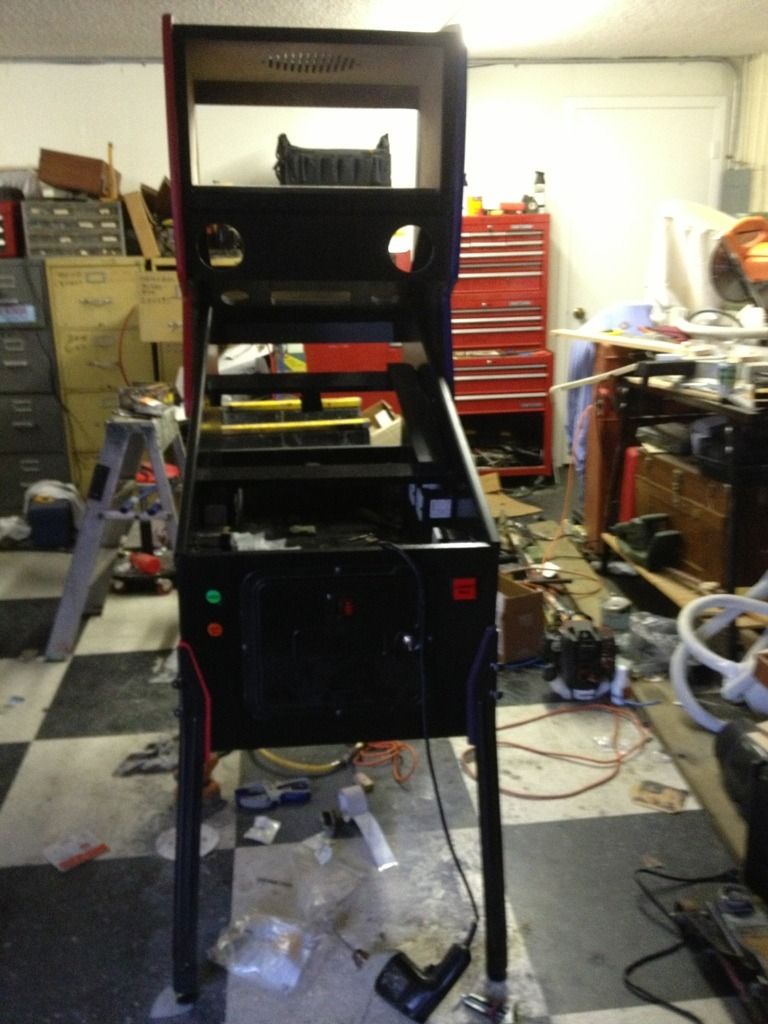

viriiguy Posted February 10, 2013 Author Posted February 10, 2013 Well I have my cabinet assembled and have satarted to put all the pieces into it. Unfortunately I broke my back glass monitor in the process. So I have found another one and have it ordered. Hopefully it gets here soon. In the meantime here is a picture.

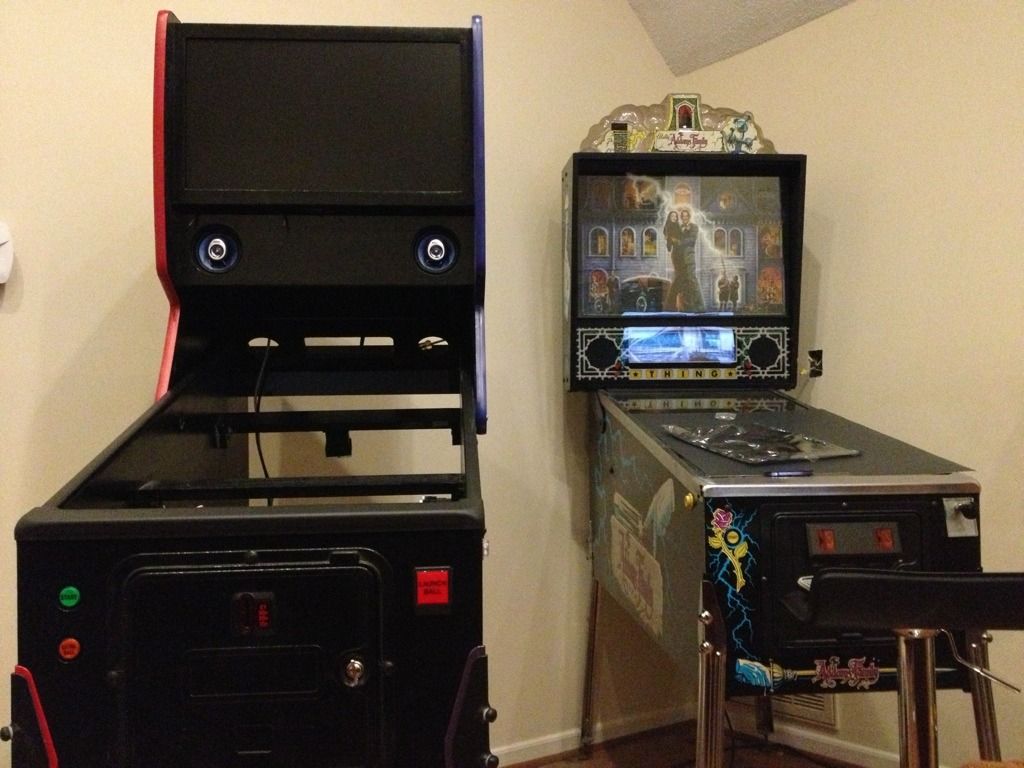

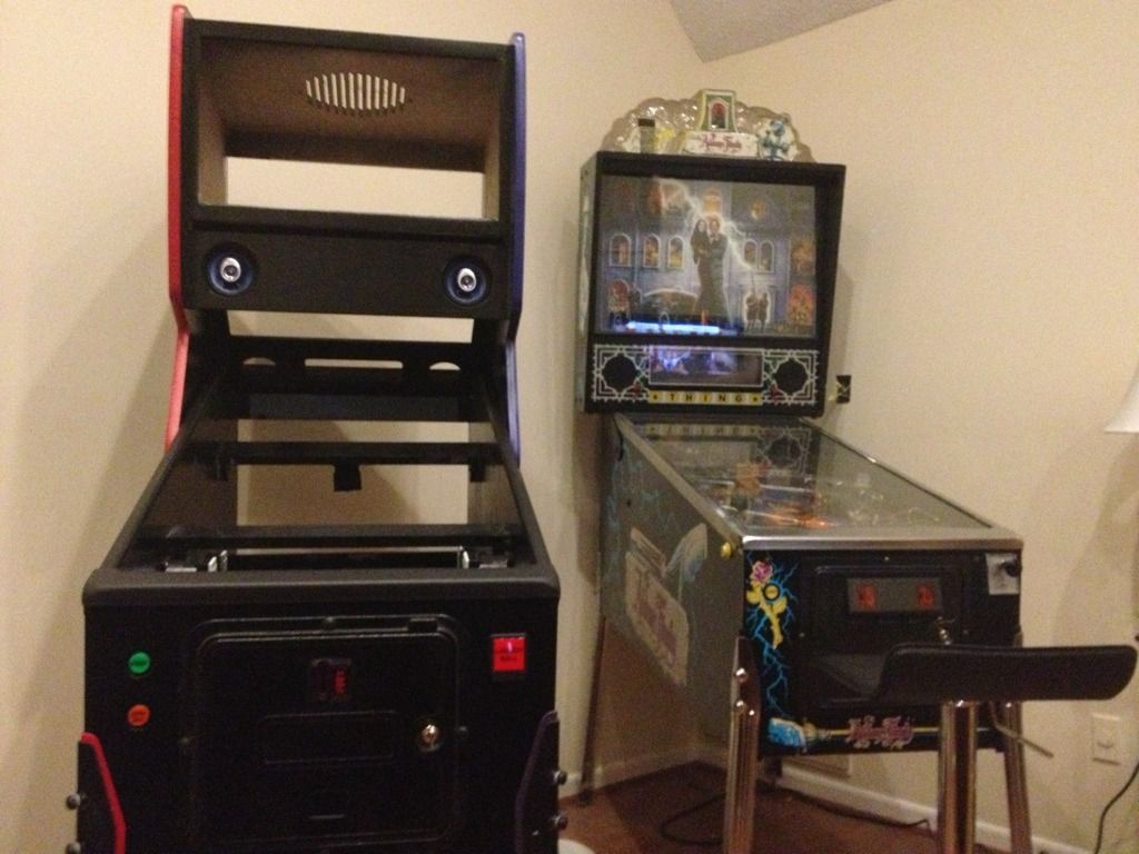

viriiguy Posted February 13, 2013 Author Posted February 13, 2013 Sure is nice to have the Cabinet inside the house! I did not get too much done.. Just moved it inside, mounted my lock bar receiver, the sub and speakers. But it sure looks good next to our Addams Family! I have to rearrange them a little, to make it fit better, but now I can work on it in the comfort of my home. And my replacement LCD for the back glass will be here tomorrow.
mameman Posted February 13, 2013 Posted February 13, 2013 Looking good, not sure if you tried it yet but the grill installs easiest in reverse by sliding the bottom between the back glass and speaker panel from underneath then rotating it through till its in place. PM me for any custom CNC needs. Find me on Facebook.. Xtreme Pinball or www.xtremepinball.com Ipad pinball cabinet iFlipper Here: See the Doctor Who build Here.... / See the Tron build Here.... / See the BattleStar Galactica build Here.... See the Big Bang Bar build Here.... / See the Twilight Zone build Here.... CNC Work Here.....
viriiguy Posted February 13, 2013 Author Posted February 13, 2013 No I haven't yet. But thanks! I was wondering how to install it. I am going to paint it this weekend and maybe trim the edges just a touch, so they do not dig into the paint as I slide it in. I was actually just searching for pics to see if I could find someone in the process of putting the grill on.

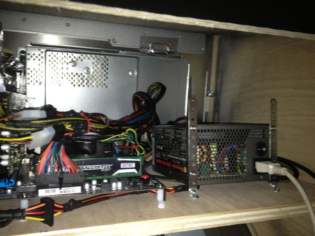

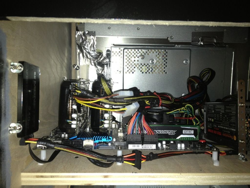

viriiguy Posted February 14, 2013 Author Posted February 14, 2013 I have two of the screens installed and I have the computer mounted in the head. I have to pick up some more brackets to mount the PS and the HDD. I am also working on a way to secure the video cards. Just a small update for today.

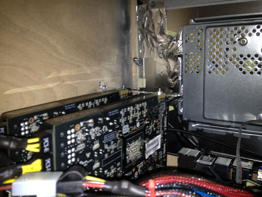

viriiguy Posted February 15, 2013 Author Posted February 15, 2013 Ok, I have the computer, power supply and HDD all mounted permanently now. I have had a couple of people ask how I was going to secure my video cards.. so here is how. I used Hillman bracket parts from the hardware isle in Lowes. ' Tomorrow I will have more time to work on it and will get power to the cabinet and start wiring up the rest.

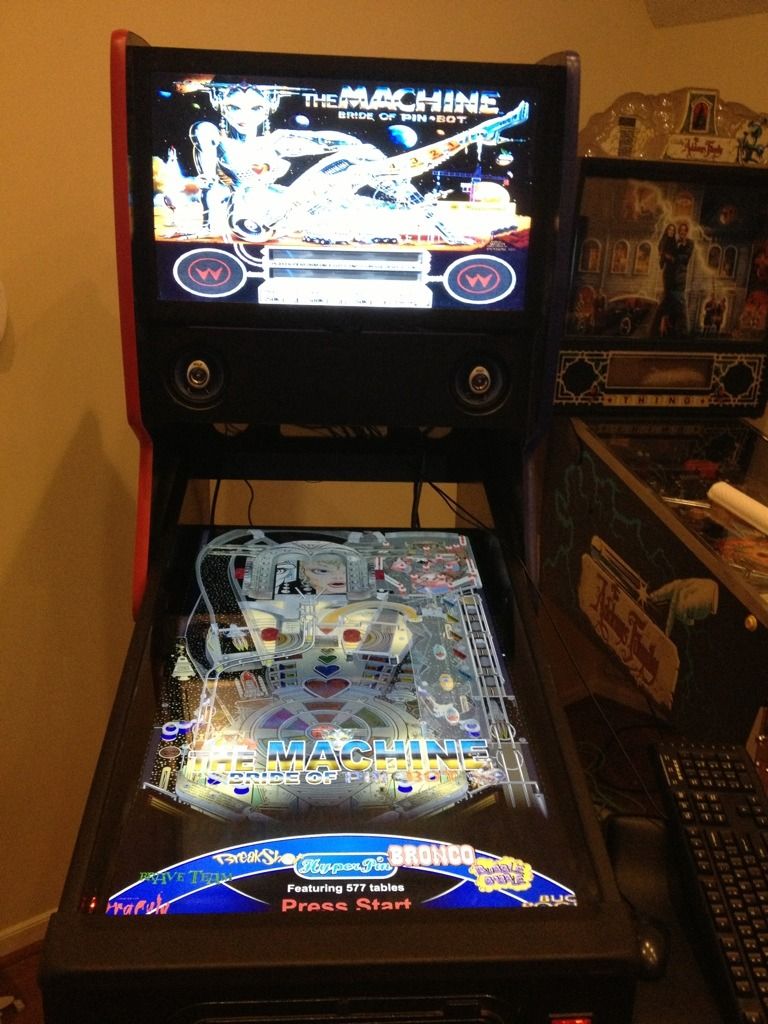

viriiguy Posted February 17, 2013 Author Posted February 17, 2013 We have a playable Pinball Machine!!! The force feedback is not hooked up, nor is the sub and speakers... but it works and is oh so much fun!!!
