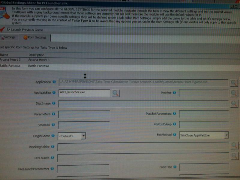

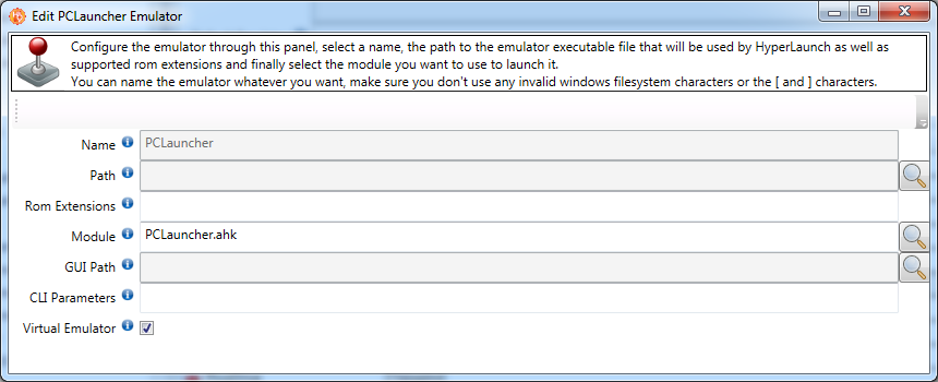

I just wanted to get clarification that Taito Type X is working fine in the New RocketLauncher...
In the PC Launcher.ini...I am pointing the script to the bat files
eg:
[super Street Fighter IV]
Application=C:\Hyperspin\Games\Taito Type X\Super Street Fighter IV\Super Street Fighter IV.bat
AppWaitExe=game.exe
I seem to be getting an issue where the game starts fine but after 20 seconds closes and the Hyperlaunch "now loading page appears"

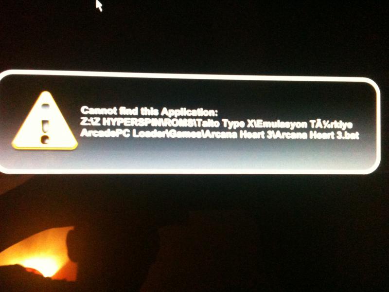

Ok thank you very much for your help i appriciate that, but my Games are always in red !
I think i missed something i will search my mistake
Not really simple at all :)
:deal:
The problem Is on your bat file name why it's Arcana Heart 3.bat.bat ?
Yes i change it cause i see a post who say i will need to creat bat file and name it ".bat " so yes (it was.bat.bat)
i make mistake the file was already a bat file, but same result my roms are red..
:deal:
The first one is right
The second put the game.exe file
And don't forget to put the exit method to : Winclose AppWaitExe

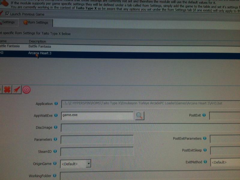

ok i've try this: post-85013-142870615086_thumb.jpg

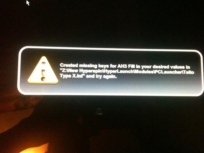

Hum i don't understand why the Taito. ini don't change, it keep my bat file..
:deal:
yes, game.exe/AH3_launcher/Arcana Heart 3.bat work outside..
It's so bad i can't take a look in the Wiki.. i'm sorry to take your time like that
i will try to find other tutorials on you tube as i say i think i miss something..

befor that make sure that the skipcheck is turned to Rom and emu only
by going to Setting tab scroll down you will find Skip Checks put it in rom only

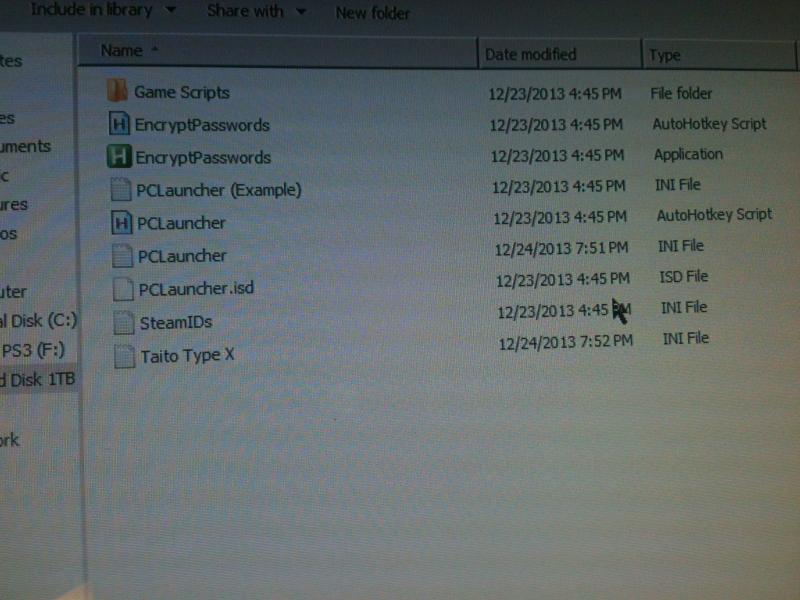

yes i changed it to Taito Type X.ini since the beginning
Should i need to download new file from djvj's FTP ? maybe i miss some file:

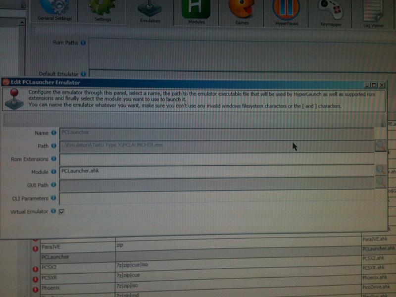

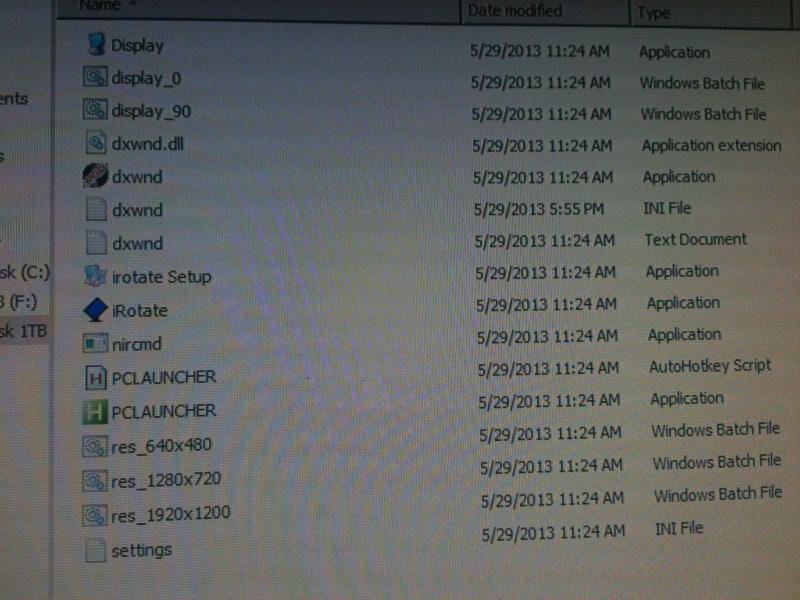

here is my pclauncher modules folder
here my Taito Type X emulator folder
yes it was check to false i check it to rom only my extention is good (bat/exe/lnk)

20:27:41:608 | MD |   DEBUG1  | +0     | StartModule - Setting romName to the dbName sent to HyperLaunch:
20:27:41:608 | MD |     INFO  | +0     | StartModule - Ended
20:27:41:608 | MD |     INFO  | +0     | StartGlobalUserFeatures - Starting
20:27:41:608 | MD |     INFO  | +0     | StartGlobalUserFeatures - Ending
20:27:41:608 | MD |     INFO  | +0     | Module Setting - PathToSteam: D:\Program Files (x86)\Steam
20:27:41:952 | MD |   DEBUG1  | +344   | ScriptError - Playing error sound: error6.mp3
20:27:43:818 | MD |    ERROR  | +1872  | Created missing keys for AH3 Fill in your desired values in "Z:\New Hyperspin\HyperLaunch\Modules\PCLauncher\Taito Type X.ini" and try again.
20:27:43:949 | HL |     INFO  | +2433  | Main - Module ended, exiting HyperLaunch normally
20:27:43:949 | HL |     INFO  | +0     | ExitScript - Started
20:27:43:949 | HL |   DEBUG1  | +0     | ExitScript - Putting HyperSpin.exe back in focus
20:27:43:949 | HL |     INFO  | +0     | SystemCursor - Restoring mouse cursor
20:27:43:949 | HL |     INFO  | +0     | ExitScript - Ended
Here is my Pclauncher edit:
Ayooob: yes i have set Skip Checks to rom and emu now :)
I'm gonna upgrade my Modules ect by the FTP
:deal:
Your PCLauncher Global should look like this, remove the path.
Remove a Rom path if you made that.
I am working on a video guide, which should be ready in a few weeks, I don't think there is an up to date guide on youtube.
