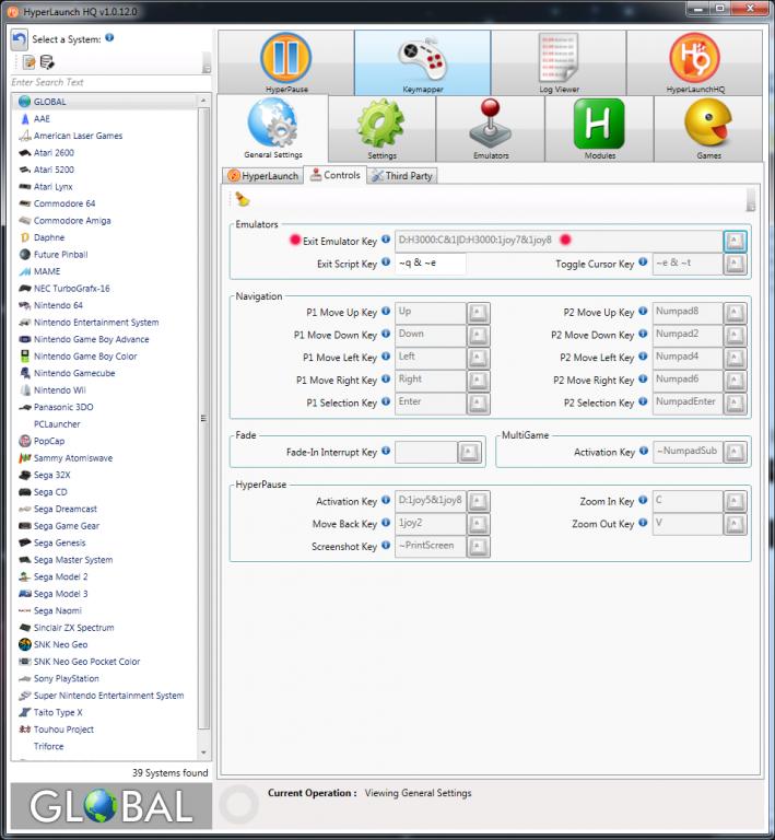

Gius3ppe Posted November 9, 2013 Posted November 9, 2013 Hi, My HyperSpin Exit Emulator Key : ~Esc|H100:1joy6&2joy6 I have a HS xPadder profile for the FrontEnd. I have tried to configure BBCS another time... Here a piece of my .ini : [blazBlue Continuum Shift] Application=H:\HYPERSPIN\EMULATORS\Taito Type X2\Games\BBCS\BlazBlue Continuum Shift.bat AppWaitExe=game.exe ExitMethod=WinClose AppWaitExe Here the BBCS .bat : typex_loader game.exe This game and the others Exit with the key choosed in controls game config but not with HS Exit emulator Key. No problem with all my others HS systems... Pleaaaase Help !

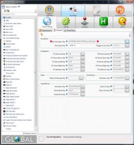

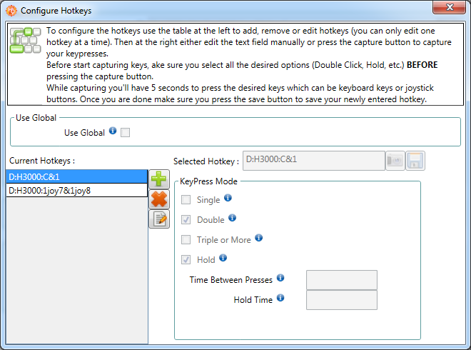

gigapig Posted November 9, 2013 Posted November 9, 2013 So you have Escape set and is that there just when you use a keyboard? And you have button 6 on each gamepad? Here are mine. I have both C & 1 set and buttons 7 & 8 on Joy 1.
Gius3ppe Posted November 9, 2013 Posted November 9, 2013 So you have Escape set and is that there just when you use a keyboard? YesAnd you have button 6 on each gamepad? Yes Here are mine. I have both C & 1 set and buttons 7 & 8 on Joy 1. Damned I have same config as your...

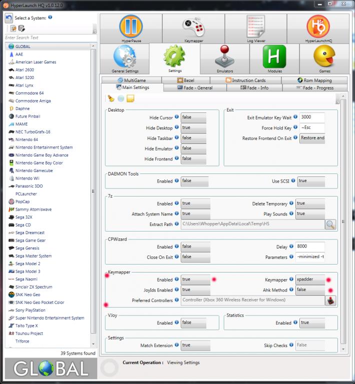

Gius3ppe Posted November 10, 2013 Posted November 10, 2013 So you have Escape set and is that there just when you use a keyboard? YesAnd you have button 6 on each gamepad? Yes Here are mine. I have both C & 1 set and buttons 7 & 8 on Joy 1. Damned I have same config as your... I have solved my problem doing new xPadder profiles... I have done a blank xPadder auto profile when windows starts, in this blank profile I have just assigned a Exit (Esc) emulator combo, then made a HyperSpin auto-profile that starts when HS starts but exit when my emulators starts... So my Taitos games Exit now ! Thanks for your help.
