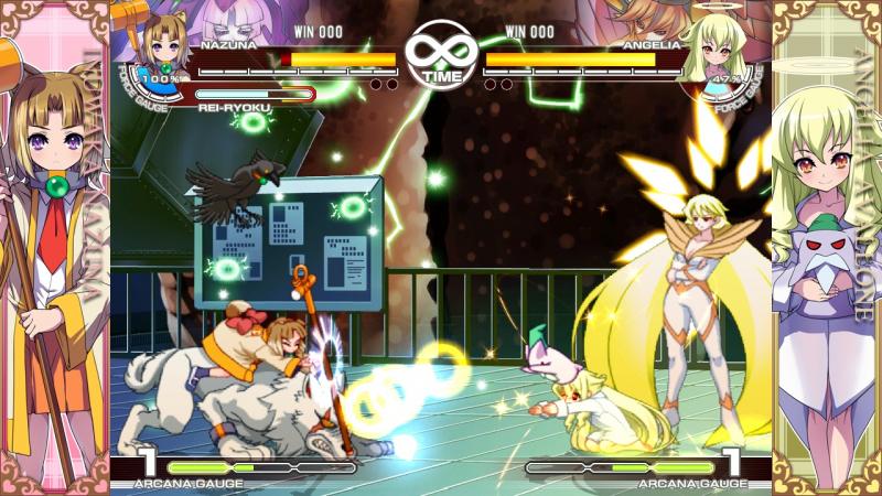

tonberryhunter Posted February 5, 2014 Posted February 5, 2014 Great work getting these games to work in Hyperspin. Is it possible to force the non widescreen games into 4:3? I am very ocd about correct aspect ratios. I'm running hyperspin on my custom built Vewlix cab at 1360x768. Doing testing on my desktop at 1080p. It would be neat to make custom Bezels like the console release of Arcana Heart 3 =^____^= UPDATE : Well it seems it was an issue with my monitor not auto switching to 4:3. I ran an HDMI to my Sammy Plasma and it auto switched to 4:3 when I loaded up Chaos Breaker for example. Hopefully the TV in my cab does something similar. TVs seem to be generally more versatile than computer monitors.
