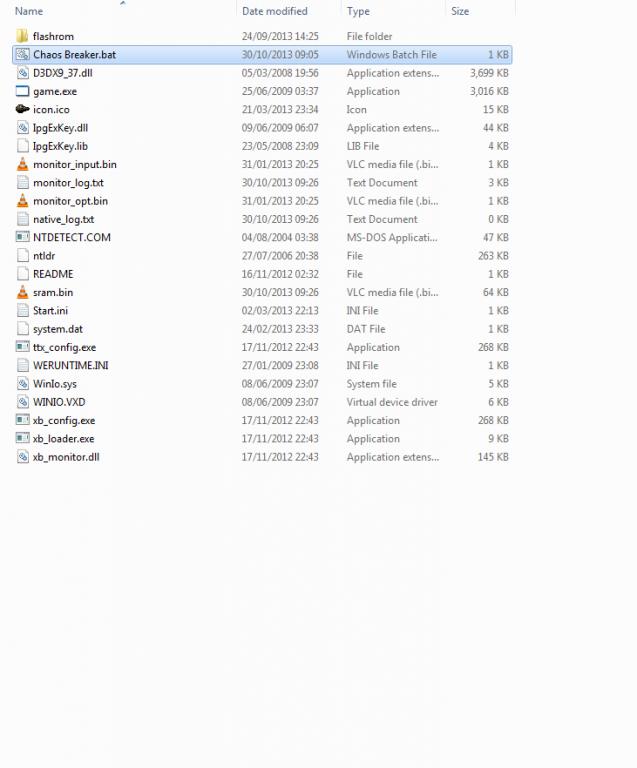

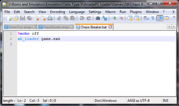

Deadly Posted October 30, 2013 Posted October 30, 2013 guys, just for clarity. there is no bat file with the daemon bride rom pack i have.When I rename db1.exe to game.exe and run xbloader, the screen frezes and doesnt progress past a white screen. The second image in my previous post. Using nvidia gfx card. The game won't run by DB1.exe alone. Just create a bat file with: xb_loader gamew.exe or xb_loader game.exe or xb_loader DB1.exe Whatever your EXE is called heh Also, not sure if that game requires a special DX file. The installation I have has D3DX9_37.dll along with the IPGexekey files. Maybe the other gents can confirm or deny they have/don't them.

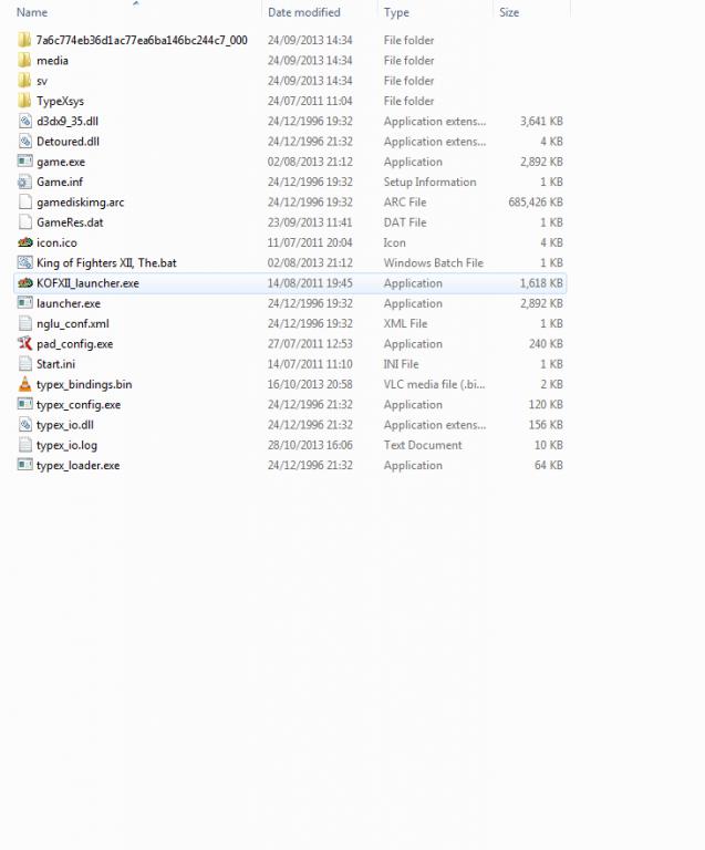

gigapig Posted October 30, 2013 Posted October 30, 2013 Just did that Deadly as a test, and it works fine, but mine works without it as well. But good to test it. I would like to no more about how and why the batch file does what it does. Is it just a way of running 2 or more programs consecutively? Here's my file structure.
TechnoFreek Posted October 30, 2013 Posted October 30, 2013 I have that dll and two IPG files in the rom pack I downloaded.
gigapig Posted October 30, 2013 Posted October 30, 2013 I have that dll and two IPG files in the rom pack I downloaded. Did you try knocking up a batch file as in picture 1?
TechnoFreek Posted October 30, 2013 Posted October 30, 2013 Daemon Bride up and running for me in Hyperlaunch & Hyperspin. Thanks guys! For reference I had to: Move all folders info new folder called flashrom Rename DB1.exe to game.exe (Also had to exclude this file from antivirus scanning) Create a db1.bat file Now, on to the next problem game!

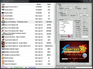

TechnoFreek Posted October 30, 2013 Posted October 30, 2013 ...which brings me to King of Fighters 12. Again, none of the bar or exe files actually launch the game. Can anyone clarify exactly what files I need to launch I am missing this file too KOFXII_launcher.exe

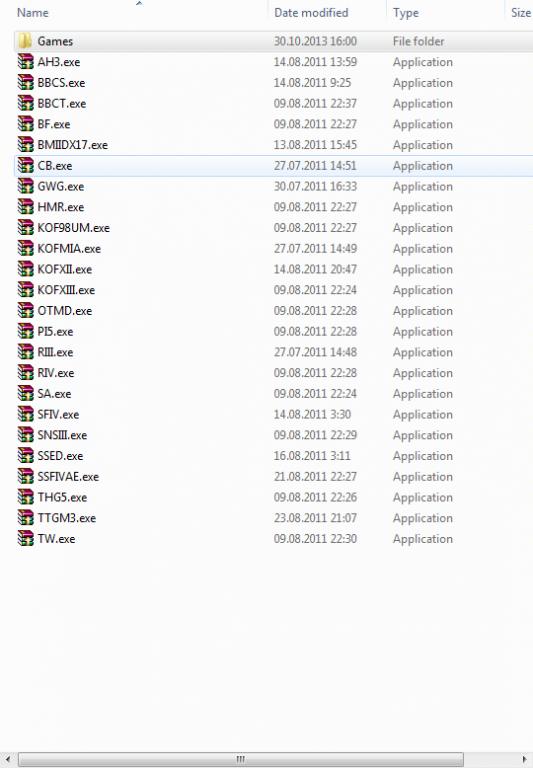

gigapig Posted October 30, 2013 Posted October 30, 2013 Is that launcher created by APCL? That one I run via djvj's bat file.
TechnoFreek Posted October 30, 2013 Posted October 30, 2013 Hmm. Interesting. In Aracde Pc Loader the game is listed but shows a red X. Double clicking and I get "Game is not found". A quick eyeball of your files and mine show all the same but I am missing that launcher file.

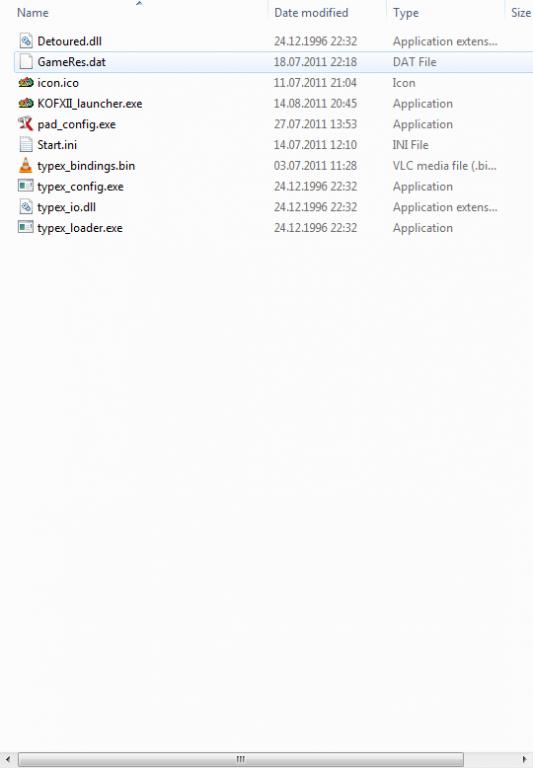

gigapig Posted October 30, 2013 Posted October 30, 2013 If you navigate to your APCL folder, then go to the services folder, you should see this. Find KOFXII.exe and double click it. It should create a folder, inside which you should find the launcher which you may be able the copy across to the main folder.

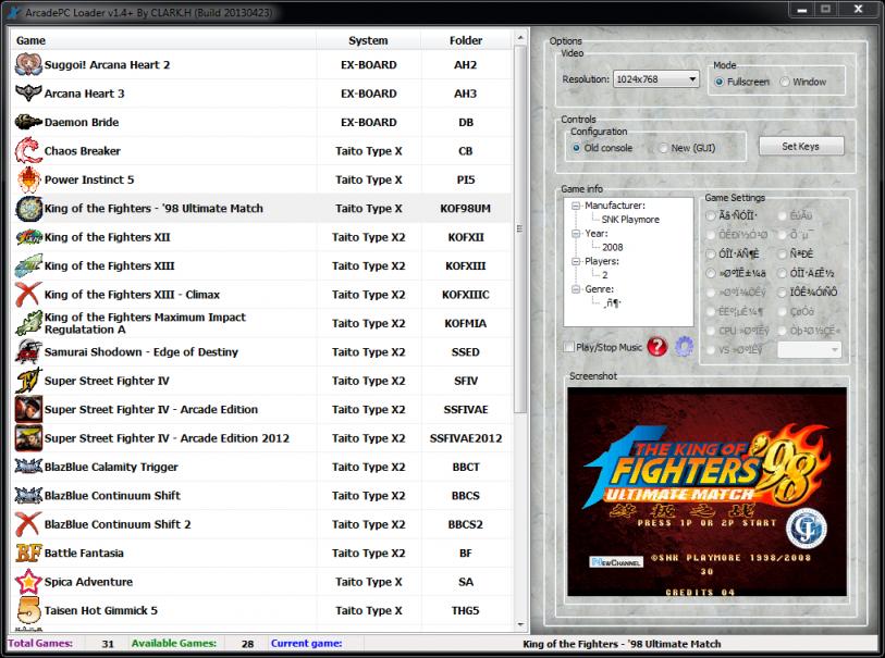

AYOOOB Posted October 30, 2013 Posted October 30, 2013 hello everybody guys How could i stretch KOF98UM Full screen image to fit the screen ? because every time i change the full screen resolution its still give the default resolution ? and if i cant do that , i heard about a way that you run the game in windowed mode then you remove the window frame then it looks like its a full screen , how could i do it on this way ?
TechnoFreek Posted October 30, 2013 Posted October 30, 2013 COpied those files across and djvj's stuff as well. DOuble clicking the bats does nothing. When I select the launcher I get a black full screen, low resolution but nothing after that. Appears to stay on black screen. Frozen. Have to Task Manager and end game.exe
TechnoFreek Posted October 30, 2013 Posted October 30, 2013 hello everybodyguys How could i stretch KOF98UM Full screen image to fit the screen ? because every time i change the full screen resolution its still give the default resolution ? and if i cant do that , i heard about a way that you run the game in windowed mode then you remove the window frame then it looks like its a full screen , how could i do it on this way ? I seem to get the same resolution no matter what resolution I set in the loader. You can set fullscreen in the arcade pc loader.
gigapig Posted October 30, 2013 Posted October 30, 2013 i know but it wont make it fit to screen What is your resolution?

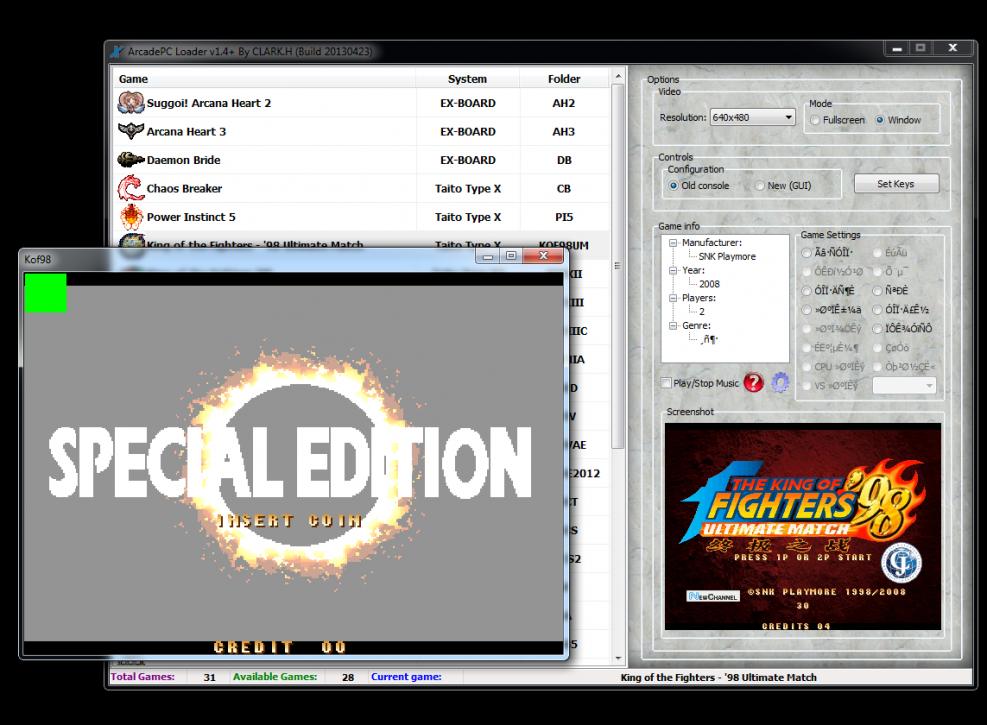

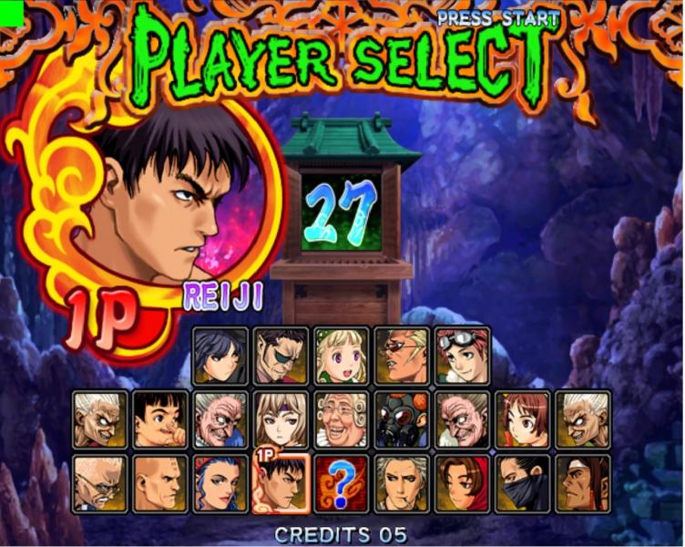

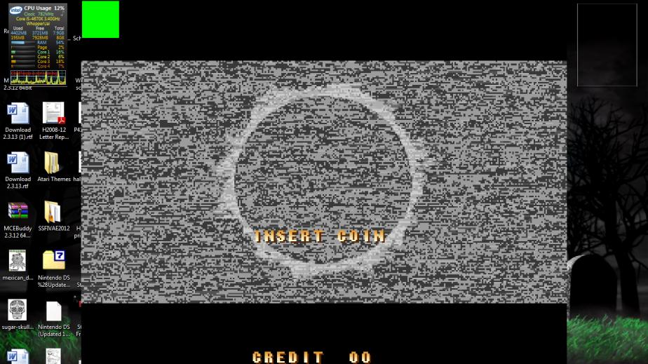

TechnoFreek Posted November 2, 2013 Posted November 2, 2013 Hey guys, PI5 up and running ok I think however I have this green square constantly in the top left corner. Any ideas?
AYOOOB Posted November 2, 2013 Posted November 2, 2013 i have this issue in KOF98UM also don't know why its like that
TechnoFreek Posted November 2, 2013 Posted November 2, 2013 i have this issue in KOF98UM also don't know why its like that Interestingly I don't have it with KOF98UM!
gigapig Posted November 2, 2013 Posted November 2, 2013 Sometimes a different exe will remove the dreaded green square. I had the same with RIV and swapping out the exe worked for that one. But other forces may be at work.

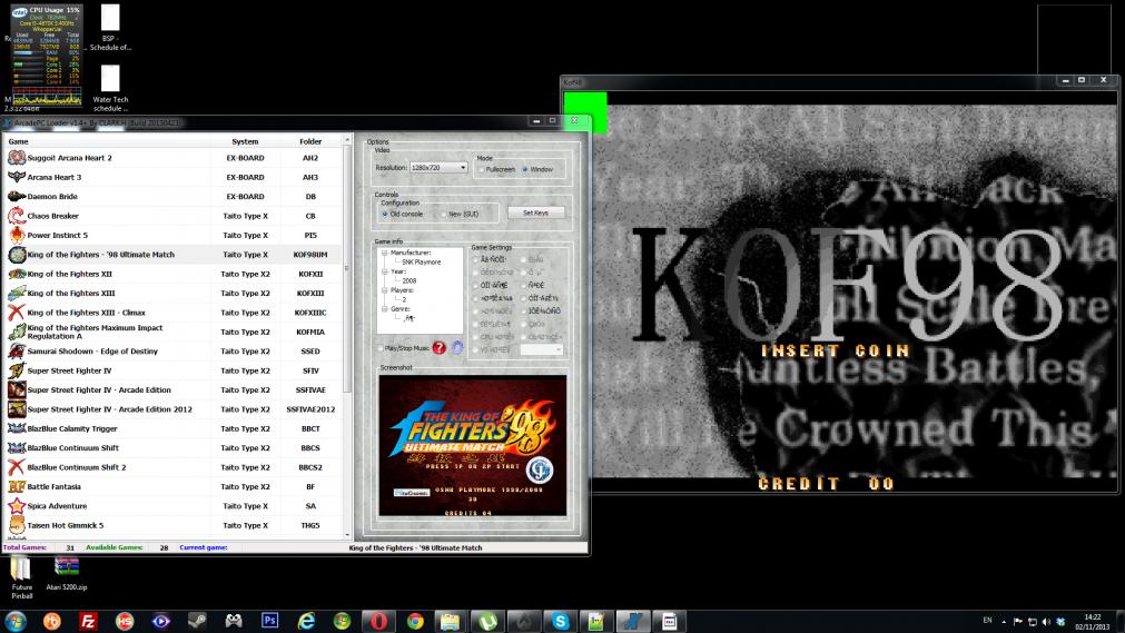

AYOOOB Posted November 2, 2013 Posted November 2, 2013 i want to know how to make KOF98UM to fit the screen even arcana heart has the same problem
gigapig Posted November 2, 2013 Posted November 2, 2013 i want to know how to make KOF98UM to fit the screen even arcana heart has the same problem Here's a bunch of resolutions and settings. The only way fullscreen works, on my setup (1920x1080) is setting the res to 1024x768, which is probably the games native res. 720 Windowed 640 windowed 1366 Fullscreen And these are the settings for proper fullscreen Running at Fullscreen (bloody green square)
AYOOOB Posted November 2, 2013 Posted November 2, 2013 but its not stretched to fit the screen , Why ?
