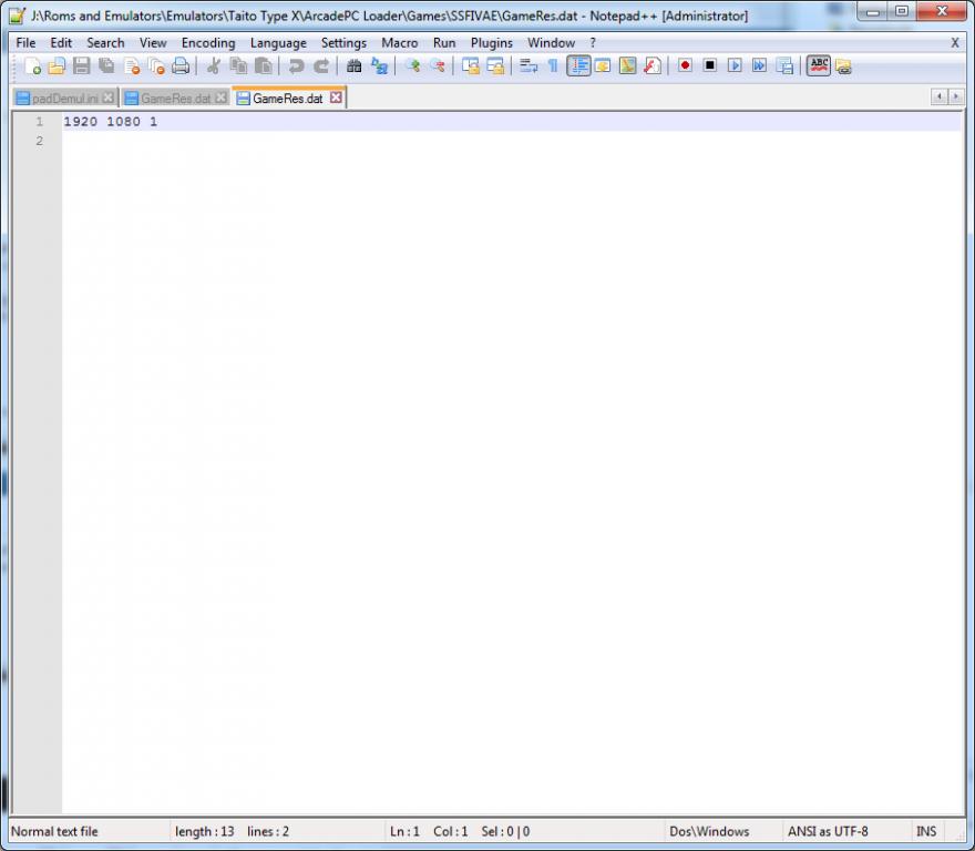

SpiderSpore Posted December 1, 2013 Posted December 1, 2013 another question for you gurus i modified Super Street Fighter IV - Arcade Edition so i can play with 2 players with the instructions from http://www.snk-neofighters.info/forum/showthread.php?10968-Arcade-PC-Super-Street-Fighter-IV-Arcade-Edition-Stand-alone-1-0-%28Taito-Type-X%C2%B2%29 it works but doesn't run at 1920x1080 any idea on how to change it
gigapig Posted December 1, 2013 Posted December 1, 2013 another question for you gurus i modified Super Street Fighter IV - Arcade Edition so i can play with 2 players with the instructions from http://www.snk-neofighters.info/forum/showthread.php?10968-Arcade-PC-Super-Street-Fighter-IV-Arcade-Edition-Stand-alone-1-0-%28Taito-Type-X%C2%B2%29it works but doesn't run at 1920x1080 any idea on how to change it Have a look for a file called GameRes.dat. Open it with Notepad++ and you should wee the resolution. I don't know if changing it makes a difference. Of the 3 versions of SSFIVAE I have, 2 have that file and they are both different. One is 720, the other 1080.
SpiderSpore Posted December 1, 2013 Posted December 1, 2013 i opened that file its says 1920 1080 1 seems its set to 1080p but it doesn't run at that when i load the game you do have to use a special launcher for 2 player though maybe its something to do with that
gigapig Posted December 1, 2013 Posted December 1, 2013 i opened that file its says 1920 1080 1 seems its set to 1080p but it doesn't run at that when i load the game you do have to use a special launcher for 2 player though maybe its something to do with that Are you using a tool to show the Res? How can you tell? Thanks.
SpiderSpore Posted December 1, 2013 Posted December 1, 2013 Are you using a tool to show the Res? How can you tell? Thanks. No Tool its obvious its running lower res i also have a copy of the game that runs at 1080p fine using the launcher ArcadePC Loader creates i compared it to that as well
