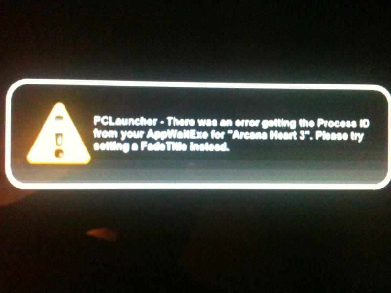

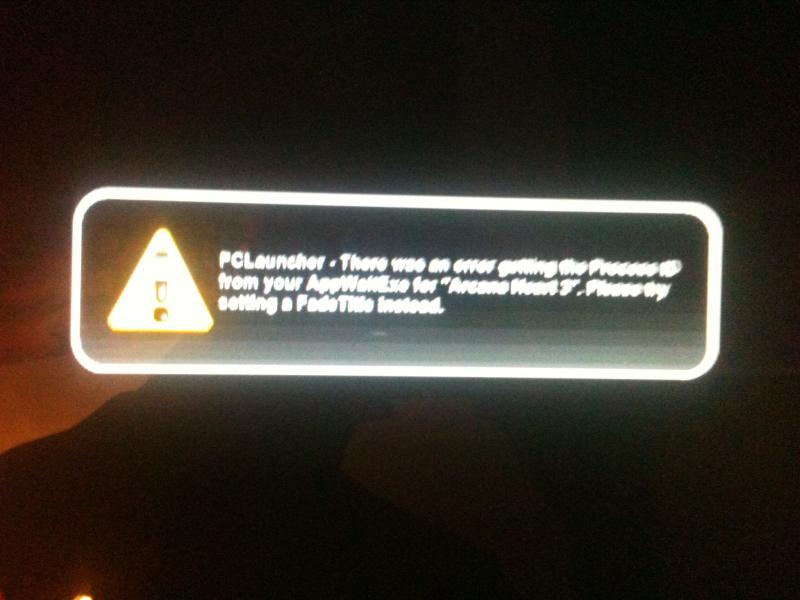

I just wanted to get clarification that Taito Type X is working fine in the New RocketLauncher...
In the PC Launcher.ini...I am pointing the script to the bat files
eg:
[super Street Fighter IV]
Application=C:\Hyperspin\Games\Taito Type X\Super Street Fighter IV\Super Street Fighter IV.bat
AppWaitExe=game.exe
I seem to be getting an issue where the game starts fine but after 20 seconds closes and the Hyperlaunch "now loading page appears"

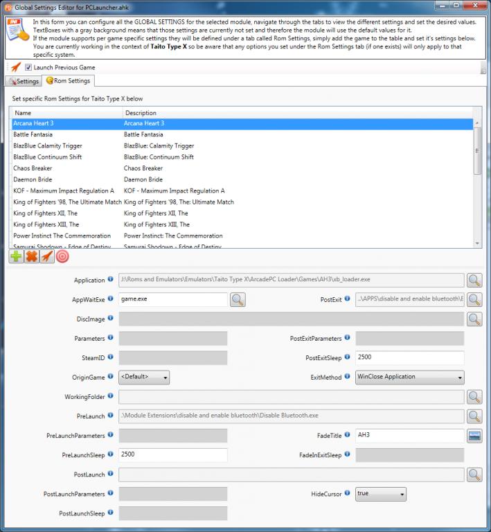

To make things easy, all settings are added here, but you can edit the PCLauncher.ini
I will post mine if it helps.
I have lighted the TTX section.

[b][color="#FF0000"][Arcana Heart 3]
Application=J:\Roms and Emulators\Emulators\Taito Type X\ArcadePC Loader\Games\AH3\xb_loader.exe
AppWaitExe=game.exe
FadeTitle=AH3
PostExit=..\APPS\disable and enable bluetooth\Enable Bluetooth v2.exe
HideCursor=true
ExitMethod=WinClose Application
PreLaunch=.\Module Extensions\disable and enable bluetooth\Disable Bluetooth.exe
PreLaunchSleep=2500
PostExitSleep=2500

Your PCLauncher Global should look like this, remove the path.
Remove a Rom path if you made that.
[ATTACH=CONFIG]36489[/ATTACH]

YESS !! it was that i have deleted my PClauncher and Make a new one like yours and here is everything work now !! :D
i see the complete list of my game and Arcana Heart Finaly launching ! thank you GUYS !!
i have just 1 error during the script i think i can set it in fade.. lol but my roms are always in red but work so ??
:deal:
It does not matter that your games show up in red, they are not Roms. Mine are red also.
The fade title for Arcana Heart 3 is "AH3" you will find the other fade titles on page 1 or 2 of this thread, on the wiki or on my PC launcher ini.
Thank you so mush Guys it was a pain to understand how RocketLauncher work with PC game ! :stupido:

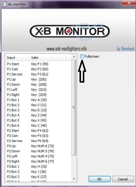

Did you tick the full-screen option in xb_config?
When I use that option the game try to launch then disappear.
Thanks for the help anyways :) .. this is the worst "system" to configure, it can be done but is a pita!
