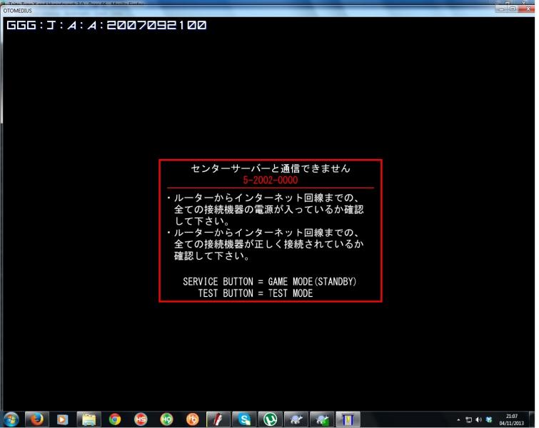

TechnoFreek Posted November 4, 2013 Posted November 4, 2013 Trying to get Otomedius to launch. Using the launcher exe I get here and can't get any further. It's also not going fullscreen and only seems to respond to pressing Escape.
gigapig Posted November 4, 2013 Posted November 4, 2013 Trying to get Otomedius to launch. Using the launcher exe I get here and can't get any further. It's also not going fullscreen and only seems to respond to pressing Escape.[ATTACH=CONFIG]34270[/ATTACH] Firstly I don't have a green square on PI5 so you could try my game.exe. Did you try different exe's for Matrimelee Matsuri aka PI5? Otomedius is a very tricky beast. You need an F drive, if you don't have one you can create one with a flash drive. Once that is done you need to get into the menu and turn off the E-Amusement inthe network settings. Get to the menu by pressing F6 and use F7 to move the cursor. You will also need a mouse to click menu items in the game.

TechnoFreek Posted November 5, 2013 Posted November 5, 2013 got Otomedius working. Havent really configured the controls but needing the mouse kind of rules out the game ran through my cab. Giga, be interested in your PI5 game.exe!
gigapig Posted November 5, 2013 Posted November 5, 2013 got Otomedius working. Havent really configured the controls but needing the mouse kind of rules out the game ran through my cab. Unless you have a trackball.
