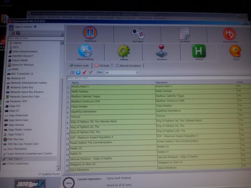

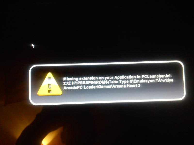

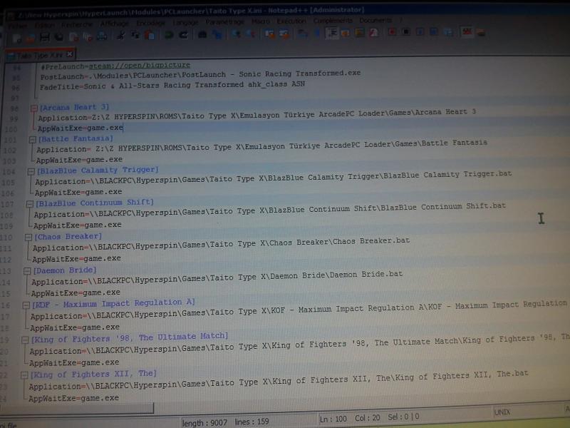

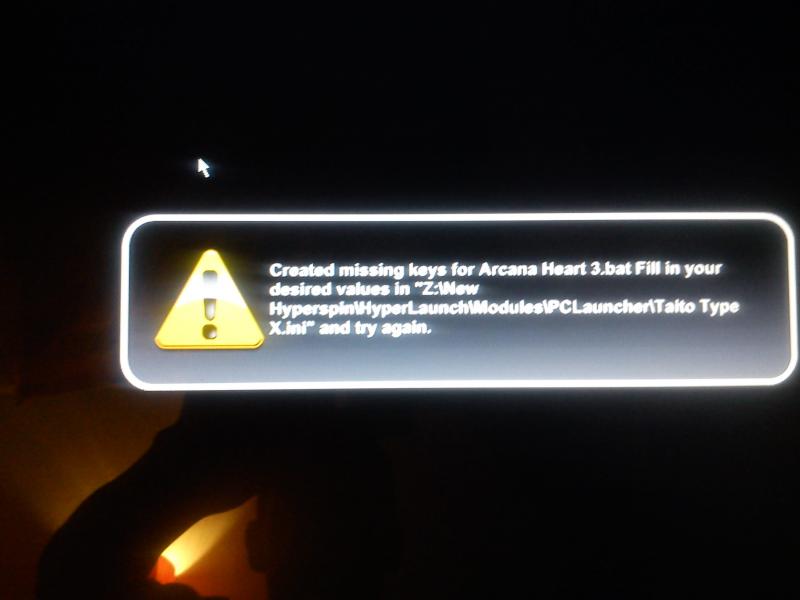

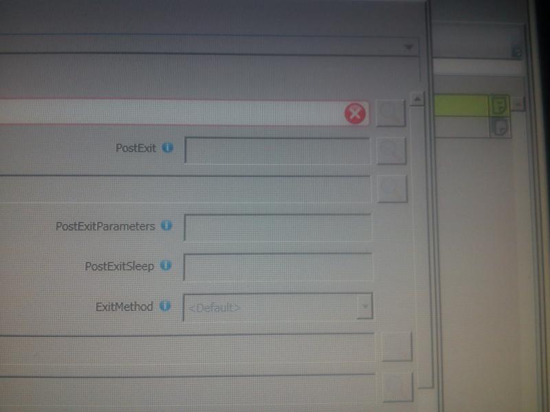

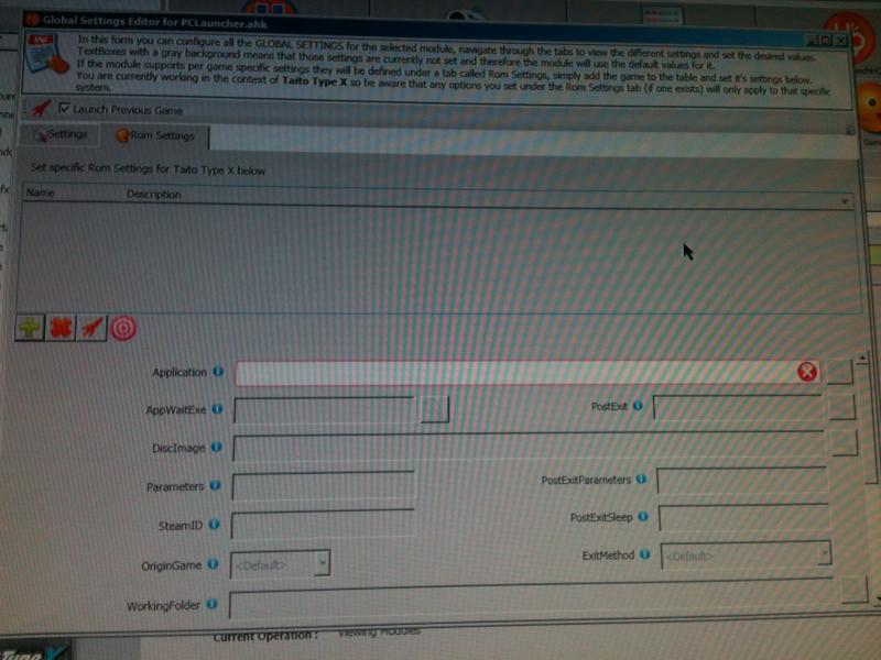

Bruce Lee Posted December 24, 2013 Posted December 24, 2013 Hi everyone I'm trying to find any help to make Taito Type X working on RocketLauncher I will show Step by step what i do So 1st I've just update My Hyperlaunch 2.25 to RocketLauncher few days ago.. everything working properly with 80 system on HL 2.25 so i decided to upgrade with HL 3 I have keep my old Taito Type X .XML here is my HL 3 and ini screen at this time. I've seen everything is green, so i tried to launch AH3 and i had this error.. i've changed My file in bat ex: Arcana Heart 3 to Arcana Heart 3.bat and change the path in ini too. i get this screen, with this time a red line and an other error ?? Any help will be really appriciate cause i will become crazy, thanks in advance !

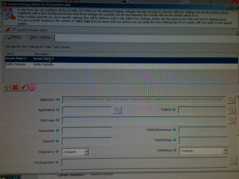

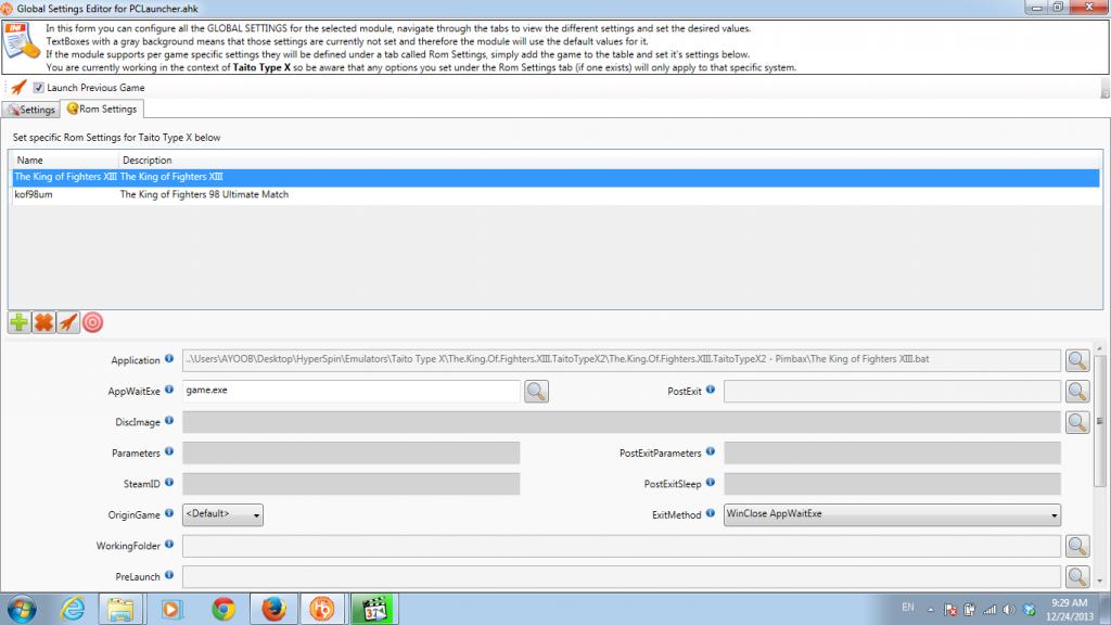

AYOOOB Posted December 24, 2013 Posted December 24, 2013 did you used the rom settings in global module setting for pcLauncher ?
Bruce Lee Posted December 24, 2013 Posted December 24, 2013 Ok thanks, no i do not use global module setting the menu Rom setting is locked, i use the rom paths.. i've seen this video but it's for steam so i don't know if it's work for Taito Type X :
AYOOOB Posted December 24, 2013 Posted December 24, 2013 go to the module tab and select pcLauncher module and then click global module settings the edit the rom settings its not locked put you cursor on a grey line and drag it down
AYOOOB Posted December 24, 2013 Posted December 24, 2013 and about the video i think its the same method i am not sure
Bruce Lee Posted December 24, 2013 Posted December 24, 2013 go to the module tab and select pcLauncher module and then click global module settings the edit the rom settingsits not locked put you cursor on a grey line and drag it down Ok i've try what you said, as you can see, the magnifying glass is lock i can't tilt it and edit the rom setting..
Bruce Lee Posted December 24, 2013 Posted December 24, 2013 go to the module tab and select pcLauncher module and then click global module settings the edit the rom settingsits not locked put you cursor on a grey line and drag it down Ah ok sorry i see it now thank you ! yes just need to drag it down..
AYOOOB Posted December 24, 2013 Posted December 24, 2013 do you have somthing like this if not as i said you should drag it

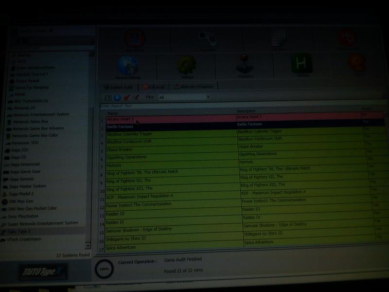

Bruce Lee Posted December 24, 2013 Posted December 24, 2013 do you have somthing like this [ATTACH=CONFIG]36479[/ATTACH] if not as i said you should drag it Yes here is i have it thanks Ok i will try set it now, but just one thing all my rom are Red i need to set the rom paths in the emulator section ? i see somewhere someone tell we do not need the rom paths in this section
