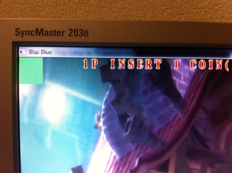

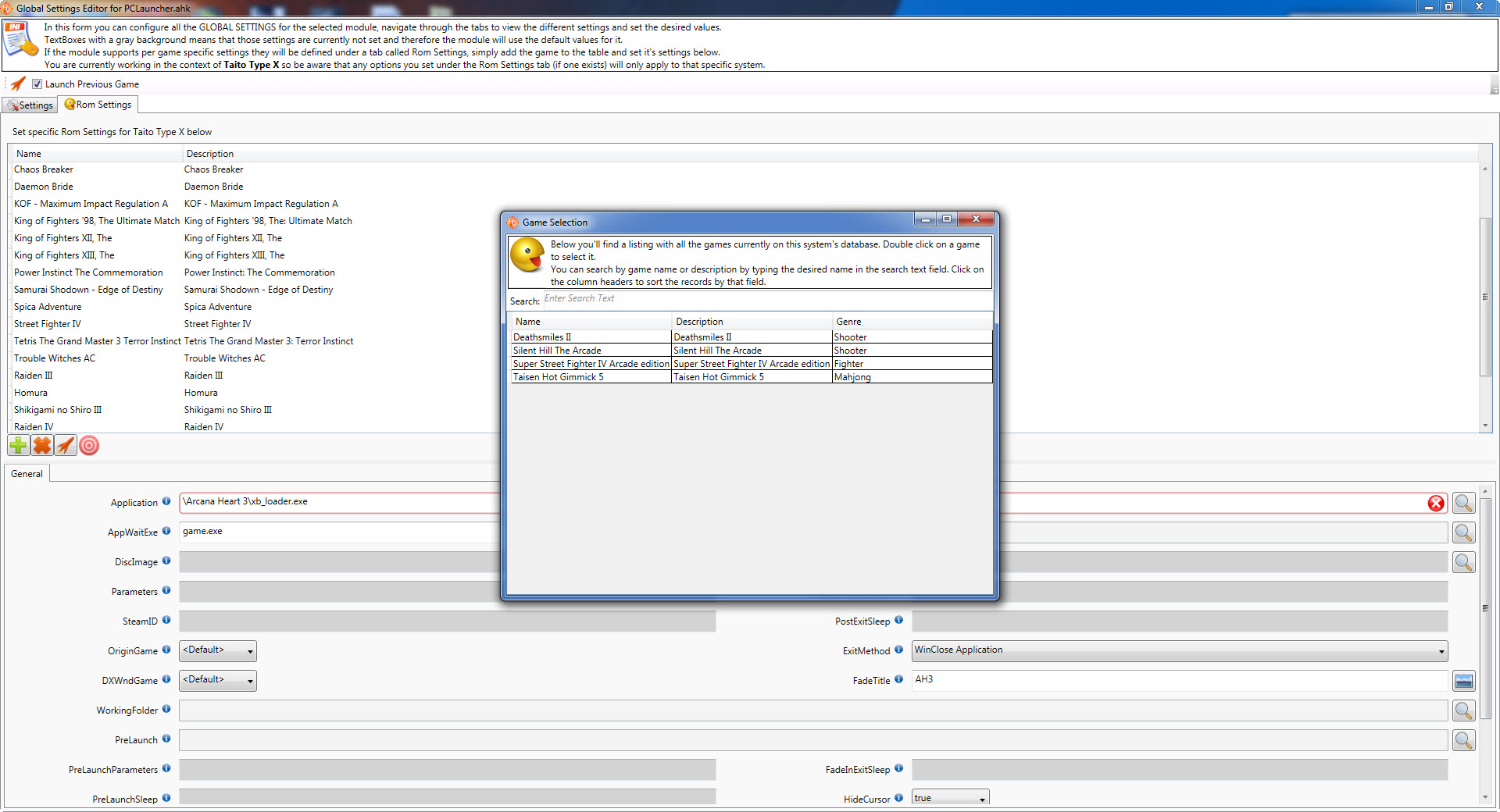

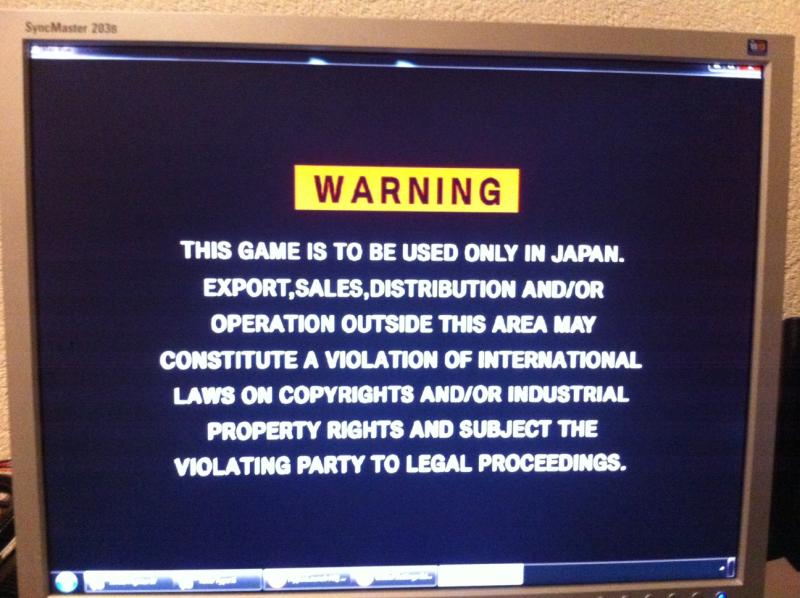

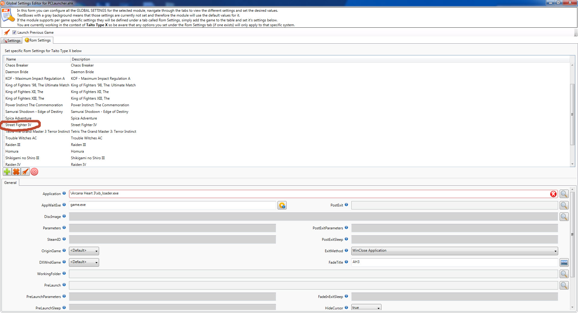

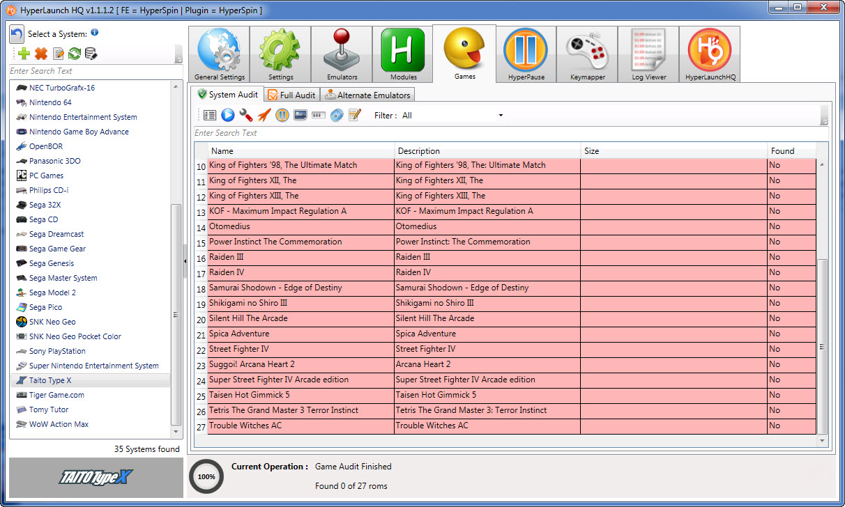

This pic is SFiv it hangs 2 minutes......then it starts, i try to put the settings correct, like you told me...but the where already set like that.
i see its the 1 player (is that the problem)?

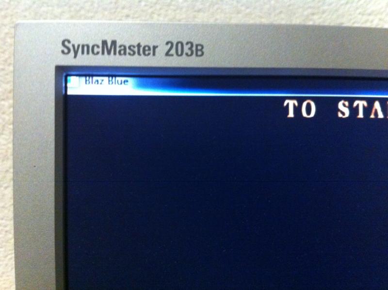

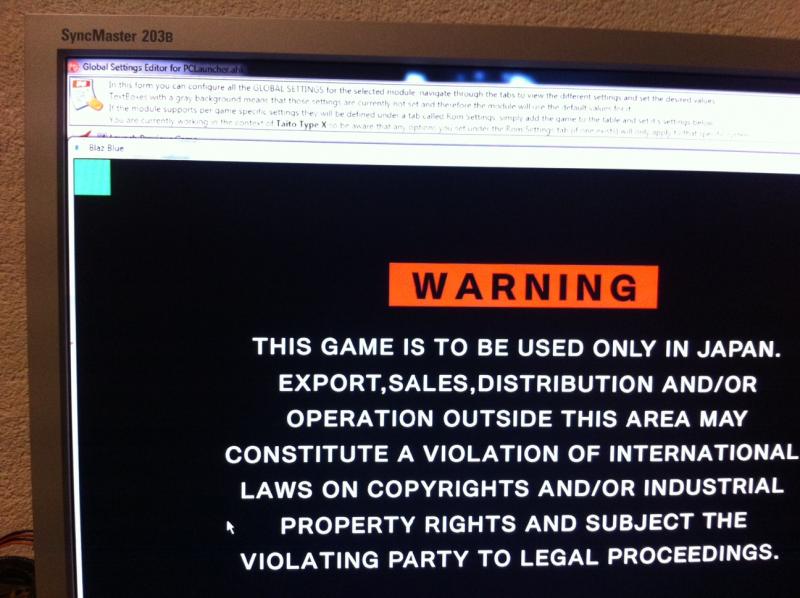

and here are the others, the bezels where off, i put them on, in the main setting of HL for ttx. no difference:(
pic 1 & 2 are BBCT and 3 & 4 are BBCS, those 2 are the only 2 with have this problem.... i tried everything(i think;-))
Ok that's familiar, you'll need to use a different loader which you can find here.
You'll need to grab 158 game loader and extract Game Loader All RH into each game folder, you may also need ttx_config2.0 as well to set controls.
When you run Game Loader All RH it creates an ini file called TTX.ini where you can set it up. I have supplied one for you to give the best image quality, but if it causes you trouble just delete it and run the loader again.
TTX.zip
you're the MAN GIGA:D this did the trick.. btw the ttx did complete nothing but a error and black screen. but thank you for trying to give me a nice image quality!

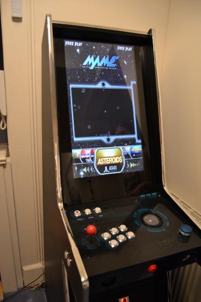

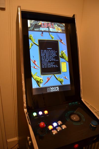

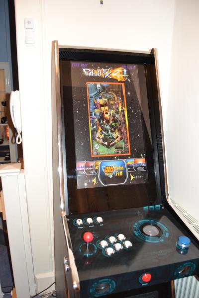

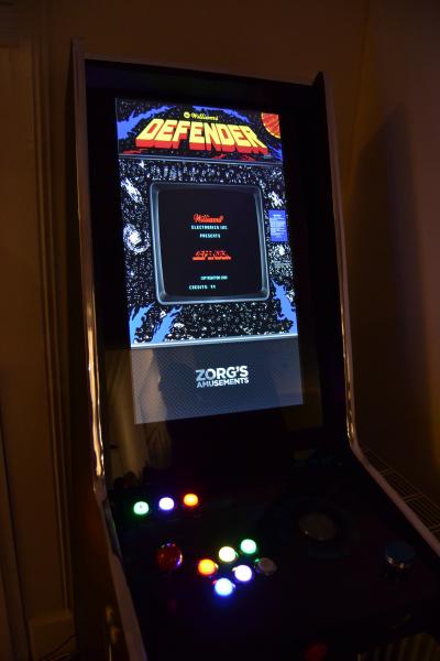

Hi all,
I have all my taito type x games set up fine on my bartop arcade. I am just building a vertical arcade cabinet and want to setup a few in full screen vertical mode. Can anyone help me change / stop the rotation of games when launched and also how do you change the resolution of the games ?
Monitor running in Landscape and 1920x1080
Thanks
You can probably just use djvjs' files in his ftp for the vertical games without rotation. Drop them in the game folder and point to the bat file via the PCLauncher module.
If it upside down "someone" ;) may be able to supply a script to flip it the other way.
Resolution is a bit varied between the games, some have a file called Gameres.dat or another which name escapes me atm, or some can't be changed as far as I know; like Arcana Heart 3.
You can add different exe's for HD but you may need to use Game Loader All RH with those.

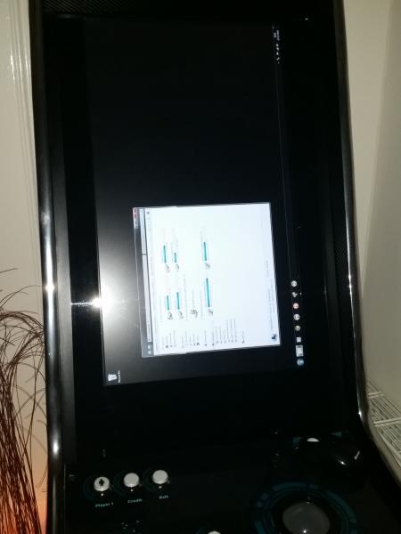

I have a dedicated vertical cab as well, IIRC all of those game launched in portrait mode as a default. if they're trying to rotate you might have some other script running that's doing that.
How is your windows desktop setup? I found that nearly all of my games and emulators were happiest with windows NOT rotated (so it looked sideways on your vertical screen). Hyperspin itself seems to be the only app that doesn't like that.
Hi Yes mine is like the screen below. I'll need to play around with it to get some of these taito type x games running correctly.
I've got mame, pinball fx2 and future pinball all set up so far and have been making bezels for the mame artwork as well, done 50+ so far for mame artwork bezels

AppWaitExe=game.exe
FadeTitle=TGM3 - Copyright (C) Arika Co., Ltd - 2004-2005 (Jan 30 2005 17:52:56)
ExitMethod=WinClose Application
[Trouble Witches AC]
Application=\Trouble Witches AC\Trouble Witches AC.bat
AppWaitExe=game.exe
FadeTitle=
[Raiden III]
Application=..\Emulators\Taito Type X\Raiden III\Raiden III.exe
AppWaitExe=game.exe
FadeTitle=(C)2005 MOSS LTD ALL RIGHTS RESERVED.
[Homura]
Application=\Homura\Homura.exe
AppWaitExe=game.exe
FadeTitle=HOMURA for TypeX
[shikigami no Shiro III]
Application=\Shikigami no Shiro III\Shikigami no Shiro III.exe
AppWaitExe=game.exe
FadeTitle=SHIKIGAMI NO SHIRO3
[Raiden IV]
Application=\Raiden IV\Raiden IV.exe
AppWaitExe=game.exe
FadeTitle=RAIDEN 4 (C)2007 MOSS LTD ALL RIGHTS RESERVED.
[GigaWing Generations]
Application=\GigaWing Generations\GigaWing Generations.exe
AppWaitExe=game.exe
FadeTitle=YOKUSHIN
[suggoi! Arcana Heart 2]
Application=\Suggoi! Arcana Heart 2\xb_loader.exe
AppWaitExe=game.exe
FadeTitle=AH2
[Otomedius]
Application=\Otomedius\OTMD_Launcher.exe
AppWaitExe=otomedius.exe

It's definatly in your PCLauncher.ini, can you launch it from HyperSpin or even from an audit? Is it at the bottom of the list and you can't scroll down?
When I do an audit I get the red screen which means none of them will launch (Obviously) but I am able to launch them from the global settings/romsettings tab. I have not come up with a solution for this either. I watched your video three times maybe you can get specific or in depth about how I can make sure my games will audit properly and most importantly how to get SSFIVAE in the rom settings list. Hyperspin won't play it due to this. This is ironically, the first game I got working in Taito Type X outside of HL.
I can launch them in this screenshot below.
But did you notice that Super Street Fighter IV Arcade Edition is not in my list (Set specific Rom Settings.) I get the screen below after pressing the big green plus sign, that allows me to load up Super Street Fighter IV after double clicking it in the list, in the middle of the pic below. It adds SSFIVAE to the list and I can even launch from here but then it disappears every time I close HyperLaunchHQ or even select another system on the left, then going back to Taito Type X system. How can I fix this issue?

</game>
<game name="King of Fighters XII, The" index="" image="">
	<description>King of Fighters XII, The</description>
	<cloneof></cloneof>
	<crc></crc>
	<manufacturer>SNK Playmore</manufacturer>
	<year>2009</year>
	<genre>Fighter</genre>
	<rating>AAMA - Yellow (Animated Violence Mild)</rating>
	<enabled>Yes</enabled>
</game>
<game name="King of Fighters XIII, The" index="" image="">
	<description>King of Fighters XIII, The</description>
	<cloneof></cloneof>
	<crc></crc>
	<year>2010</year>
</game>
<game name="Otomedius" index="" image="">
	<description>Otomedius</description>
	<cloneof></cloneof>
	<crc></crc>
	<manufacturer>Konami</manufacturer>
	<year>2007</year>
	<genre>Shooter</genre>
	<rating>AAMA - Green (Suitable For All Ages)</rating>
</game>
<game name="Power Instinct The Commemoration" index="true" image="p">
	<description>Power Instinct: The Commemoration</description>
	<cloneof></cloneof>
	<crc></crc>
	<manufacturer>Atlus</manufacturer>
	<year>2009</year>
</game>
<game name="Raiden III" index="true" image="r">
	<description>Raiden III</description>
	<cloneof></cloneof>
	<crc></crc>
	<manufacturer>Moss</manufacturer>
	<year>2005</year>
</game>
<game name="Raiden IV" index="" image="">
	<description>Raiden IV</description>
	<cloneof></cloneof>
	<crc></crc>
	<year>2007</year>
</game>
<game name="Samurai Shodown - Edge of Destiny" index="true" image="s">
	<description>Samurai Shodown - Edge of Destiny</description>
	<cloneof></cloneof>
	<crc></crc>
	<year>2008</year>
</game>
<game name="Shikigami no Shiro III" index="" image="">
	<description>Shikigami no Shiro III</description>
	<cloneof></cloneof>
	<crc></crc>
	<manufacturer>Alfa System / Skonec</manufacturer>
	<year>2006</year>
</game>
	<game name="Silent Hill The Arcade" index="" image="">
	<description>Silent Hill The Arcade</description>
	<cloneof></cloneof>
	<crc></crc>
	<year>2007</year>
</game>
<game name="Spica Adventure" index="" image="">
	<description>Spica Adventure</description>
	<cloneof></cloneof>
	<crc></crc>
	<manufacturer>Arc</manufacturer>
	<year>2005</year>
	<genre>Platform</genre>
</game>
<game name="Street Fighter IV" index="" image="">
	<description>Street Fighter IV</description>
	<cloneof></cloneof>
	<crc></crc>
	<manufacturer>Dimps / Capcom</manufacturer>
	<year>2008</year>
</game>
	<game name="Super Street Fighter IV Arcade edition" index="" image="">
	<description>Super Street Fighter IV Arcade edition</description>
	<cloneof></cloneof>
	<crc></crc>
	<year>2010</year>
</game>
	<game name="Suggoi! Arcana Heart 2" index="true" image="a">
	<description>Arcana Heart 2</description>
	<cloneof></cloneof>
	<crc></crc>
	<manufacturer>Examu</manufacturer>
	<year>2008</year>
</game>
<game name="Taisen Hot Gimmick 5 " index="" image="">
	<description>Taisen Hot Gimmick 5 </description>
	<cloneof></cloneof>
	<crc></crc>
	<manufacturer>XNaunts</manufacturer>
	<year>2005</year>
	<genre>Mahjong</genre>
	<rating>AAMA - Yellow (Sexual Content Mild)</rating>
</game>
<game name="Tetris The Grand Master 3 Terror Instinct" index="true" image="t">
	<description>Tetris The Grand Master 3: Terror Instinct</description>
	<cloneof></cloneof>
	<crc></crc>
	<manufacturer>Arika</manufacturer>
	<year>2005</year>
	<genre>Puzzle</genre>
</game>
<game name="Trouble Witches AC" index="" image="">
	<description>Trouble Witches AC</description>
	<cloneof></cloneof>
	<crc></crc>
	<manufacturer>Studio Siesta / Bouken</manufacturer>
	<year>2008</year>
</game>
</menu>
Heres my PCLauncher.ini
# [settings] - General settings for module
# PathToSteam - Put your steam folder in here. Do not need the exe, only the path with no backslash on the end.
# [romName] - The romName starts each section below. It must match your "game name" in your database.
# Application - The directory and executable, batch, or shortcut (lnk file) to your application. (this must end with the applications 3-letter extension). If an exe on an image is defined here, the image defined below will be mounted with Daemon Tools first then this exe will be ran. If no exact path to the exe is defined, it will assume it is found on the root folder of the mounted image. Can also be a URL or Steam Browser Protocol.
# AppWaitExe - This will be the exe, if different then the Application, that you want the script to wait to close. This would be needed if launching a bat file, which in turn launches another exe, where the exe is the game. Leave this blank if the module works fine with the exe from the Application key.
# DiscImage - Path to a disc image (ccd,cdi,cue,iso,isz,nrg) if required by a game, usually for a cd check. Only fill this key if a cd/dvd image is required by your game.
# Parameters - This can be any number of parameters that you want to supply to your application.
# SteamID - If you are launching a steam game, provide the ID of the game here. This will turn on steam mode if not blank. Steam only understands AppIDs for games, not rom names. See here for more info on finding a steam ID for your game: https://support.steampowered.com/kb_article.php?ref=3729-WFJZ-4175
# OriginGame - Set to true if this is a game using the Origin Service. If true it will allow automatic logging into Origin so you do not get stuck at a login prompt while loading
# WorkingFolder - Mostly for GoG games, allows you to set a different working directory then the default directory (the one Application exists in)
# PreLaunch - This can be used to run another application before launching the Application. This will usually be blank. Can be a relative or absolute path. Can also be a URL or Steam Browser Protocol.
# PreLaunchParameters - This can be any number of parameters that you want to supply to your PreLaunch application.
# PreLaunchSleep - If you need the script to wait after launching your PreLaunch app for a set amount of time, put that here (1000=1 second).
# PostLaunch - This can be used to run another application after the Application has launched, but before the module waits for it to close. This will usually be blank. Can be a relative or absolute path. Can also be a URL or Steam Browser Protocol.
# PostLaunchParameters - This can be any number of parameters that you want to supply to your PostLaunch application.
# PostLaunchSleep - If you need the script to wait after launching your PostLaunch app for a set amount of time, put that here (1000=1 second).
# PostExit - This can be used to run another application after the Application has closed. This will usually be blank. Can be a relative or absolute path. Can also be a URL or Steam Browser Protocol.
# PostExitParameters - This can be any number of parameters that you want to supply to your PostLaunch application.
# PostExitSleep - If you need the script to wait after launching your PostLaunch app for a set amount of time, put that here (1000=1 second).
# ExitMethod - Define an alternate way to exit your Application in case it doesn't close with your Hyperspin exit keys using the default WinClose. WinClose methods are suggested as they will cleanly close a window, whereas Process methods force close it (many apps do not like to be force closed). Alt+F4 is an app-friendly method also, but some applications will disable this. Choose the one that works best for your scenario. WARNING, before enabling Fade_Out on exit, make sure you test your ExitMethod first, otherwise you might get a blank screen while game never closed.
# FadeTitle - This is the Window Title & Class of your application. To find the Title/Class you can use the AutoIt3 Window Spy utility installed with AutoHotKey or my utility @ http://www.hyperspin-fe.com/forum/showthread.php?15014-Window-Logger
# FadeInExitSleep - This is needed for some applications that may start, but not appear, ending FadeInExit prematurely. It keeps the fade screen up for the defined length.
# HideCursor - True or False - Same as the HyperLaunch setting, but allows for per-game use.
#//////////////////////////// My Applications //////////////////////////////
[Example]
Application=
AppWaitExe=
DiscImage=
Parameters=
SteamID=
OriginGame=
WorkingFolder=
PreLaunch=
PreLaunchParameters=
PreLaunchSleep=
PostLaunch=
PostLaunchParameters=
PostLaunchSleep=
PostExit=
PostExitParameters=
PostExitSleep=
ExitMethod=
FadeTitle=
FadeInExitSleep=
HideCursor=
[settings]
PathToSteam=D:\Program Files (x86)\Steam
[Fix-It Felix Jr]
Application=.\Modules\PCLauncher\Game Scripts\Fix-It Felix Jr Launcher.exe
AppWaitExe=FixitFelixJr.exe
FadeTitle=ahk_class FOCAL Test Shell
ExitMethod=WinClose AppWaitExe
[Notepad]
Application=C:\Windows\system32\notepad.exe
PreLaunchSleep=2000
FadeTitle=Notepad ahk_class Notepad
[steam Big Picture]
Application=steam://open/bigpicture
FadeTitle=Steam ahk_class CUIEngineWin32
[superMarioWar]
Application=..\..\PC Games\smw-1.8-beta2-bin\SuperMarioWar.exe
FadeTitle=Super Mario War ahk_class SDL_app
[Terraria]
Application=
AppWaitExe=Terraria.exe
SteamID=105600
FadeTitle=Terraria
[XBMC]
Application=..\Program Files (x86)\XBMC\XBMC.exe
PreLaunch=
FadeTitle=XBMC ahk_class XBMC
[Need for Speed - Most Wanted]
Application=..\Program Files (x86)\Origin Games\Need for Speed(TM) Most Wanted\NFS13.exe
OriginGame=true
[sonic & SEGA All-Stars Racing Transformed]
SteamID=212480
#PreLaunch=steam://open/bigpicture
PostLaunch=.\Modules\PCLauncher\PostLaunch - Sonic Racing Transformed.exe
FadeTitle=Sonic & All-Stars Racing Transformed ahk_class ASN
[Arcana Heart 3]
Application=\Arcana Heart 3\xb_loader.exe
AppWaitExe=game.exe
FadeTitle=AH3
HideCursor=true
[battle Fantasia]
Application=\Battle Fantasia\Battle Fantasia.bat
AppWaitExe=game.exe
FadeTitle=BattleFantasia
[blazBlue Calamity Trigger]
Application=..\Emulators\Taito Type X\BlazBlue Calamity Trigger\BlazBlue Calamity Trigger.bat
AppWaitExe=game.exe
FadeTitle=Blaz Blue
[blazBlue Continuum Shift]
Application=..\Emulators\Taito Type X\BlazBlue Continuum Shift\BlazBlue Continuum Shift.bat
AppWaitExe=game.exe
FadeTitle=Blaz Blue
[Chaos Breaker]
Application=\Chaos Breaker\Chaos Breaker.bat
AppWaitExe=game.exe
FadeTitle=GAME
[Daemon Bride]
Application=\Daemon Bride\xb_loader.exe
AppWaitExe=game.exe
FadeTitle=DB1
[KOF - Maximum Impact Regulation A]
Application=\KOF - Maximum Impact Regulation A\KOF - Maximum Impact Regulation A.bat
AppWaitExe=game.exe
FadeTitle=KOF@MAXIMUM@IMPACT@regulation gAh
[King of Fighters '98, The Ultimate Match]
Application=King of Fighters '98, The Ultimate Match\King of Fighters '98, The Ultimate Match.bat
AppWaitExe=game.exe
FadeTitle=Kof98
[King of Fighters XII, The]
Application=\King of Fighters XII, The\King of Fighters XII, The.bat
AppWaitExe=game.exe
FadeTitle=ahk_class NGLU_CLASS
[King of Fighters XIII, The]
Application=..\Emulators\Taito Type X\King of Fighters XIII, The\King of Fighters XIII, The.bat
AppWaitExe=game.exe
FadeTitle=KOF XIII
[Power Instinct The Commemoration]
Application=\Power Instinct The Commemoration\Power Instinct The Commemoration.bat
AppWaitExe=game.exe
FadeTitle=????? ahk_class tx_gouketu
[samurai Shodown - Edge of Destiny]
Application=\Samurai Shodown - Edge of Destiny\Samurai Shodown - Edge of Destiny.bat
AppWaitExe=game.exe
FadeTitle=Samurai Shodown 3D Ver[Mar 31 2008 15:23:19]
[spica Adventure]
Application=\Spica Adventure\Spica Adventure.bat
AppWaitExe=game.exe
FadeTitle=SpikaADV.
[street Fighter IV]
Application=\Street Fighter IV\Street Fighter IV.bat
AppWaitExe=game.exe
FadeTitle=Street Fighter 4
[super Street Fighter IV Arcade Edition]
Application=\Super Street Fighter IV Arcade Edition\Super Street Fighter IV Arcade Edition.bat
AppWaitExe=game.exe
FadeTitle=SF41 - Nov  4 2010 14:01:12 ahk_class SF41
[Taisen Hot Gimmick 5]
Application=\Taisen Hot Gimmick 5\Taisen Hot Gimmick 5.bat
AppWaitExe=game.exe
FadeTitle=MTS for PC
[Tetris The Grand Master 3 Terror Instinct]
Application=..\Emulators\Taito Type X\Tetris The Grand Master 3 Terror Instinct\Tetris The Grand Master 3 Terror Instinct.bat
AppWaitExe=game.exe
PostExit=.\Module Extensions\ReturnFocus.exe
AppWaitExe=game.exe
FadeTitle=
[Raiden III]
AppWaitExe=game.exe
[Homura]
AppWaitExe=game.exe
AppWaitExe=game.exe
[Raiden IV]
Application=..\Emulators\Taito Type X\Raiden IV\Raiden IV.exe
AppWaitExe=game.exe
Application=..\Emulators\Taito Type X\GigaWing Generations\GigaWing Generations.exe
AppWaitExe=game.exe
FadeTitle=YOKUSHIN
AppWaitExe=game.exe
FadeTitle=AH2
[Otomedius]
