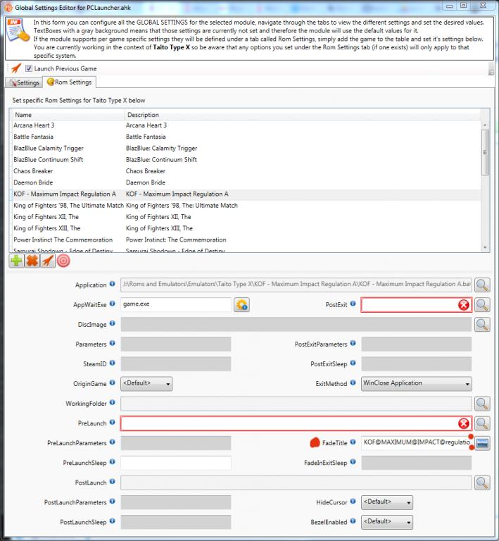

Guys do any of you please know how to fix the issue of King of Fighters - Maximum Impact Regulation A crashing back to the desktop as soon as a fight is about to start? The game starts up fine and you can navigate the menus without issue but as soon as the character intros pre-fight finish the game just returns to the desktop with an error message of "game.exe has stopped working". I've spent the best part of a day trying all sorts of combinations of setings to try to get it working so I thought I'd ask in here in the hope that someone know's how to get it working, Thanks.
did you set the fade title?
FadeTitle=KOF@MAXIMUM@IMPACT@regulation gAh
Maybe grab yourself the files on this thread mate....
http://www.hyperspin-fe.com/forum/showthread.php?30693-Taito-Type-X-Files
