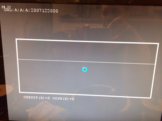

Hello not sure if this is the correct place to post this but I was sent here , any one know what this screen is? This is what I get when I click to start the Silent Hill Arcade game ..post-94279-142870622496_thumb.jpg any info is appreciated
