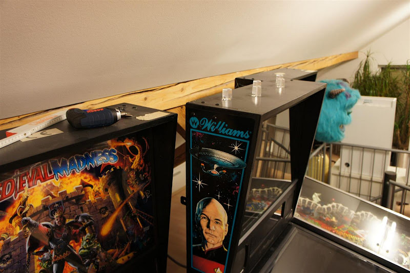

chriz99 Posted January 7, 2011 Author Posted January 7, 2011 installed 2 more cree's today.... drilling, wiring, soldering same old stuff cheers chris [sIGPIC][/sIGPIC] * taito egret 29 candy cabs * indy & star wars pachinkos 17" bartop with ledwiz rgbleds * 10" bubble bobble & galaga bartop * arm champs 2 check out hi-res backglasses * best vpin performance * ledwiz config and software

hicks100 Posted January 7, 2011 Posted January 7, 2011 whats the thinking behind the 2 extra crees chriz? i cant imagaine it needs more lumen output?
chriz99 Posted January 7, 2011 Author Posted January 7, 2011 most pinball tables have more than 3 flasher, mostly 5-7. the virtual pinball flasher effect is very nice and bright with 3 flashers, but you lose some colors sometimes (for example when 2 left flashers with different colors flashes at the same time). I will post a vid when everything is configured. cheers chris [sIGPIC][/sIGPIC] * taito egret 29 candy cabs * indy & star wars pachinkos 17" bartop with ledwiz rgbleds * 10" bubble bobble & galaga bartop * arm champs 2 check out hi-res backglasses * best vpin performance * ledwiz config and software
