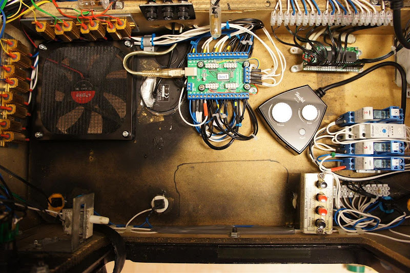

chriz99 Posted January 8, 2011 Author Posted January 8, 2011 wired everything cheers chris [sIGPIC][/sIGPIC] * taito egret 29 candy cabs * indy & star wars pachinkos 17" bartop with ledwiz rgbleds * 10" bubble bobble & galaga bartop * arm champs 2 check out hi-res backglasses * best vpin performance * ledwiz config and software
gbeef Posted January 8, 2011 Posted January 8, 2011 very nice... I have to rewire my cabinet also. It looks like a gaint mess My Cabs My Pin Cab Attack of the PINZ cab My Racing Cab OutRun Racing

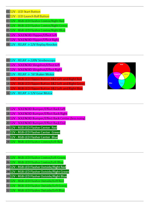

chriz99 Posted January 8, 2011 Author Posted January 8, 2011 thanks guys this is my new ledwiz config, have to reconfig now cheers chris [sIGPIC][/sIGPIC] * taito egret 29 candy cabs * indy & star wars pachinkos 17" bartop with ledwiz rgbleds * 10" bubble bobble & galaga bartop * arm champs 2 check out hi-res backglasses * best vpin performance * ledwiz config and software
shilmover Posted January 8, 2011 Posted January 8, 2011 cool. No more direct sharing of configs... oh well, it was good while it lasted. Maybe I will write an Excel Macro to do the conversion. Once you convert one, send me the .xls and I will see what I can come up with... I noticed that you no longer have an extra ball button wired up...
chriz99 Posted January 8, 2011 Author Posted January 8, 2011 cool.No more direct sharing of configs... oh well, it was good while it lasted. Maybe I will write an Excel Macro to do the conversion. Once you convert one, send me the .xls and I will see what I can come up with... I noticed that you no longer have an extra ball button wired up... yes, I miss my rom controlled extraball button (which is now always ON). I will send you the new xls. cheers chris [sIGPIC][/sIGPIC] * taito egret 29 candy cabs * indy & star wars pachinkos 17" bartop with ledwiz rgbleds * 10" bubble bobble & galaga bartop * arm champs 2 check out hi-res backglasses * best vpin performance * ledwiz config and software
luvthatapex Posted January 8, 2011 Posted January 8, 2011 wired everything Holy smokes Chris, that looks clean and tidy. Congrats!

Ext2k Posted January 8, 2011 Posted January 8, 2011 Very nice.I have some re-wiring to do. Going to test the 2nd LED-Wiz tonight... I have some ideas if it works... The code doesn't work with 2 ledwiz, it only works with 32 outputs. Regards!
shilmover Posted January 9, 2011 Posted January 9, 2011 The code doesn't work with 2 ledwiz, it only works with 32 outputs.Regards! Too bad. How hard would that be to enable?
