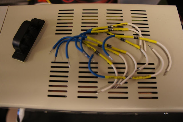

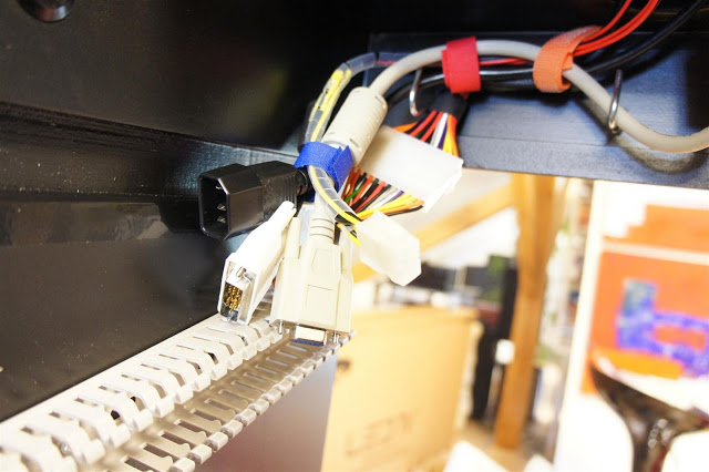

chriz99 Posted July 14, 2011 Author Posted July 14, 2011 next steps backbox is now pluggable (vga/dvi/speaker/fan/flashers) diodes for the contactors cheers chris [sIGPIC][/sIGPIC] * taito egret 29 candy cabs * indy & star wars pachinkos 17" bartop with ledwiz rgbleds * 10" bubble bobble & galaga bartop * arm champs 2 check out hi-res backglasses * best vpin performance * ledwiz config and software

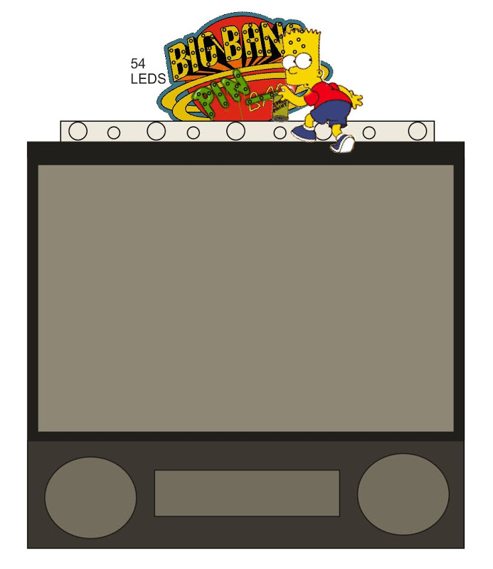

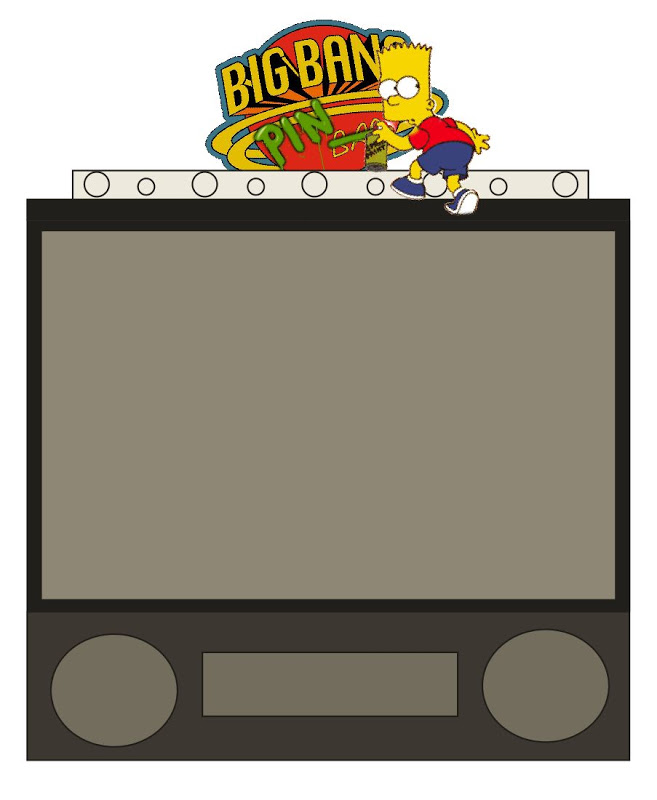

chriz99 Posted July 15, 2011 Author Posted July 15, 2011 I am thinking of a cool custom topper (like the awesome topper gbeef made). 2 layer with bart in the foreground and the BBP logo in the background. the green spray paint could be illuminated via green LEDS on the back. what do you think? cheers chris [sIGPIC][/sIGPIC] * taito egret 29 candy cabs * indy & star wars pachinkos 17" bartop with ledwiz rgbleds * 10" bubble bobble & galaga bartop * arm champs 2 check out hi-res backglasses * best vpin performance * ledwiz config and software
mwong168 Posted July 15, 2011 Posted July 15, 2011 I would use EL glow wire instead of LEDs to illuminate the "PIN" word. http://store.glowire.com/products/12-Volt-10%27-Plug-%26-Play.html Looks great otherwise and can't wait to see more pics of the your build.
chriz99 Posted July 15, 2011 Author Posted July 15, 2011 I would use EL glow wire instead of LEDs to illuminate the "PIN" word.http://store.glowire.com/products/12-Volt-10%27-Plug-%26-Play.html Looks great otherwise and can't wait to see more pics of the your build. awesome idea, will order some el glow for testing. thanks matey! edit: found some cheers chris [sIGPIC][/sIGPIC] * taito egret 29 candy cabs * indy & star wars pachinkos 17" bartop with ledwiz rgbleds * 10" bubble bobble & galaga bartop * arm champs 2 check out hi-res backglasses * best vpin performance * ledwiz config and software

chriz99 Posted July 15, 2011 Author Posted July 15, 2011 btw erwin... 54 LEDS would be the perfect fit (Digital I/O Pins: 54 with arduino mega clone) LOL cheers chris [sIGPIC][/sIGPIC] * taito egret 29 candy cabs * indy & star wars pachinkos 17" bartop with ledwiz rgbleds * 10" bubble bobble & galaga bartop * arm champs 2 check out hi-res backglasses * best vpin performance * ledwiz config and software
mameman Posted July 15, 2011 Posted July 15, 2011 wicked idea, really fits in well with the spray painted pin/bar bit. don't have a cow man.... PM me for any custom CNC needs. Find me on Facebook.. Xtreme Pinball or www.xtremepinball.com Ipad pinball cabinet iFlipper Here: See the Doctor Who build Here.... / See the Tron build Here.... / See the BattleStar Galactica build Here.... See the Big Bang Bar build Here.... / See the Twilight Zone build Here.... CNC Work Here.....
