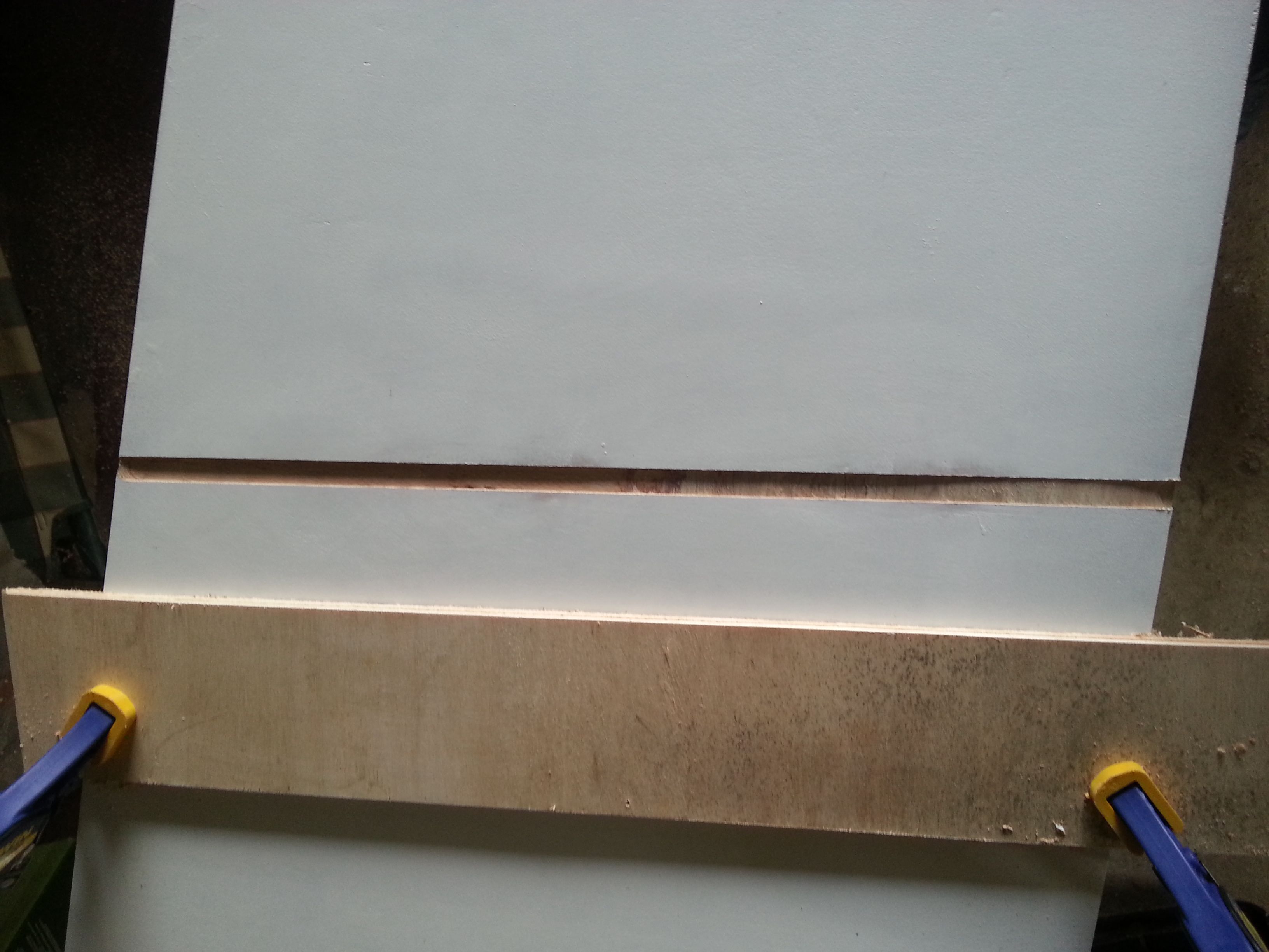

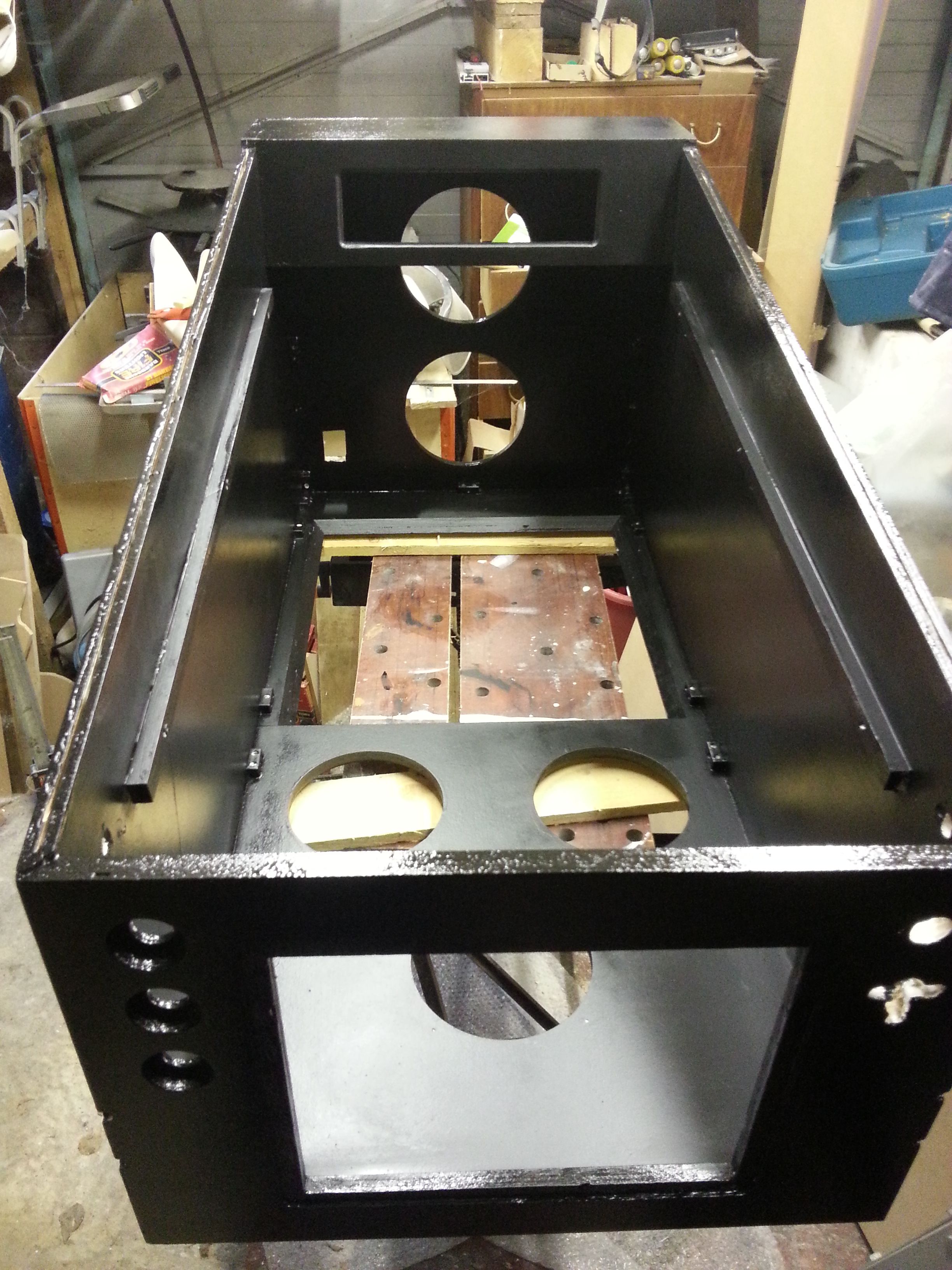

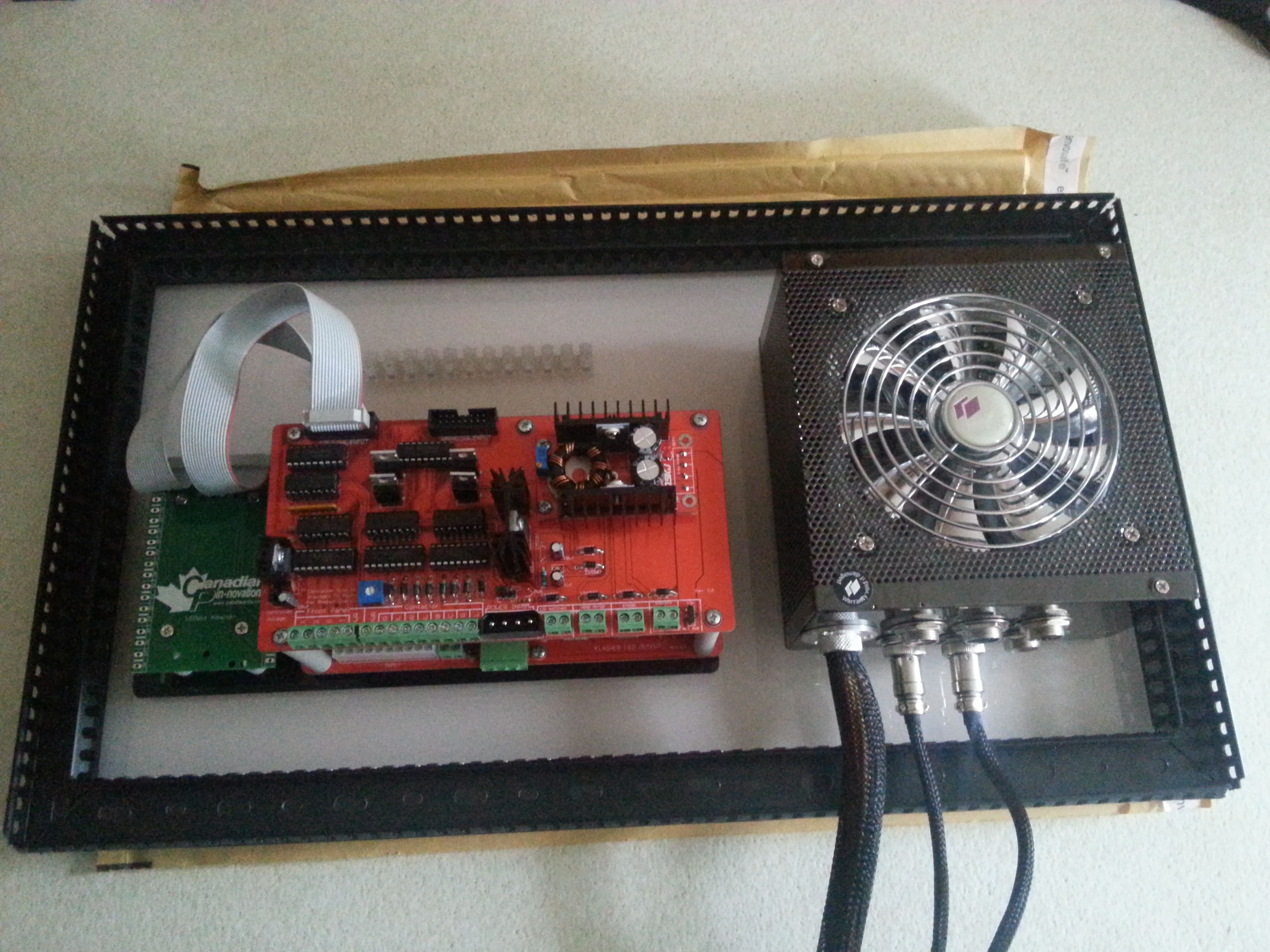

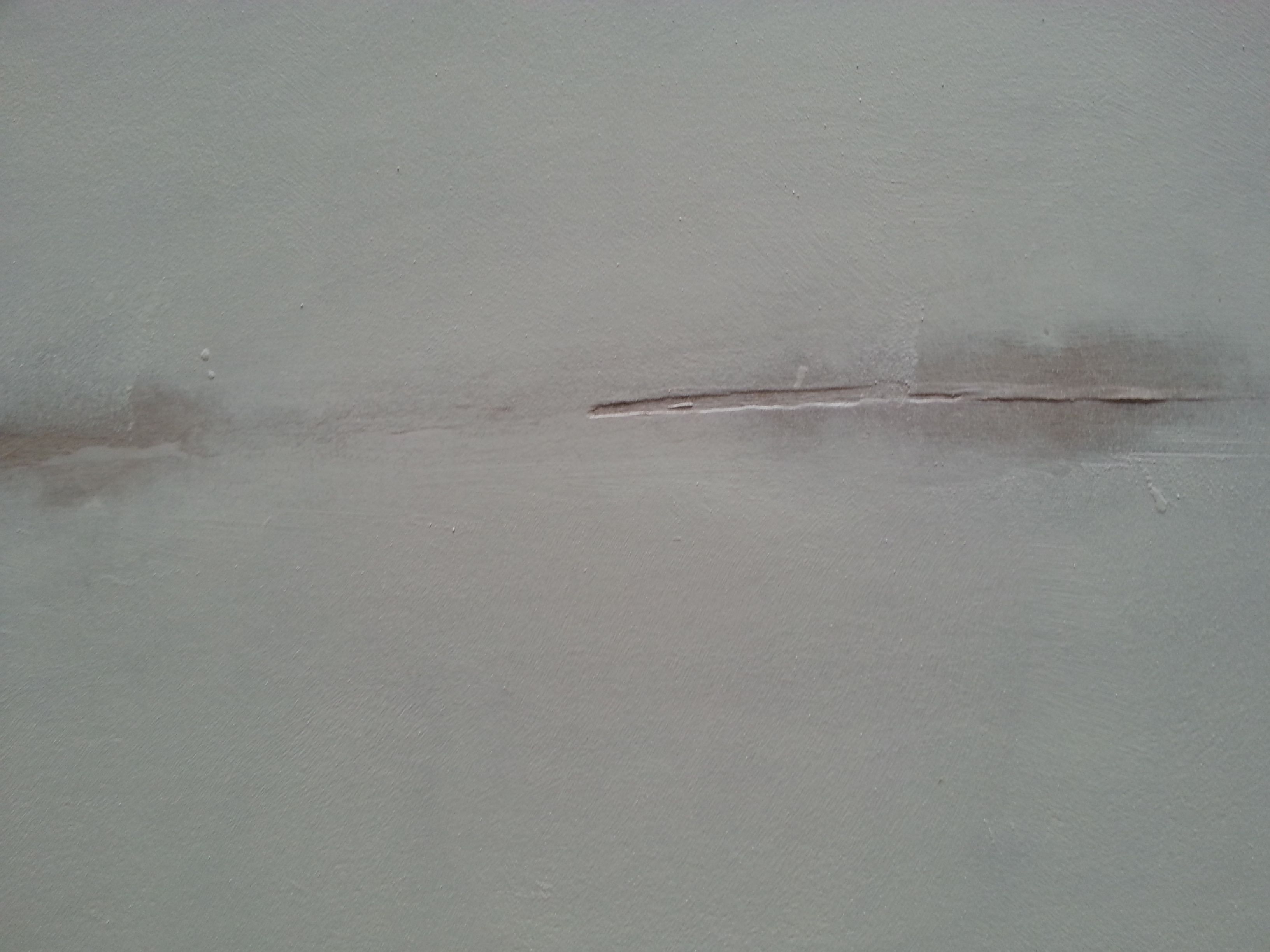

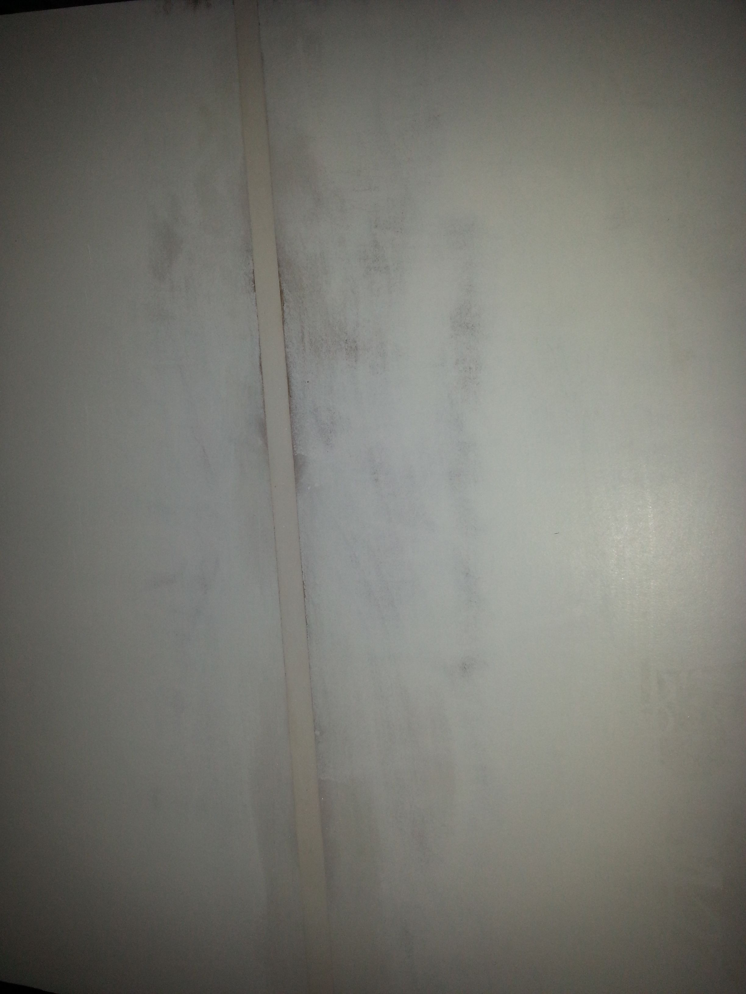

mikekim Posted September 9, 2013 Author Posted September 9, 2013 Update here is a better shot of the blistering on the side of the cab, due to winter weather so i had to route out a section of the cab using a 12mm bit, set the bit to a depth of a couple of mm (to the first layer of the ply) then started layering out the slot with filler. decided to leave the final layer of filler to set for the week before sanding it off (care to guess what next weeks instalment will be??) while waiting for the filler to set i started work on the front panel of the back box, routed out the opening for the monitor. still have to route out the holes for the speakers also did some work last night on the shelf for the virtual output kit. ordered some 528mm x 300mm x 6mm clear perspex sheet. using sticky velcro attached the cable management around the edges of the sheet. roughly positioned the virtual output kit and a spare 580w PSU i had spare. have also included a terminal block at the back of the unit so i can link any grounds together. i decided on clear perspex for this unit, so when it's installed you will be able to see through the base onto the PC below. (the White protective backing is still on the underside in this shot) Now will need to source a couple of 24 way molex connectors, to make the shelf easily removable once installed.

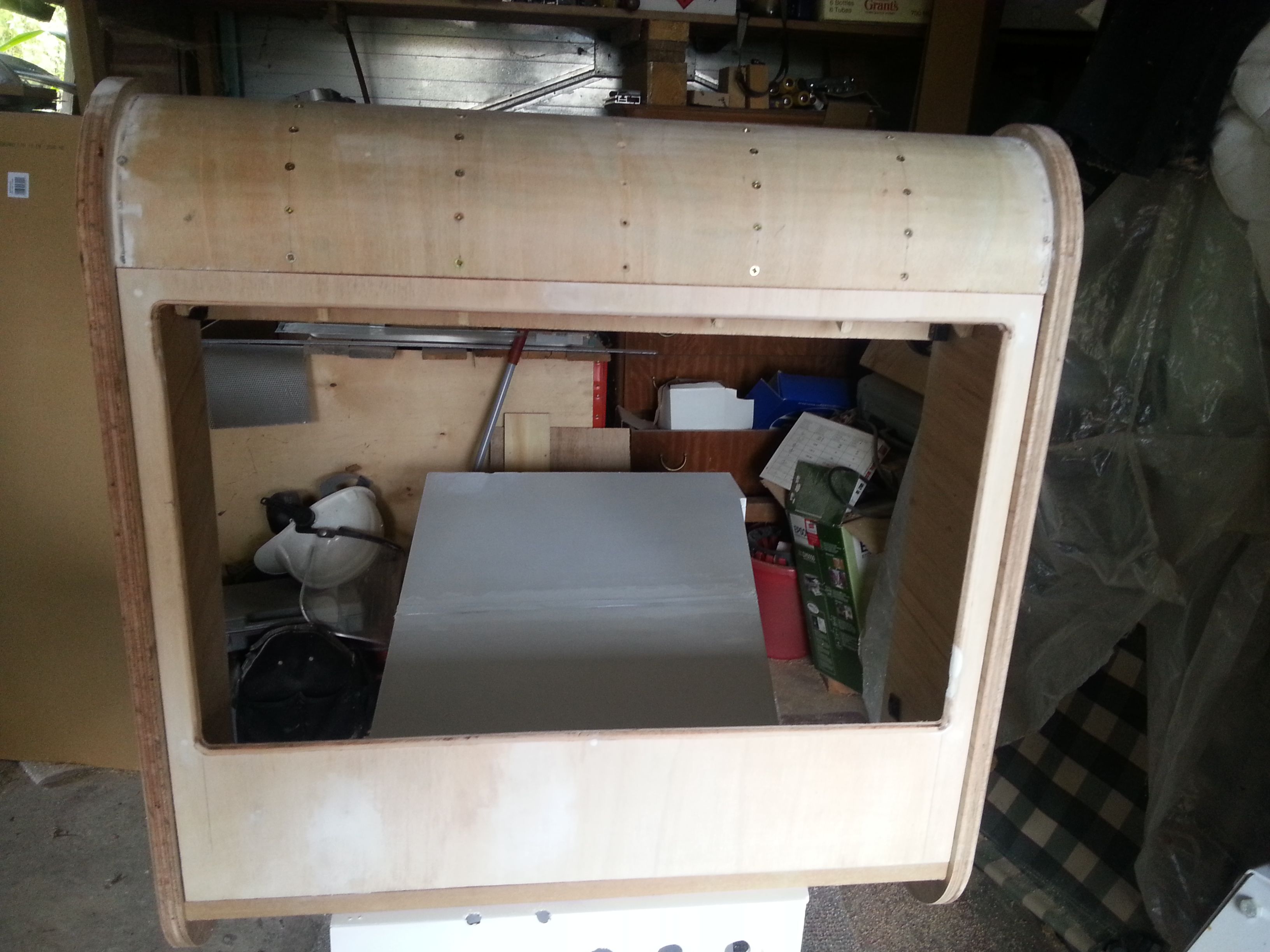

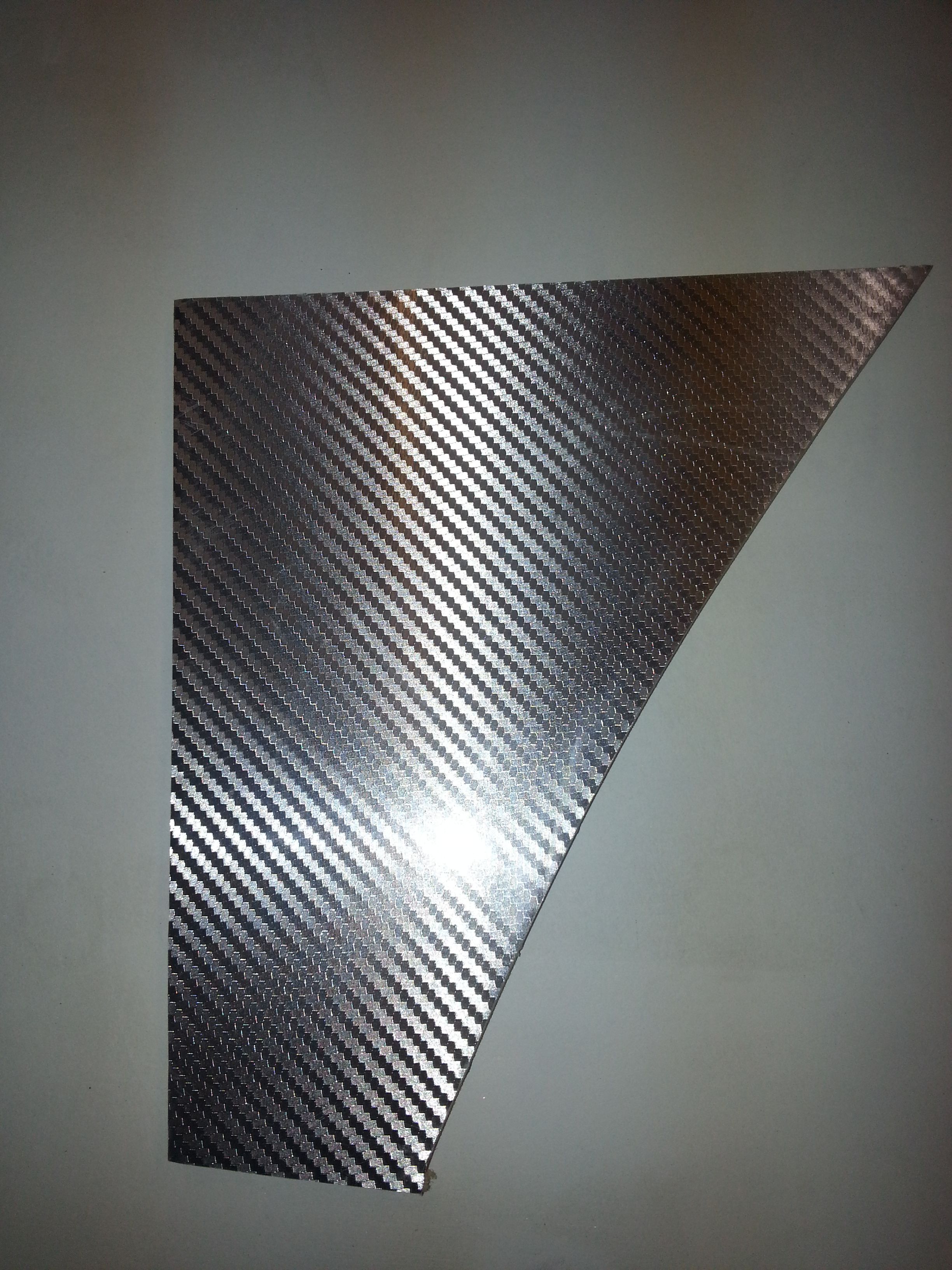

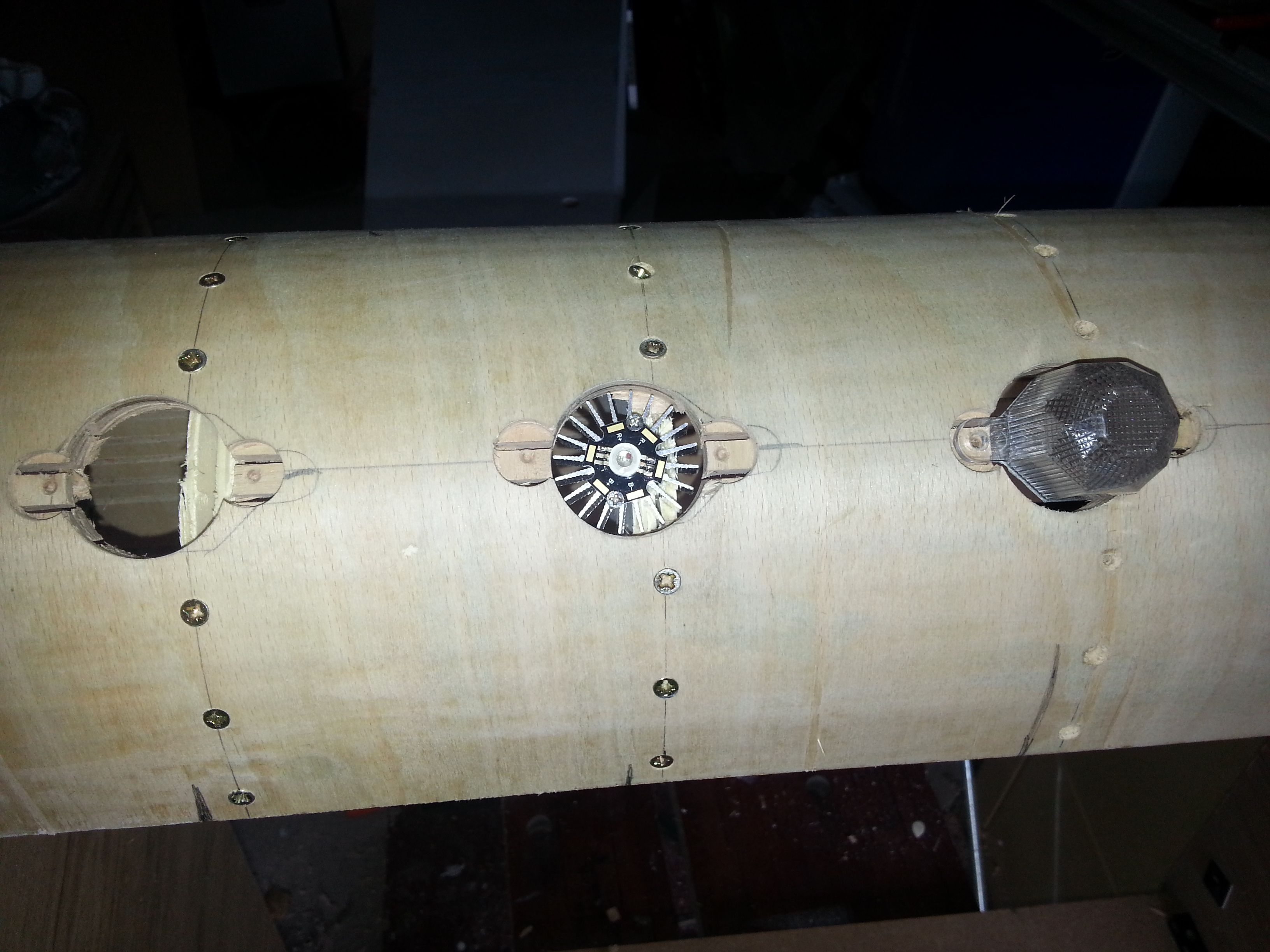

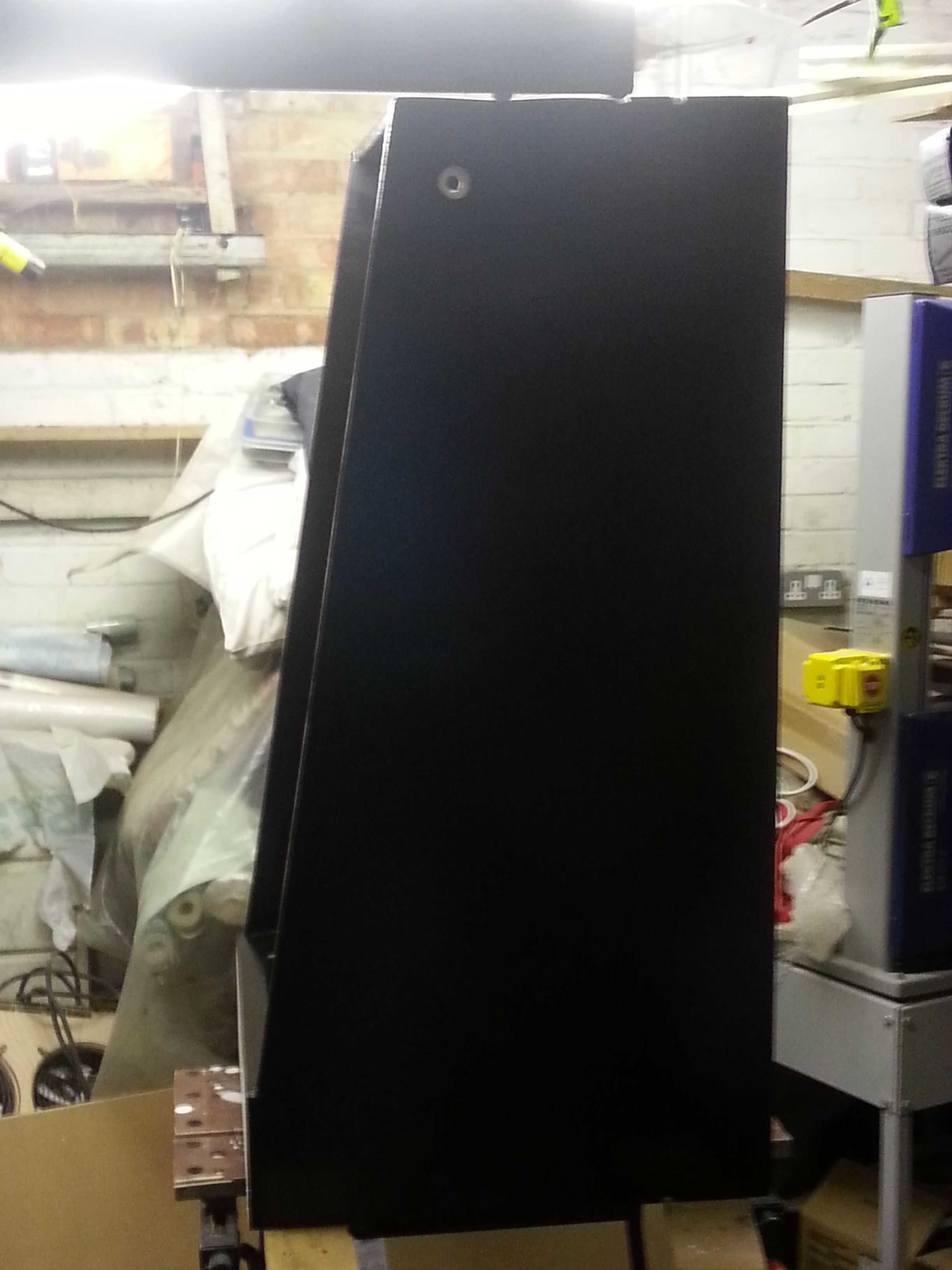

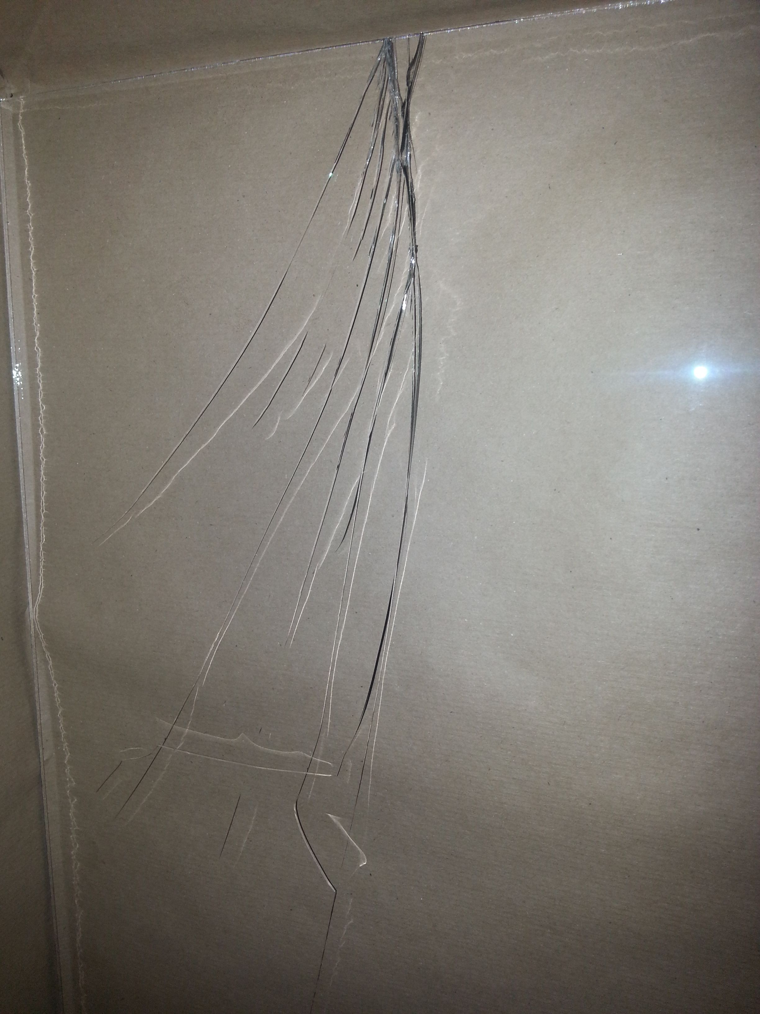

mikekim Posted September 15, 2013 Author Posted September 15, 2013 Update here we go rant time.... you really have to wonder about how some companies do business.. I ordered a sheet of 1000x540x4.4mm laminated / anti glare glass from a company. it arrived at my parents house on Thursday, wrapped in one sheet of brown paper. the sheet that arrived was the wrong size 1000x580 to the one i ordered (40mm larger width wise) so even if there was no problem with it, it was too big for the build , but because of the way it was packed, surprise surprise it arrived damaged.... needless to say I wasn't impressed.. [/RANT OFF] back to the build... not much done today, not alot of time to spend on this atm. sanded off the final layer of the blister fix from last week and is now ready for primer. also drilled the holes for the led's and flasher caps on the back box using a 16mm forstner bit for the side tabs and a 46mm for the main hole the gaps will be filled (with filler) for better look later on. the whole of the top will be covered with filler (to hide all of the screws). on an additional note for the back box the stainless steel sheet is not really working out for covering the back box (tbh the sheet is a pig to get any decent finish on and will be far to much hassle to cut out the openings i need for speakers, flashers and the screen), so i have decided to take another option with the main coverage. I have found a supplier of chrome carbon fibre effect adhesive sheet on ebay and think that this would work quite well for the back box cover. put a test section on a scrap of mdf to see how it would look will make installation on the back box a lot easier than trying to cut the perforated sheet to the correct dimensions.
monkeychunkuk Posted September 16, 2013 Posted September 16, 2013 Another great update I never understand trades that specialise in one product bugger it up so much? It's not rocket science is it measure twice cut once and protect the product until its in customers hands.i relievers a fire alarm Isabel today when I opened it the text on the buttons was upside down ???? Any way back to the carbon fibre vinyl after using on 4 cabs I do think its overlooked by many considering the finish you can achieve. Any chance you can share a link to you're vinyl supplier Keep up the great work Steve
JogZter Posted September 16, 2013 Posted September 16, 2013 I can recommend this seller, from which I bought vinyl adhesive for my Vpin. It's a nice product and a great price, I would say, and applying it is really easy because of the air release canals. I put it on sealed mdf and have great results. Used it for my DMD panel, the whole backbox, the cab inside and some other parts. I would have used it for the outside as well but for that I needed printed decals. Cutting it with a sharp exacto knife was also real easy. http://www.ebay.de/itm/Premium-3D-Carbon-Folie-schwarz-mit-Micro-Luftkanale-Car-Wrapping-9-18-m-/251191707690?pt=DE_M%C3%B6bel_Wohnen_Dekoration_Befestigung_boards_wandbilder&var=&hash=item3a7c31482a This is where I bought it. Different colors available as well...
mikekim Posted September 17, 2013 Author Posted September 17, 2013 Any way back to the carbon fibre vinyl after using on 4 cabs I do think its overlooked by many considering the finish you can achieve. Any chance you can share a link to you're vinyl supplier sure here is the link 1m x 1.52 - 2D Chrome Vinyl sheet sticker film Wrap mike.

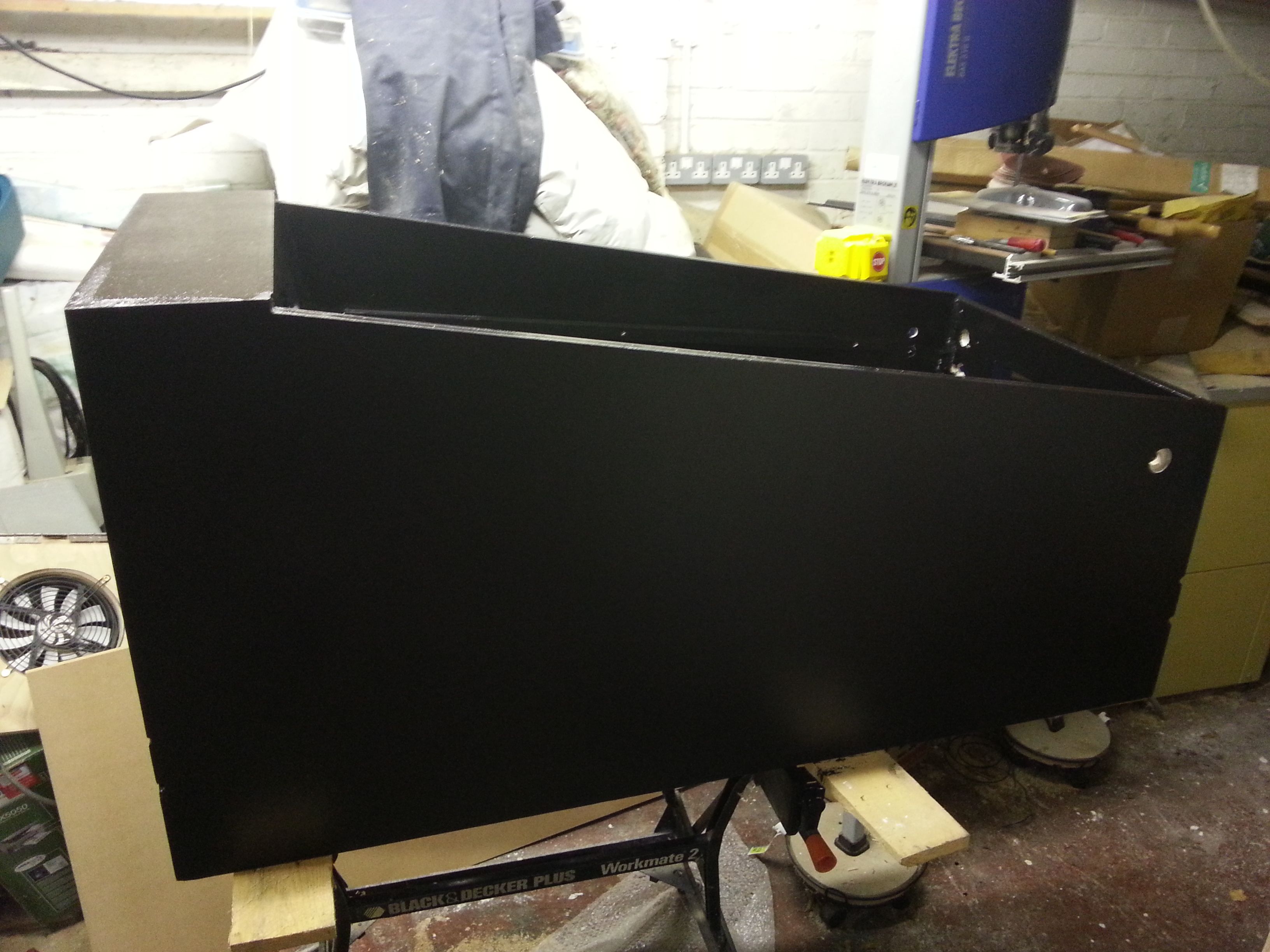

mikekim Posted November 3, 2013 Author Posted November 3, 2013 update not much going on really... spending too much time playing with this new toy... Astra GTC VXR * Engine: 2.0-litre 4cyl turbo petrol * Power: 276bhp * Transmission: Six-speed manual, front-wheel drive * 0-62/top speed: 5.9 seconds/154mph anyway.. back to the build.. had a couple of hours to do some bits on the build (before being called into work.. :bang head: ) managed to put on the first coat of black on the cab.. the second coat will have to wait till next week. at this rate i might be done by christmas next year....

mikekim Posted November 11, 2013 Author Posted November 11, 2013 Update put on the second coat of paint on the body today will finish off the underside of the cab tomorrow and look at the back box

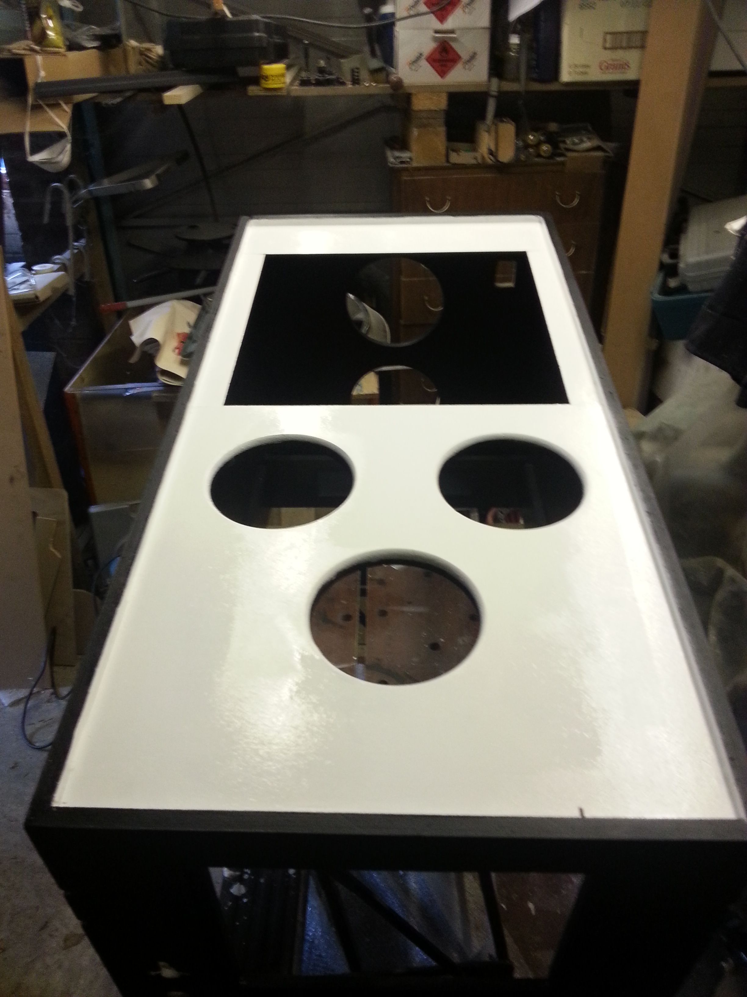

mikekim Posted November 14, 2013 Author Posted November 14, 2013 todays update just really finishing off the painting on the cab - the white underside today nearly time for the artwork - best dig it out and get it sent off to Lucian for him to work his magic...
