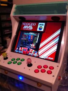

Inertia42 Posted March 3, 2013 Posted March 3, 2013 Hello everyone, I've made myself a mini cab (almost finish), I use arcade components (seimitsu buttons and sanwa joy connected to an usb controller on a pc based system), and I have the joystick problem with 1.3, when I try to select a game the joystick is acting by itself, and randomly jump from game to game each time I go up or down, and sometimes it just don't stop spinning. it's sad because on my pc 1.2 is really choppy, but 1.3 runs fine. (I guess flash 11 is way more efficient than 9) Is there a way to fix this joystick problem? Thanks and sorry if it has already been answered.
