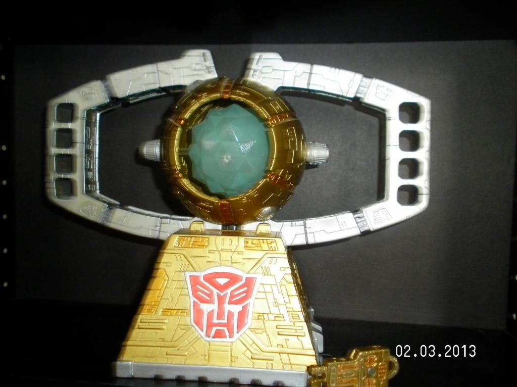

viriiguy Posted March 5, 2013 Author Posted March 5, 2013 I have LEDS!!!!! Yep I got most of them working! And Zeb just helped me to more than likely solve the issue witht he last one. And to make it even better... I found the PERFECT topper for my pinball machine!!! This is the Matrix of Leadership, that resides in the chest of Optimus Prime. These things sell for $300 - $500 regularly. But this one has a broken switch. So I got it for $71!!!! I am going to toss in an RGB LED and wire it up to one of my lights or something. I KNEW when I got the idea for this theme, that this was what I wanted for a topper. But I was not going to spend that much money just to buy something I was going to rip apart and mod. The fates shined down on me and I lucked into this one!
