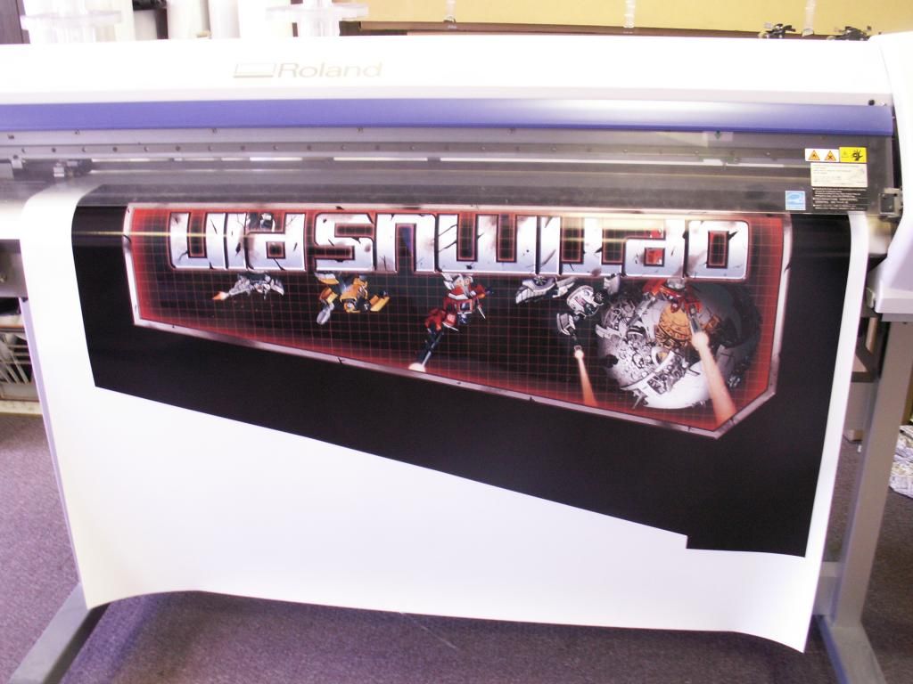

viriiguy Posted March 27, 2013 Author Posted March 27, 2013 I vaguely remember that thread. Thanks! I will search for it and give it a shot. My contactors are used, but I have 2 sets of them and they are both much quieter than I had expected them to be. Especially based on some of the videos I have seen. Oh yea, Brad sent me this in my email today!!!!
