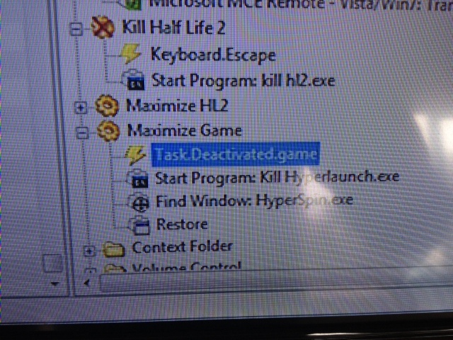

Your meaning like this?
ok so you have raiden 4 working too how are you managing this??? are you using the latest hyperlaunch coz we all can't get it to work.
[sIGPIC][/sIGPIC]
I just have a macro to open hyperspin once raiden iv etc closes
yes Im on latest hyperlaunch
let me test it a little more to make sure it doesn't mess with any other games
That would be cool, I've only gotten it to work after a fresh reboot once or twice, outside of hyper spin
Sent from my SCH-I535 using Tapatalk 2
well it may not be the answer for some but it works for me, just tested all the taito type x games and none had issues so guess its ok, works everytime for me.
*posted new tutorial below*
Hope that makes sense
I use eventghost for LOTS its really really handy
I use similar method when launching Half Life Survivor 2.0 to maximize the game infront of that annoying console etc
should look like this
Get a program called EventGhost. Create a macro and call it anything you would like. Create an event and call it Task.Deactivated.game , for some reason Hyperlaunch wasn't closing for me on raiden iv etc when I closed so now create a batch file and just put taskkill /f /im HyperLaunch.exe , next in same macro goto add action, then system and start an application and choose batch file and tick wait till application is finished. Now again click add action, window and find a window (run hyperspin in background) and choose Hyperspin.exe and finally add action again, window, then click restore.
[ATTACH=CONFIG]29635[/ATTACH]

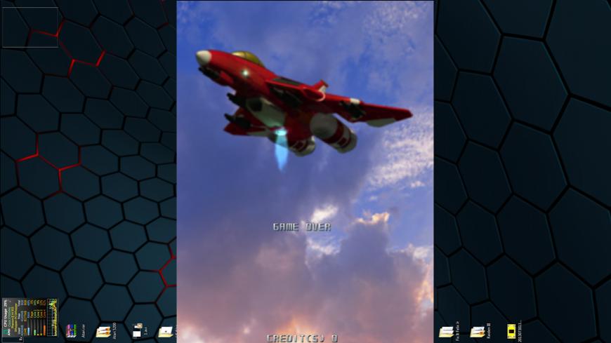

Boomslangz, Christmas has come early, Thanks for a great guide. Just tried Raiden III and it closes perfectly. I suppose that 1 event can be used for other games as well.
I only issue I had is my dirty desktop showing.
post-9524-142870595391_thumb.jpg :cheers:
