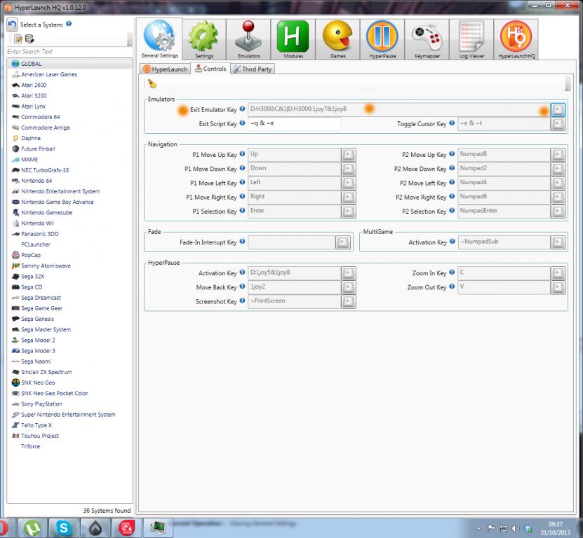

TechnoFreek Posted October 20, 2013 Posted October 20, 2013 Ok. so my first issues as I test in hyperspin. Gigawing and Homura load, rotate vertical for horizontal monitor and work just fine but when I exit back to Hyperspin, Hyperspin freezes. If i press the left mouse button it seems to unfreeze however when I have this up and running in my cab there won't be a left mouse button! Suggestions please. I presume this is related to irotate or related. Update: Raiden III and IV behave the same with Hyperspin freezing on exit.
gigapig Posted October 20, 2013 Posted October 20, 2013 Ok. so my first issues as I test in hyperspin. Gigawing and Homura load, rotate vertical for horizontal monitor and work just fine but when I exit back to Hyperspin, Hyperspin freezes.If i press the left mouse button it seems to unfreeze however when I have this up and running in my cab there won't be a left mouse button! Suggestions please. I presume this is related to irotate or related. Update: Raiden III and IV behave the same with Hyperspin freezing on exit. In hlhq make sure you have "restore frontend and click" set. Not sure where it is probably in settings. Also how are you exiting? You may need to edit your exit emulator keys also in HLHQ. I have a 2 key press and hold for 3 seconds set.

TechnoFreek Posted October 21, 2013 Posted October 21, 2013 In hlhq make sure you have "restore frontend and click" set. Not sure where it is probably in settings.Also how are you exiting? You may need to edit your exit emulator keys also in HLHQ. I have a 2 key press and hold for 3 seconds set. Sound. Will give that a go. Im just hitting escape to exit. Works fine on other type x games. Just the ones that rotate causing the hassle. Really want to keep it just set to escape as the jpac supports it nicely. Nice tip on the bindings file too as I have the same controls setup driven by panel layout.

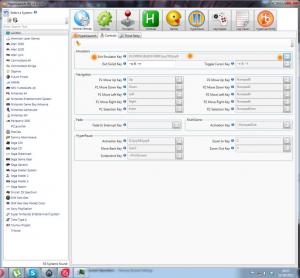

TechnoFreek Posted October 22, 2013 Posted October 22, 2013 Clicked restore frontend and click under both global and taito. Made no difference. Will stick an image up of my exit settings but as I said before I want to keep it as escape as it suits my jpac and cab setup.
gigapig Posted October 22, 2013 Posted October 22, 2013 Ok, as a last resort there is a bunch of TTX stuff on my ftp which may help with some of rotating games. Mainly the wrapper packs (made by Dragon King) they may help with exiting. They don't require you using the DXWnd module but some still need DXWnd to rotate. I think they also help with restoring resolution on exit. Have a play around.
TechnoFreek Posted October 22, 2013 Posted October 22, 2013 Cheers dude. Will take a look. A right pain having to go to that effort for just a couple of games

Deadly Posted October 22, 2013 Posted October 22, 2013 Ok. so my first issues as I test in hyperspin. Gigawing and Homura load, rotate vertical for horizontal monitor and work just fine but when I exit back to Hyperspin, Hyperspin freezes.If i press the left mouse button it seems to unfreeze however when I have this up and running in my cab there won't be a left mouse button! Suggestions please. I presume this is related to irotate or related. Update: Raiden III and IV behave the same with Hyperspin freezing on exit. Open HyperlaunchHQ Click on TTX console Click on Settings tab Under Desktop section set it as the following: False, true, true, true, false Under EXIT section Ensure restore front end on exit is set for RESTORE AND CLICK Close HyperlaunchHQ See if vertical game exit still causes HS to freeze. IIRC - it was something in this setting area that causes this behaviour. Please report back.
gigapig Posted October 22, 2013 Posted October 22, 2013 TechnoFreek, I would try what Deadly suggests before moving on to other solutions.
