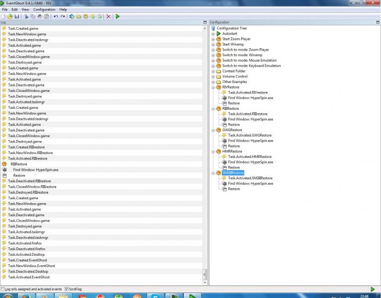

TechnoFreek Posted October 26, 2013 Posted October 26, 2013 Right. Have EventGhost up and running ad Raiden3 and 4 seem to exit jsut fine with no freezing. However the other three games all cause Hyperspin to freeze on exit and require alt tabbing. I've included a screen from eventghost. Anyone confirm that its structured ok. Thanks. What desktop and restore frontend settings are needed in hyperlaunchhq?
gigapig Posted October 26, 2013 Posted October 26, 2013 Right. Have EventGhost up and running ad Raiden3 and 4 seem to exit jsut fine with no freezing.However the other three games all cause Hyperspin to freeze on exit and require alt tabbing. I've included a screen from eventghost. Anyone confirm that its structured ok. Thanks. What desktop and restore frontend settings are needed in hyperlaunchhq? [ATTACH=CONFIG]33861[/ATTACH] I'm surprised that works at all? May be I'm wrong? You have "Task Activated" set. In Boomslangz video you need to pick "Task created" One step I missed was actually running the exe that you create. Boomslangz does this in the vid but it's easily missed and he doesn't really emphasis it. You have to run it so Event Ghost to pick it up. Also, I only remember creating 1 macro and I used it for all games, you have made 1 for each. Again I may be wrong so someone else may need to confirm that. I made 1 exe file (RIV) and pointed each game to that.
langersld Posted October 26, 2013 Author Posted October 26, 2013 Also, I only remember creating 1 macro and I used it for all games, you have made 1 for each. Again I may be wrong so someone else may need to confirm that. I made 1 exe file (RIV) and pointed each game to that. I would use a separate macro for each game if I wanted some other fancy stuff happening with that specific game.....
TechnoFreek Posted October 27, 2013 Posted October 27, 2013 Giga, no problem with you saying that at all. Everyone is in solution mode just trying to help topple this conplex setup! I just followed the steps written on page 34 of this thread moreso than the video itself. 13)Find in log on left something such as Task.Activated.RIVRestore or something similar 20)Repeat for each game as required creating new exe and macro for each and in each game in pclauncher.ini Not at my pc at the moment but have a hunch as to one possible reason those other three games in particular are still freezing on exit. Typo in the postexit path that I haven't corrected. My event ghost setup could still be muck of course! Fingers crossed thats it anyway!
TechnoFreek Posted October 27, 2013 Posted October 27, 2013 Update: There was a typo with the postexit path for the last three games. Gigawings now not freezing however Homura and Shikigami are still freezing on exit. Interestingly both of these have a Windows message pop up while loading and running. "The colour scheme has been changed to Windows 7 Basic"

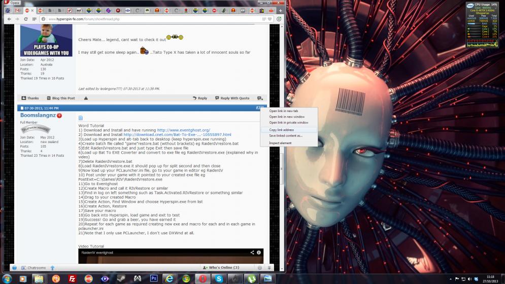

gigapig Posted October 27, 2013 Posted October 27, 2013 If that worked for you, then that's great. I had a feeling it had to be Task created as any other method didn't work for me. I have my "Number of Posts to Show Per Page" count set up different so I get more posts per page, so mine is on 20 pages instead of 77. Quick tip for everybody, on such a big thread. If you need to point to a specific post, add a link. Right click the # number.
TechnoFreek Posted October 27, 2013 Posted October 27, 2013 Am going to try the task created option for in event ghost though seeing as it works for you and I'm not 100% there yet!
