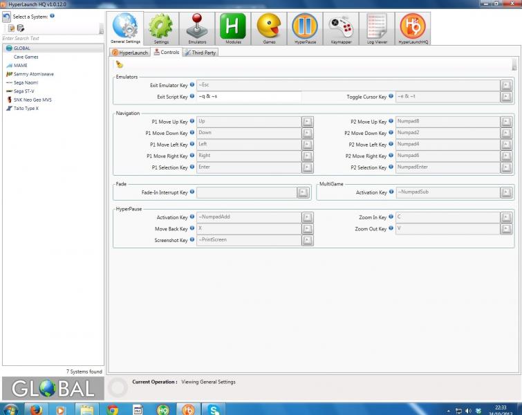

gigapig Posted October 23, 2013 Posted October 23, 2013 Not returning focus is an issue, because the experience is no longer seamless, you have to grab a mouse to return focus; and for people with cabs that must be a real pain. So FWIW, I did use Event Ghost as soon as Boomslangz came to our aid. But again since moving to xpadder or finding new exe's/loaders, I don't use it any more. So what do you I/J-pac guys use as an exit key? 2 problem games for exit are RIV and AH3. With RIV I can use the games exit key, (set to 0) or the Exit emulator key I have set in HLHQ which is C + 1 with a 3 second delay. AH3 the games exit key is again 0 but the exit emulator key combo does not work. The exit method for both is WinClose Application. Whats everyone else using for these 2 games?
majorspawn Posted October 23, 2013 Posted October 23, 2013 Not returning focus is an issue, because the experience is no longer seamless, you have to grab a mouse to return focus; and for people with cabs that must be a real pain.So FWIW, I did use Event Ghost as soon as Boomslangz came to our aid. But again since moving to xpadder or finding new exe's/loaders, I don't use it any more. So what do you I/J-pac guys use as an exit key? 2 problem games for exit are RIV and AH3. With RIV I can use the games exit key, (set to 0) or the Exit emulator key I have set in HLHQ which is C + 1 with a 3 second delay. AH3 the games exit key is again 0 but the exit emulator key combo does not work. The exit method for both is WinClose Application. Whats everyone else using for these 2 games? Im using ESC to exit with WinClose Application, but i lose focus if I dont use EventGhost, the games that are effected for me are both raiden games and SSEOD, all others work fine and don't lose focus at all. My Arcade Projects: SNES PC Project Vewlix Cabinet LS-30 Rotary Joysticks

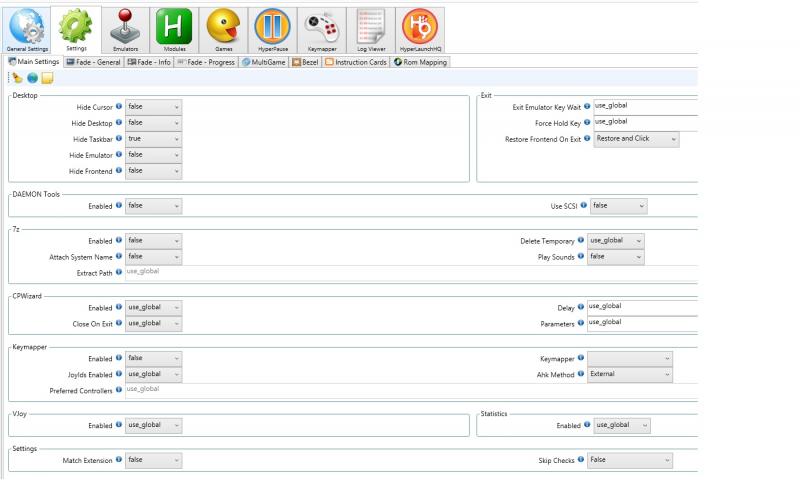

Deadly Posted October 24, 2013 Posted October 24, 2013 Figured out what causes the loss of focus and freezing. It was all user induced - meaning me. I'll explain in a bit. Again I stress everything TTX related tends to be hit and miss but I just tested all 5 vertical games which all suffered from the screen freeze/loss of focus. Keep in mind I SOLELY use Dxwnd. First of all if you have set WINDOWS to automatically hide the task bar UNDO IT! Open HyperlaunchHQ Click Taito Type X Main Menu tab Desktop settings - Hide Taskbar TRUE Set all the other Desktop Settings to false Close HyperlaunchHQ Launch Hyperspin Try any of the 5 vertical games and they should open and close fine. So I tried EVERY possible combination of settings including enabling/disabling the windows taskbar VIA taskbar/properties. Interestingly enough, Gigawing exited perfectly fine with with or without HIDE TASKBAR enabled/disabled as long as the taskbar was set NOT to autohide. The others would lose focus. The combination of using the HLHQ hide taskbar set to true and windows taskbar set to NOT AUTOHIDE allowed ALL games to exit fine. Now another snafu is if HIDE CURSOR was set to TRUE, upon game exit .... left clicking didn't restore HS. This is what is referred to as game freeze. I had to alt+tab twice to get HS focused. I suppose I should mention I have ESC set as my exit key and RESTORE FRONT END ON EXIT set for Restore and Click. So there ya go. I'd like to hear some reports back.

TechnoFreek Posted October 24, 2013 Posted October 24, 2013 Right, tried that deadly. Assuming I've understood and made the settings correctly, Hyperspin completely freezes up now and left click does nothing. I have to alt tab to get HS to kick back in.
Deadly Posted October 24, 2013 Posted October 24, 2013 Damn. Why am I not surprised *sarcasm*. Also why I keep preaching TTX reacts differently between systems. Frustrating for sure. Well here is my settings. The only other thing that "might" be different from your setup is I have Fade In enabled and Fade Out out disabled.
TechnoFreek Posted October 24, 2013 Posted October 24, 2013 Tried fade in and out. Just the enable settings. No more. Still freezing

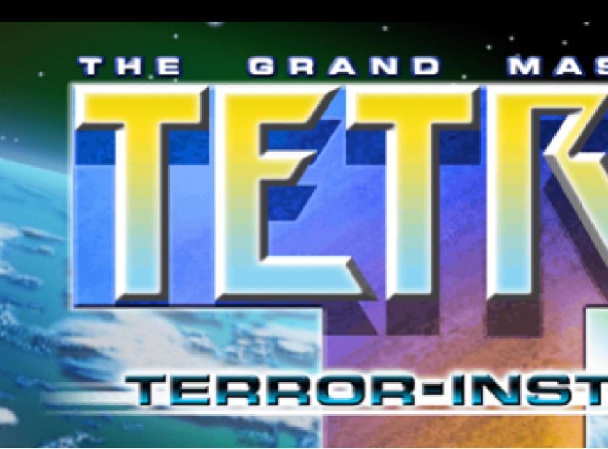

Parsec Posted October 25, 2013 Posted October 25, 2013 OK all you Taito Type Xperts, I have one that's been bothering me for awhile and want to try and tackle it again. Tetris the Grand Master. No matter what I've tried it's always displayed expanded and I can't see the entire screen. When the game launches it changes the resolution to 640 x 480. This happens in or out of Hyperspin. This is what I see: They only way I can play the game is to alt-tab to the desktop and change the resolution. Changing the resolution to 800 x 600 is still to small. The next option I have is 1024 x 768 which is a little to high and show a portion of the desktop but I guess I could live with it. I've done quite a bit of searching but haven't seen anyone else who's having this issue. I don't have the issue with any of the other type x games. This was happening when I had my ATI card and persists with my new Nvidia card so I don't think that's the issue. I've tried downloading the game from several different locations but Tetris displays expanded for me. I have all my taito games running with Pclauncher and not DXwind. What do you think would be the best way to tackle this one? A post launch call to change the resolution? Some event ghost magic?
