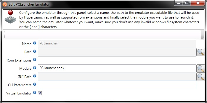

Do you have Rom paths set here?
[ATTACH=CONFIG]33905[/ATTACH]
As you can see I don't

This is exactly the reason I posted awhile ago NOT TO USE PCLAUNCHER.ini. That son of bitch causes ALLLLL sorts of goofy ass things to happen with TTX games. Having to use [game] is one of the issues I also mentioned.
You need to create a taitio type x.ini and put that in the pclauncher module folder. Copy all your TTX entries in the pclauncher.ini to taito type x.ini and then remove all ttx entries in the pclauncher.ini
Here's my Taito Type X.ini.
And what the hell is Dummy.exe? Is that something from HL2?
comparing that with mine.
because it appears game?
romName = game
romName = game
This issue is being caused by your emulator settings for PCLauncher. Specifically because you have the rom extensions value filled in.
Turn skipchecks to "Rom and Emu"
And make sure your PCLauncher emulator settings looks exactly like this.
If you fill an any of those blanks you might have problems. I know for a fact that you will have problems if you fill in the rom extensions field. Also remove any rom paths in your emulator settings for pc launcher also, those should be ignored, but it's best not to take the chance. I repeat do not fill in the rom paths or rom extensions for pclauncher. These are set in your module settings with the setting Application.
thanks really thanks this is the solution... thanks all deadly, gigapig, AYOOOB and ghutch92 thanks
[ATTACH=CONFIG]33918[/ATTACH]

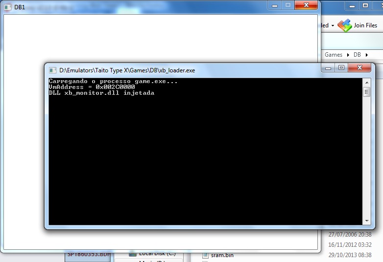

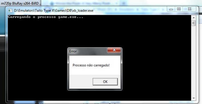

I said 64 bit because that is what I use. I'm aware its a 16 bit application because when I attempt to run it, that is the warning I get.
paulmichel21 mentioned it was working, I was looking for clarification.
I don't see how he managed to get it working with an encrypted game.exe. It's not a 16-bit application, the executable is encrypted that's all.
I can confirm guys..... KOF sky stage exe still needs to by decrypted to work... so for now no go on any system
sorry but I'm confused is that recently I go to windows 7 ....but
It seems the launcher game.exe has to be decrypted to run with the Type X loader. i download the new I notice if it works

Giga, got those files thanks but no joy yet with getting Daemon Bride to run.
When I double click xloader I get an error in spanish!
I don't have a game.exe file however I do have a DB1.exe file. Rightly or wrongly, if I rename DB1.exe to game.exe and try xloader again I get this frozen DB1 window:

Yep - change the contents of the BAT file from game.exe to DB1.EXE
Also, if you have set any compatibility settings set on either DB1.exe or XB_loader.exe remove it. Adding additional compatibility settings causes this error to happen as well.
Sorry I forgot that rename detail.
Your other screen shot is correct however, saying it's injected something into game.exe or the dll.
But you shouldn't see that as the game should be running and concealing it.
I think Parsec had the same problem. Are you using ATI? May need to look back.

guys, just for clarity. there is no bat file with the daemon bride rom pack i have.
When I rename db1.exe to game.exe and run xbloader, the screen frezes and doesnt progress past a white screen. The second image in my previous post.
Using nvidia gfx card.
[ATTACH=CONFIG]33958[/ATTACH]
[ATTACH=CONFIG]33959[/ATTACH]
Try this Techno...
1. did you create a FlashROM folder and copy the game folders into it....?
the folders have to be placed inside the folder FlashROM, otherwise the game will not run..
2. If you have..... then perhaps try another dump as The loader is to be used only with the original executable of the game...
3. Attempt to update drivers, directx... Netframeworks and Visual C + + libraries (2005, 2008 and 2010)
Do you have a folder called "flashrom"?
If not create one.
Then put all the other folders into that "flashrom" folder.
