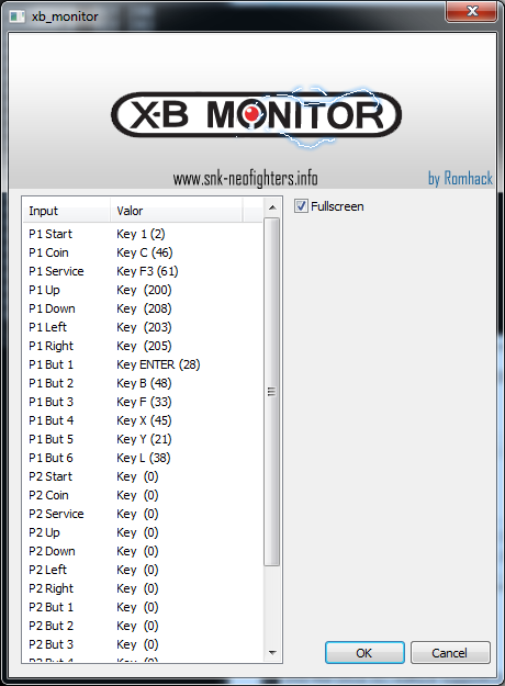

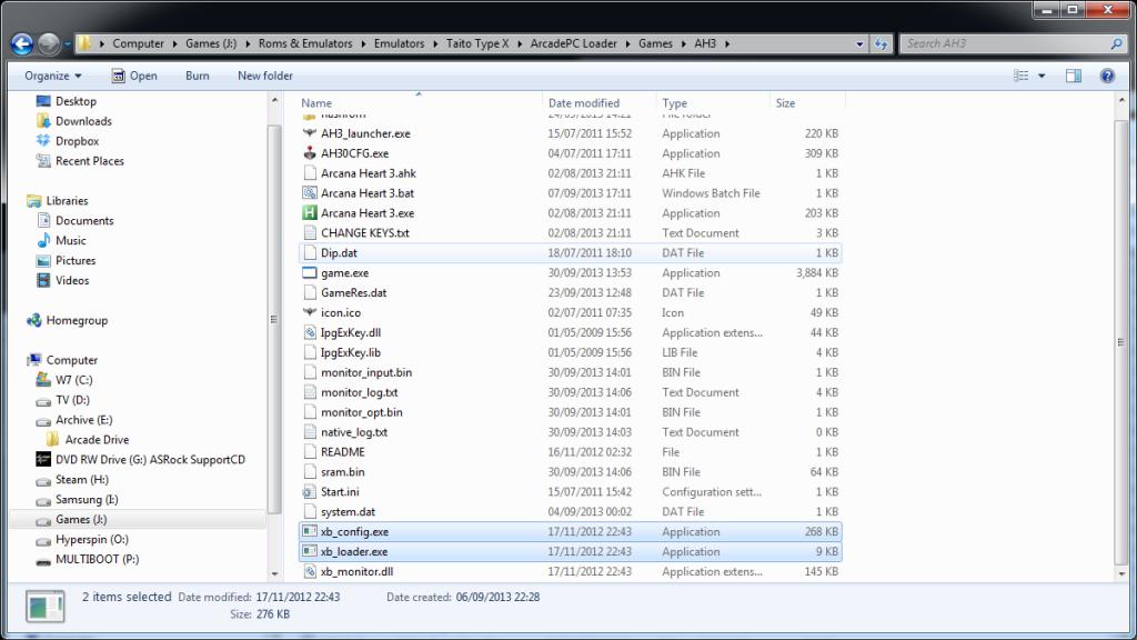

Deadly Posted October 2, 2013 Posted October 2, 2013 I seriously thought I'd killed the thread with those shocking images, it certainly went quite for a while.Deadly. Did you get my pm about xb_config for AH3? Your post brought back lots of happy memories and I've just upgraded my pc so I'd better check everything again. Not sure how this fares with iPac, should fine. [ATTACH=CONFIG]33006[/ATTACH] [ATTACH=CONFIG]33007[/ATTACH] I did see your PM. It's not an issue with configuring, all buttons and so forth work fine. I've used your dropbox items and it didn't make a difference. AH3 is just a butthole end of story. Going to work on it some more today. Are you still using the wrapper that Howard Castro built (Arcana Heart 3.exe)? Or are you launching game.exe from the .bat file (pointing to the new loader or old loader?)? Or are you using the ArcadePC Loader launcher? Sure wish someone could explain how to hex edit the launcher - because the game actually plays and exits fine and it doesn't screw up the resolution. The resolution it runs at is just f'ed up. Uber small window in full screen. And with upgrading comes new issues. Windows 7 to Windows 8 brought me bugs. Upgrading HLHQ introduced new issues. On a side note, I'd like to know how to get the bezels to work for the shooters also WITHOUT using Howards wrapper. I've made the folder/directories under bezels, added the files and changed from jpg to png. Added the bezel.ini file and enabled bezels in HLHQ and it still doesn't work. Not a big deal - just would look nicer heh.
gigapig Posted October 2, 2013 Posted October 2, 2013 Firstly, I'm very sure pclauncher does not support bezels otherwise I probably would have added some. To actually get things working, I'm using xb_loader.exe to start game.exe and xb_config.exe to configure keys and set to full screen, which looks pretty good if a little jaggy. With all that the games run fine and exits just fine. I do use another game.exe that leolangone777 found for me so the sound would work. I think thats also up on the ftp. Edit: Just taken out Qres as it wasn't needed anymore. Using the the exit key configured in xb_config.exe

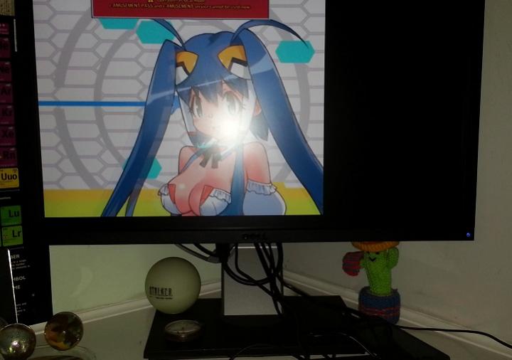

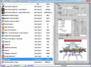

Trnzaddict Posted October 3, 2013 Posted October 3, 2013 If anyone ever finds a way to be able to change Otomedius's resolution from 1280x720 please post about it. I am......Machine
Deadly Posted October 3, 2013 Posted October 3, 2013 Well I'll be damned. The original AH30.exe I had must have been corrupted. The new AH30.exe getting loaded with xb_loader was indeed the ticket! I about shit when not only did it load, the game was full screen AND all the damn buttons worked. And then I dropped a trail of poo when it exited with ESC and the resolution returned to normal. UNBELIEVEABLE! Gigapig and Leolang777 thanks guys I sincerely appreciate being able to cross this prick off my list.
gigapig Posted October 3, 2013 Posted October 3, 2013 Well done Deadly. The feeling of elation and relief. Constipation can be awful. It's fun getting Otomedius workng and well worth it. You may need a mouse or trackball in game to click on menus. Not sure if there is a key to get over that. @Trnzaddict. Don't know how you are with command line stuff (I have no clue) you could try this Sounds like it might force a game into submission. You could add it to prelaunch. Also, I've had a dig around and found if you open "settings.arc" in Notepad++ in the Otomedius folder there are resolution settings in there. Whether they are relavent, I don't know. I will have a play around if I have time.

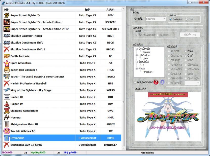

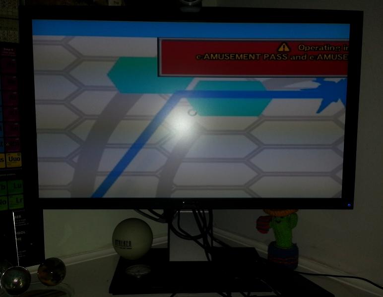

gigapig Posted October 3, 2013 Posted October 3, 2013 You can change the resolutions by running it through ArcadePCLoader.This also gets rid of the 'green square' thats visible in SFIV by changing the resolution to 1280 x 720 J Not sure if this is the same for APCL V1.4, but for version 1.4+ that option is greyed out. The only way to change it is to edit the setting.arc file. Here I've set it to 1920x1080 and also changed this line. ForceDisplaySize=1 Gives me this mess And setting it to 640x480 I get this as its not the native res.
Trnzaddict Posted October 5, 2013 Posted October 5, 2013 Not sure if this is the same for APCL V1.4, but for version 1.4+ that option is greyed out.[ATTACH=CONFIG]33040[/ATTACH] The only way to change it is to edit the setting.arc file. Here I've set it to 1920x1080 and also changed this line. ForceDisplaySize=1 Gives me this mess [ATTACH=CONFIG]33041[/ATTACH] And setting it to 640x480 I get this as its not the native res. [ATTACH=CONFIG]33042[/ATTACH] Shit...yea that's the res I was looking to run it on. My hardware SLG does not do good things to 720p....darkens the screen tremendously because the lines are so thin. If I could get this game to run in 640x480 Id add this back to my cab but I refuse to reach into my keyboard drawer to switch off my slg when selecting this game. Takes away from the seamless experience. I am......Machine

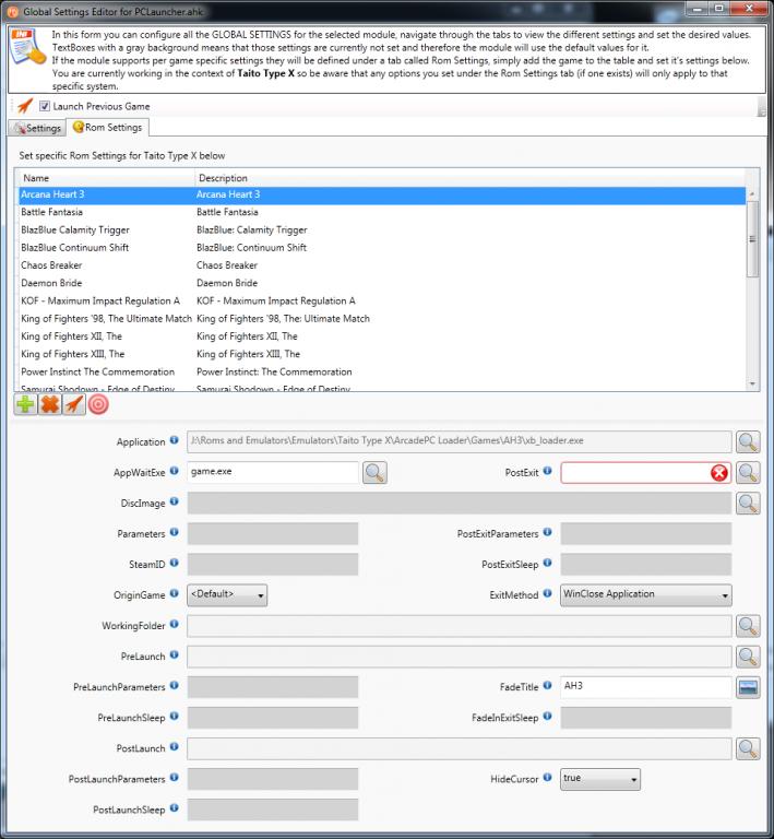

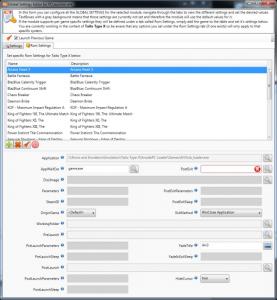

TechnoFreek Posted October 19, 2013 Posted October 19, 2013 Hi guys. I am just starting out to set up type x under RocketLauncher. Have the wheels and rom from before. Going by previous threads I first set up PCLauncer under global. Then select Type X from the left, edit global settings. But everything is greyed out! What am I doing wrong?
gigapig Posted October 20, 2013 Posted October 20, 2013 Aaahhh, I see my avatar in your pic. Thats because your not seeing the whole picture. The top window in your pic, you need to either snap in to the left or right or make it full screen; then all will be revealed. You will now see the green + button which will allow you to add your games if you have a TTX xml.
gigapig Posted October 20, 2013 Posted October 20, 2013 Insert deeply embarassed emoticon here! You have nothing to be embarrassed about, that is so easily missed and if you had no one to ask for help would drive you nuts. but what a relief when you find it. Let us know if setting up TTX was plain sailing for you, or just the beginning of another nightmare.
TechnoFreek Posted October 20, 2013 Posted October 20, 2013 Cheers dude. So from what I gather the settings for each game that I have to make are Application Appwaitexe Fadetitle Exitmethod ? Do I just put in the name under fadetitle or do i have to run windowgrabber etc?
gigapig Posted October 20, 2013 Posted October 20, 2013 You could probably leave the Exitmethod until you get a problem. Appwaitexe is usually game.exe apart from KOF Ultimae match which is game_boss.exe if you adding Contra it's AMContra_full.exe and Otomedius is otomedius.exe Fadetitles are here.
TechnoFreek Posted October 20, 2013 Posted October 20, 2013 Cheers dude. So just type in the fade title into hyperlaunch hq? Last stupid question for now. By adding each game in hyperlaunchhq as above does this create the necessary files in the modules folder or is that a separate exercise? Or perhaps not needed at all?
gigapig Posted October 20, 2013 Posted October 20, 2013 Yes just copy and paste that into the fadetitle box that will add it to the PCLauncher.ini. That goes for the rest of the added info. You can add it directly to the ini if you feel comfortable doing so, but there really is no need. Perhaps should have a look at it just so you no whats happening. use Notepad++
